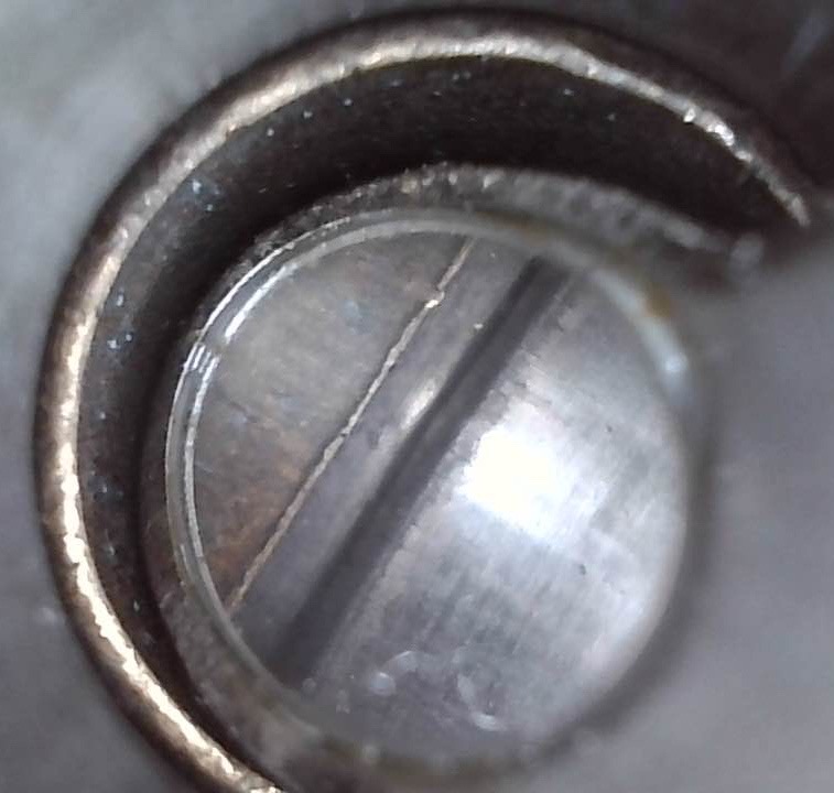

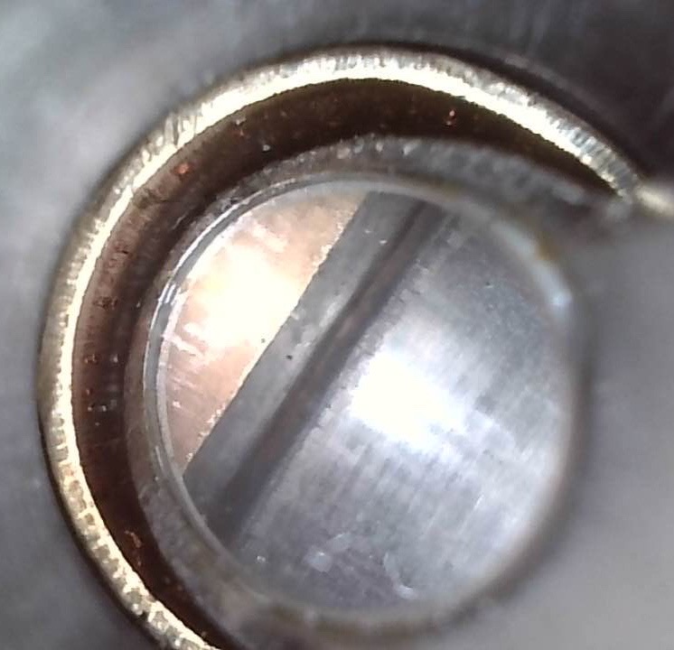

If the case mouth isnt chamfered/deburred the inside edge of fired brass will have a burr on it. Even new brass has some edge, attached is Alpha 6BRA brass.
Using flat base bullets will give varying seating pressure that you can feel in the press handle.
Others have mentioned annealing, when you can feel the brass requiring more effort to draw the expander ball out of the neck, then its probably already time to be annealing.
I dont love neck sizing only, bushing dies are good but they dont remove that inside edge, mandrels work but that is another step. Some dies like SAC let you have bushings and mandrels at the same time but thats expensive.
A good rcbs FL die with a bit a rcbs lube or imperial lube on the expander ball will work and a touch with the internal chamfer tool should get you seating pressures much more consistent.
