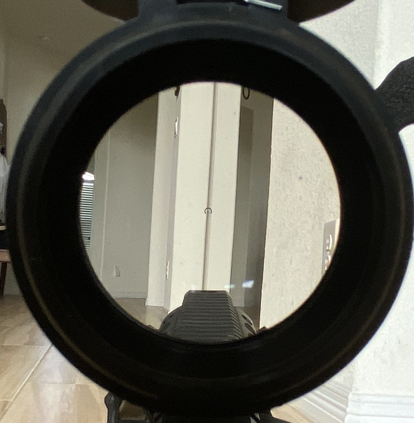

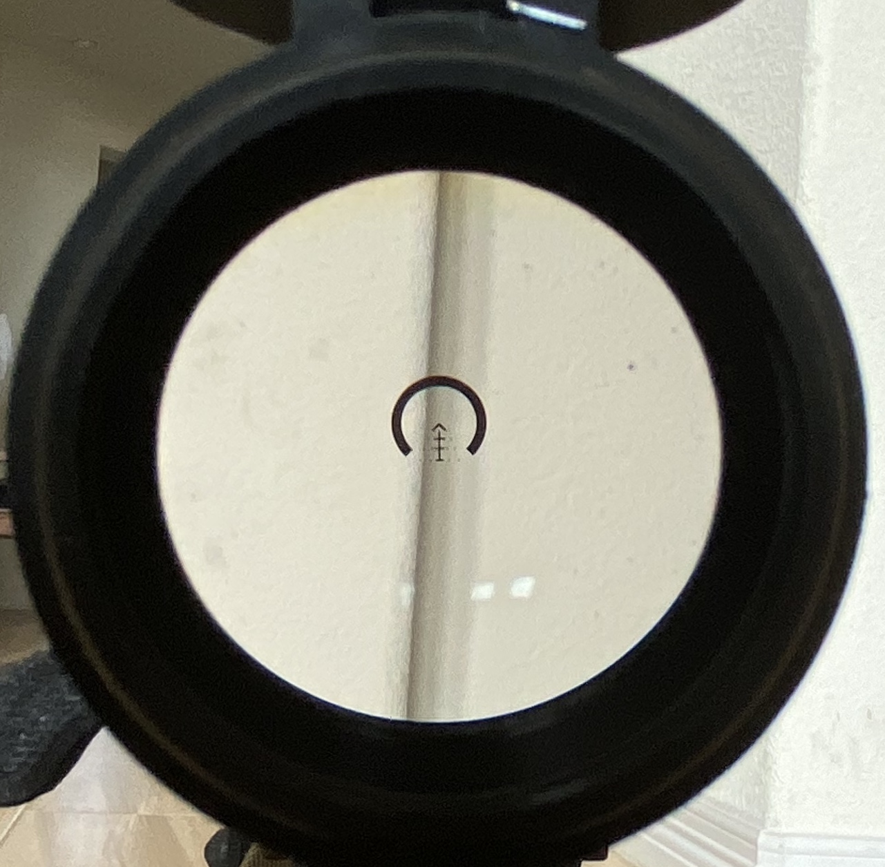

There are tons of opinions on the subject. One thing to remember is that reticles can be tailored to fit a magnification range. The reticle that is in my FFP 5-25 is not well suited to a FFP 1-6. Out to 300, I would be looking at a FFP lpvo; 1-6, 1-8, or 1-10 would all be good. And, they will have reticles designed to work well, within the confines of their magnification range.
1x ACSS
6xACSS

2nd focal plane is my first choice for a hunting scope as well. I have killed many with FFP scopes as well but illumination is a must on them. When dialing down in power to let light in, the relticles get tiny and can disappear. Illumination fixes that.
@kenner have you looked at the NF NX8 line in second focal plane? The Mil-CF2 reticle looks nice and better to me then the Mil-R. I would love to see some pictures through a SFP NF NX8 2.5-20 or the 4-32.
1x ACSS
6xACSS

I recently went with the Vortex HD LHT 3-15x SFP scope for my hunting rifle. My thinking was that if I'm under 15x, I probably have a close enough shot that I don't really care about wind holds/mil scale, and would rather see the reticle at full thickness. For 200yd or less I don't need to worry about subtensions. For 300-600yd shots, 15x is not bad for the top end, and I can hold wind or whatever as normal.
My experience with 2.5-20x, 3-18x, 1-8x, 1-10x, etc.. FFP scopes is that the reticle is either stupid thick at the top end, or near uselessly thin below 6x. YMMV.
