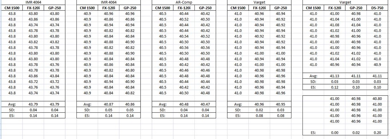

Here's a comparison I recently did to see how accurate my ChargeMater is along with my other "cheap" scales (GemPro-250 and Frankford Arsenal DS-750) comparing them to the very accurate FX-120i:
