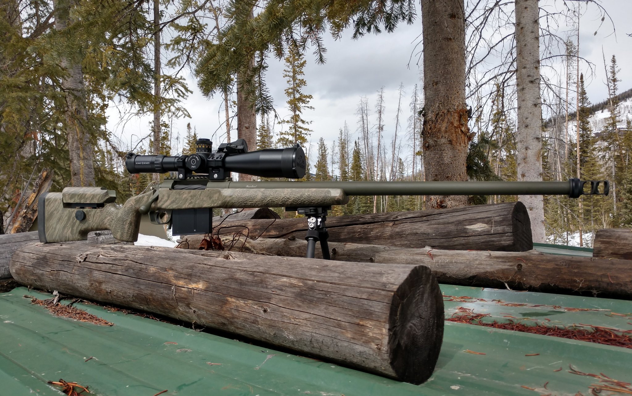

    Rifle pictured is a custom 30 Nosler built to my spec by Jon Beanland. He also built the same rifle as this in 338LM for me previously. I shoot the 30 Nosler more, and it outperforms the 338LM in distance and accuracy, with less powder and recoil.
