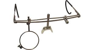

I use rangers because you can adjust the nose piece up or down to keep the center section of the lenses inline with your eye and they come with easy to change lenses in many different colors.
Ranger Glasses
Reactions: Baron23
You can find a good optometrist (a shooter) and optical shop that will put the visual center of your spectacle lens wherever you want.
The Army Reserve and Virginia Team were blessed for many years with LTC Alan Toler as one if their shooters. He'd have you bring your long gun or pistol to the practice, look to see where you looked through irons or scope, and adjust scrip, glasses, and frames specifically for your shooting discipline.
These are extreme:
