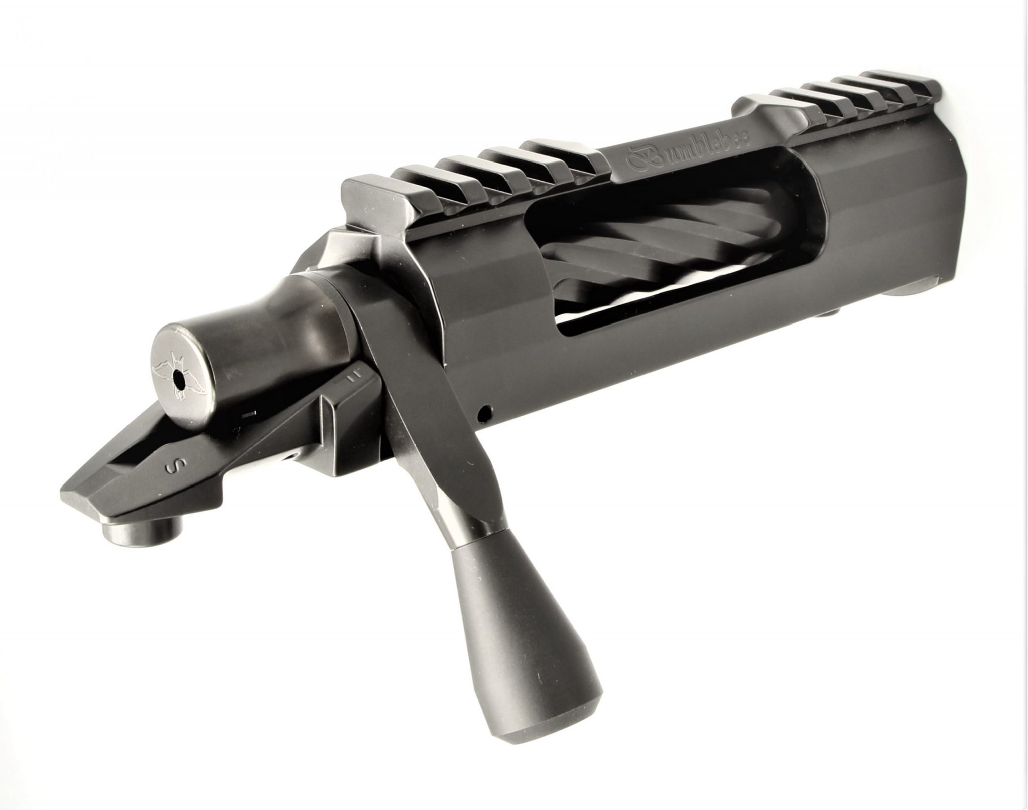

So long story short, need some super tall 30mm rings. Mounting a Nf nx8 2.5-20x50 on a bat bumblebee. Action doesn't have a full pic rail due to its light weight design, it's interrupted, taking away higher unimounts. The action is in a xlr element 4.0 chassis. I have the xlr mlok NV bridge. Problem is the bridge sits very high. Mounting my clip ir-lr thermal puts it way up for colinier alignment with the day scope. Highest quality low profile rings I can find are 1.5" tall. I am going to look into machining the xlr NV bridge and pic rail for lower rail height.
This is the bumblebee action, I don't know if a pic riser rail will work. The existing pic rail is integral.

I've found 1.7" swamp fox rings, older 1.6" xtr Burris rings. Swampfox quality is chicom unknown, the xtr are 6 screw and will hinder adjustability on the ultra short nx8 2.5-20x50. I'm a boszie bitch and being picky I know.

You may want to reach out to Badger Ordnance. They are great folks and may be willing to make you a set of rings at 1.70". They make a COM mount at 1.70" but it's cantilevered.

You did look at the pic of the action....right ?
Cantilever won't work with the open space in the pic rail.
A quarter inch shouldn't make a difference with a clip-on. Anyway, have you considered something like a one piece mount?
I've got some unimounts, going to see how they fit on the action. I'd like to keep it simple with 1.5" rings. Going to machine the NV bridge and try a low pro pic rail to get things lined up better.
