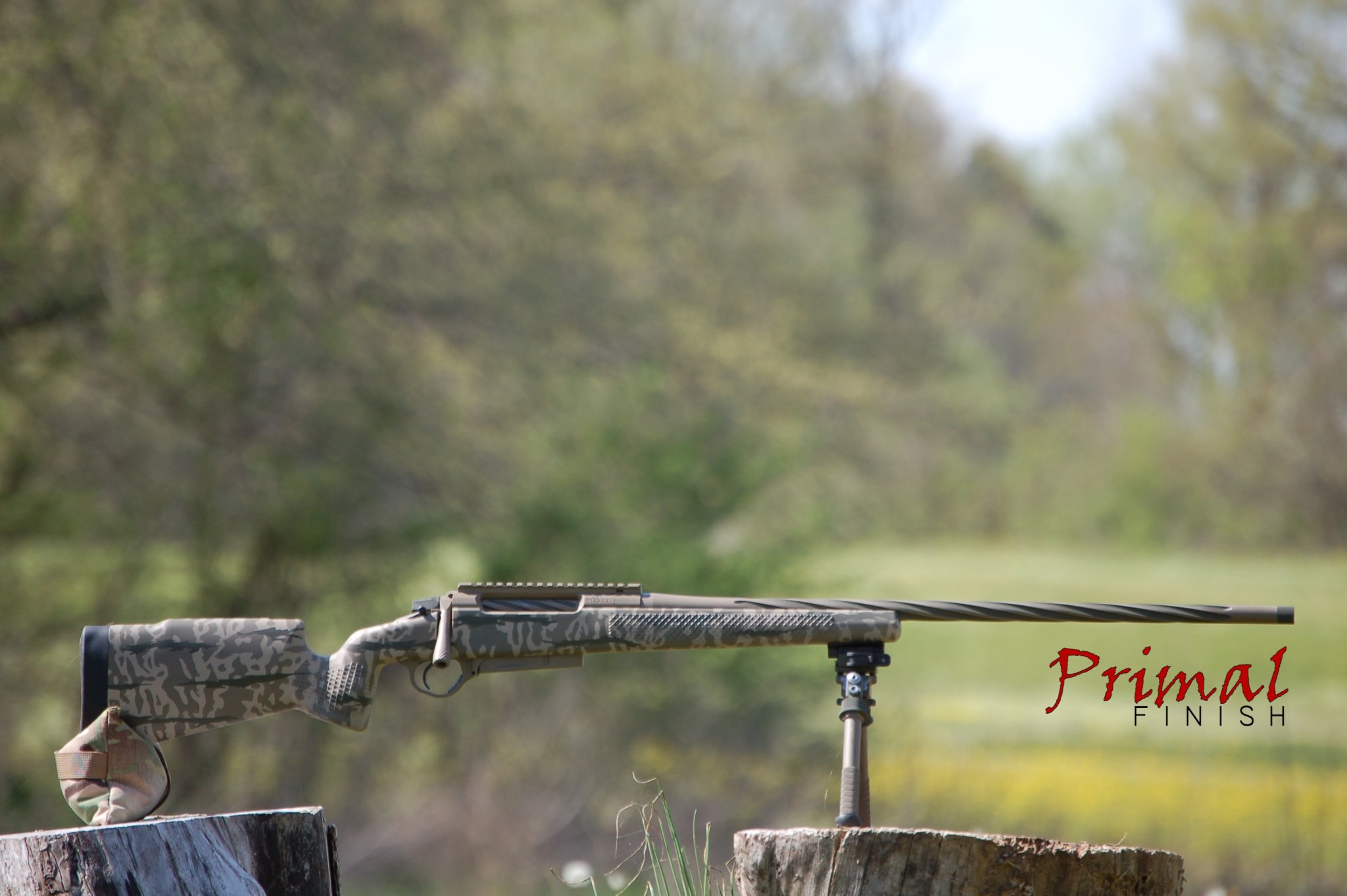

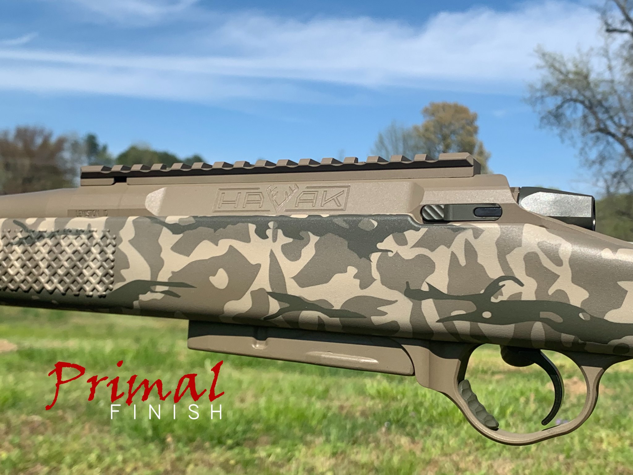

I have a 300 prc PH2 love the rifle. 1/2 MOA with Hornady ELD-X. Only gripe was the looks of it. $350 and seekins cerakoted the barreled action and painted the stock.
Can you post a pic?

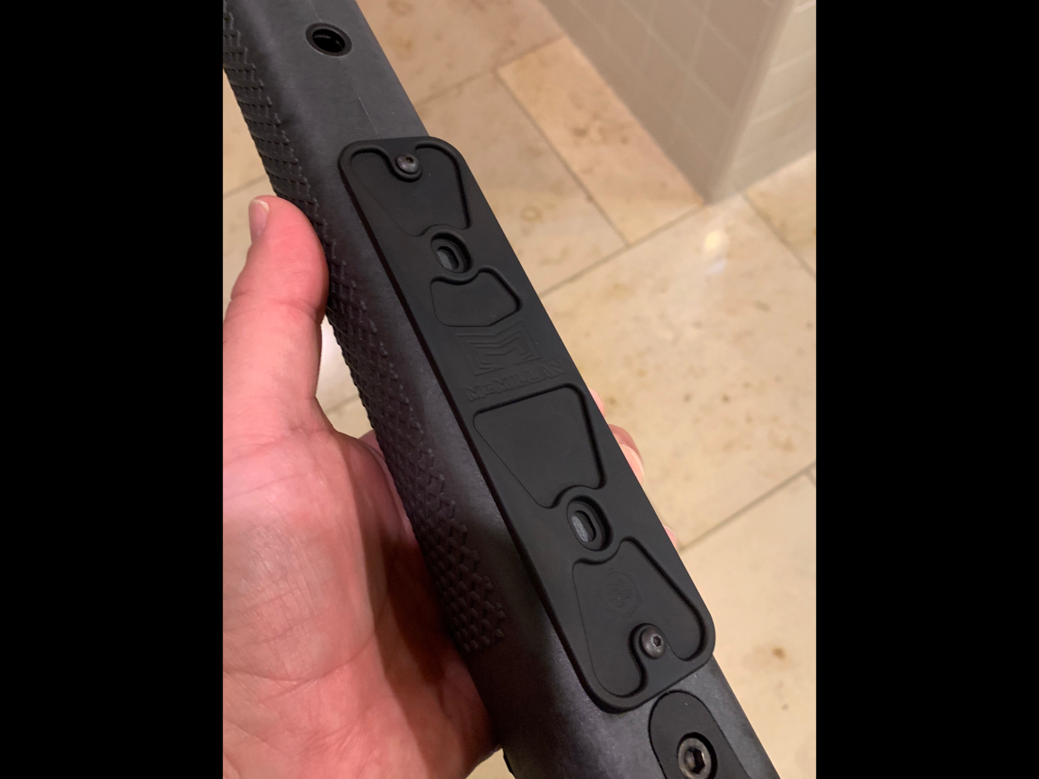

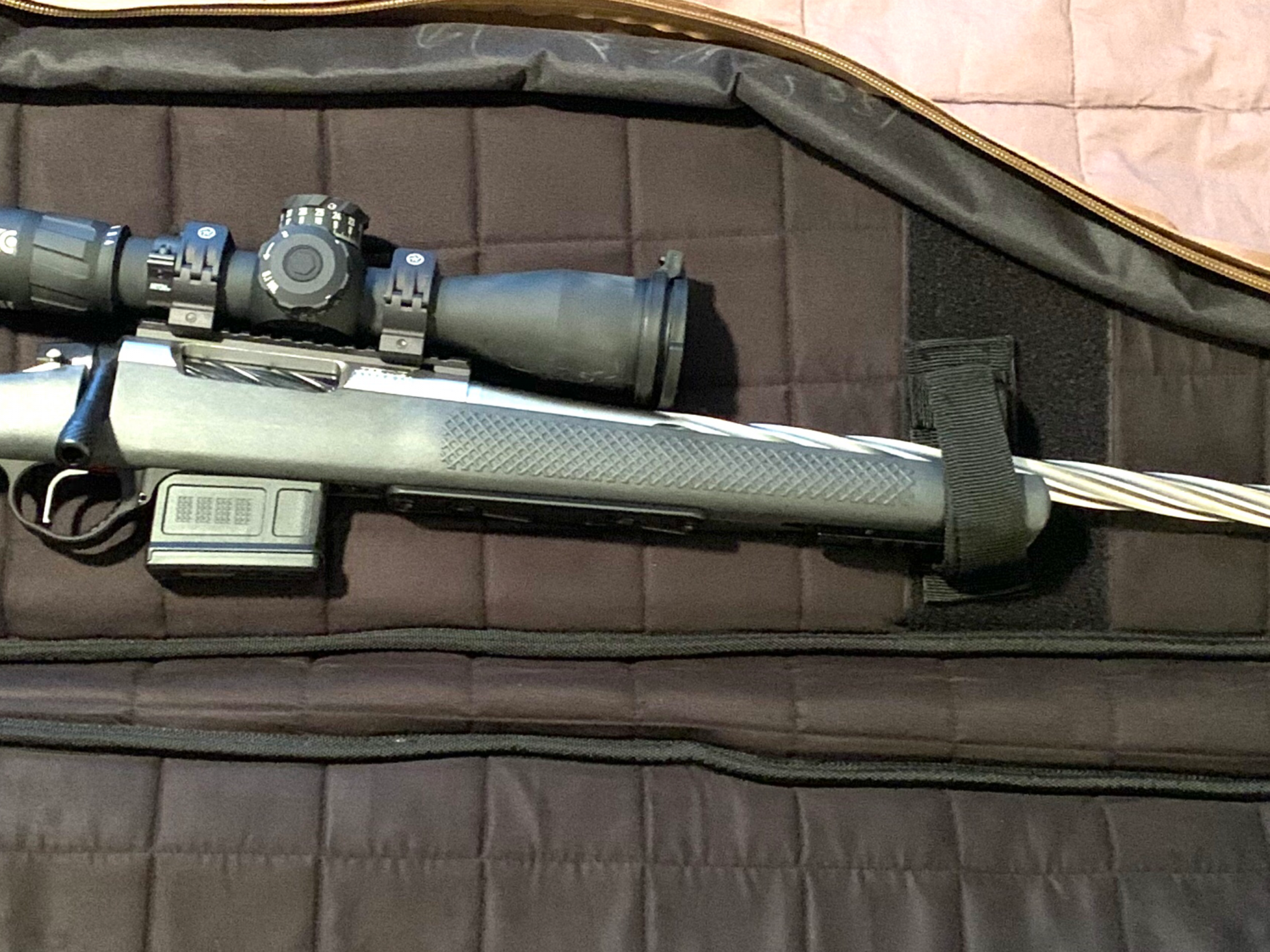

Replaced the sling swivel stud with a short picatinny rail and added a six inch McMillan ARCA rail just forward of the magazine.

Mind posting pics of the picatinny rail and ARCA set up?

The Seekins custom shop can cerakote the barreled action for you before shipping. Little more durable than a rattle can job.

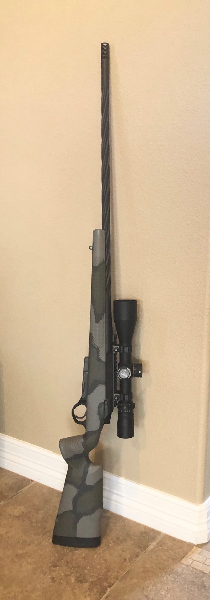

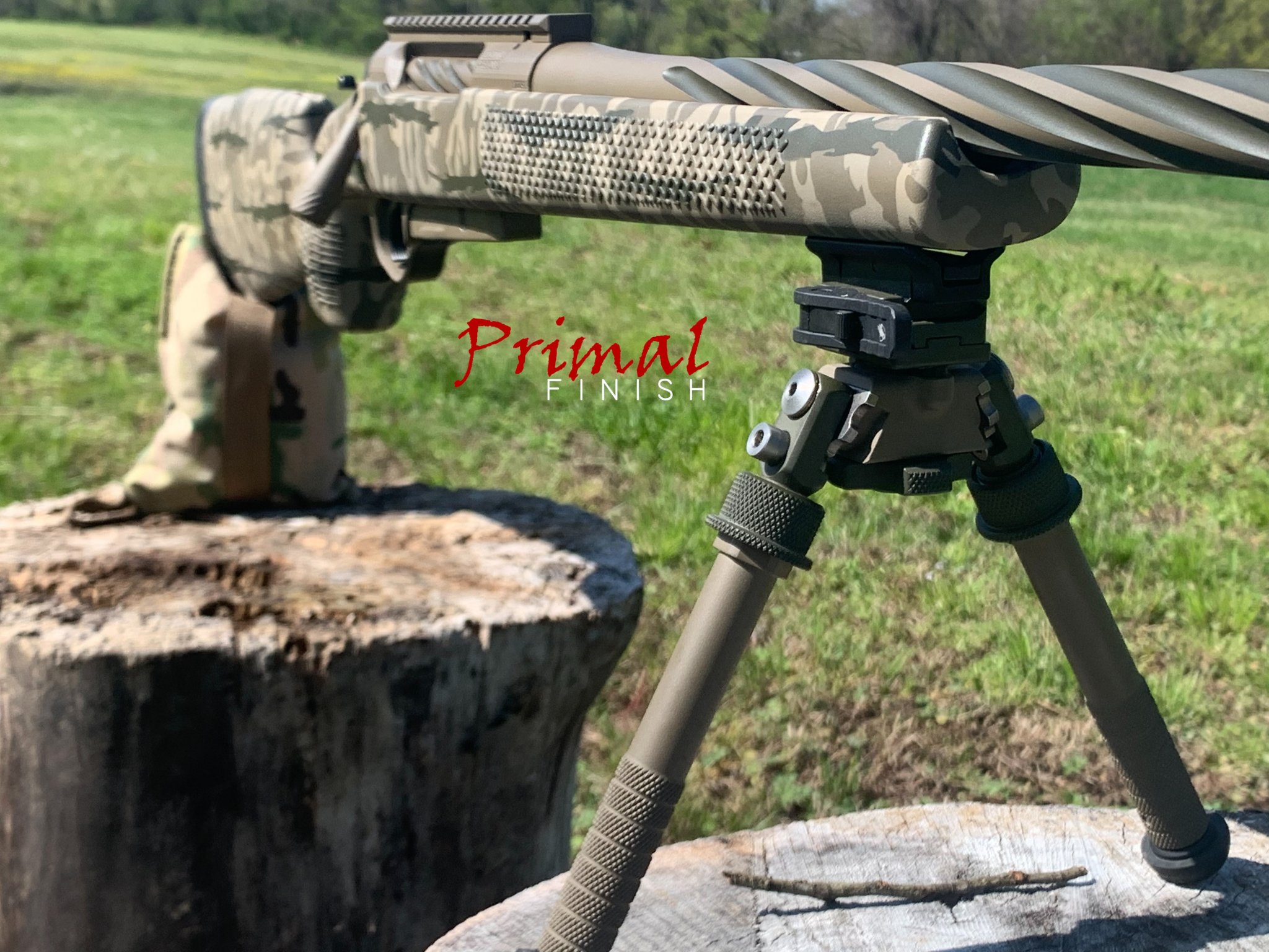

I just got my PH2 in 300 PRC back from being Cerakoted. As you can see in the pics I had the bolt Cerakoted and it was pretty sticky, but after cycling a couple hundred times it’s has smoothed out nicely. Is it As smooth as an Impact or Surgeon action, no, but for the price point it’s just fine. The trigger breaks crisp and clean and I really like the palm swell their new stock offers. The only complaint so far is I’m running an MK5 3-18 with low ARC rings and I had to add a Triad stock pack to get a proper cheek weld and sometimes the bolt would not pick up the third round in the mag. The bedding job is pretty impressive as well as having a lug built in and over size screws on the top pic rail. I have just begun load work and have just ran 20 rounds of mild handloads to just settle the bore. The last 3 shots were a 3/8” group before those it shot consistently at 1/2”, so pretty pleased with accuracy so far. Next I’m running a 30 round pressure test then start load development from there. I’ll report back once I dial it in.
So far I am impressed with the PH2 and find it a great buy for an all around hunting rifle.

That is a great group. Fantastic looking cerakote job too!
