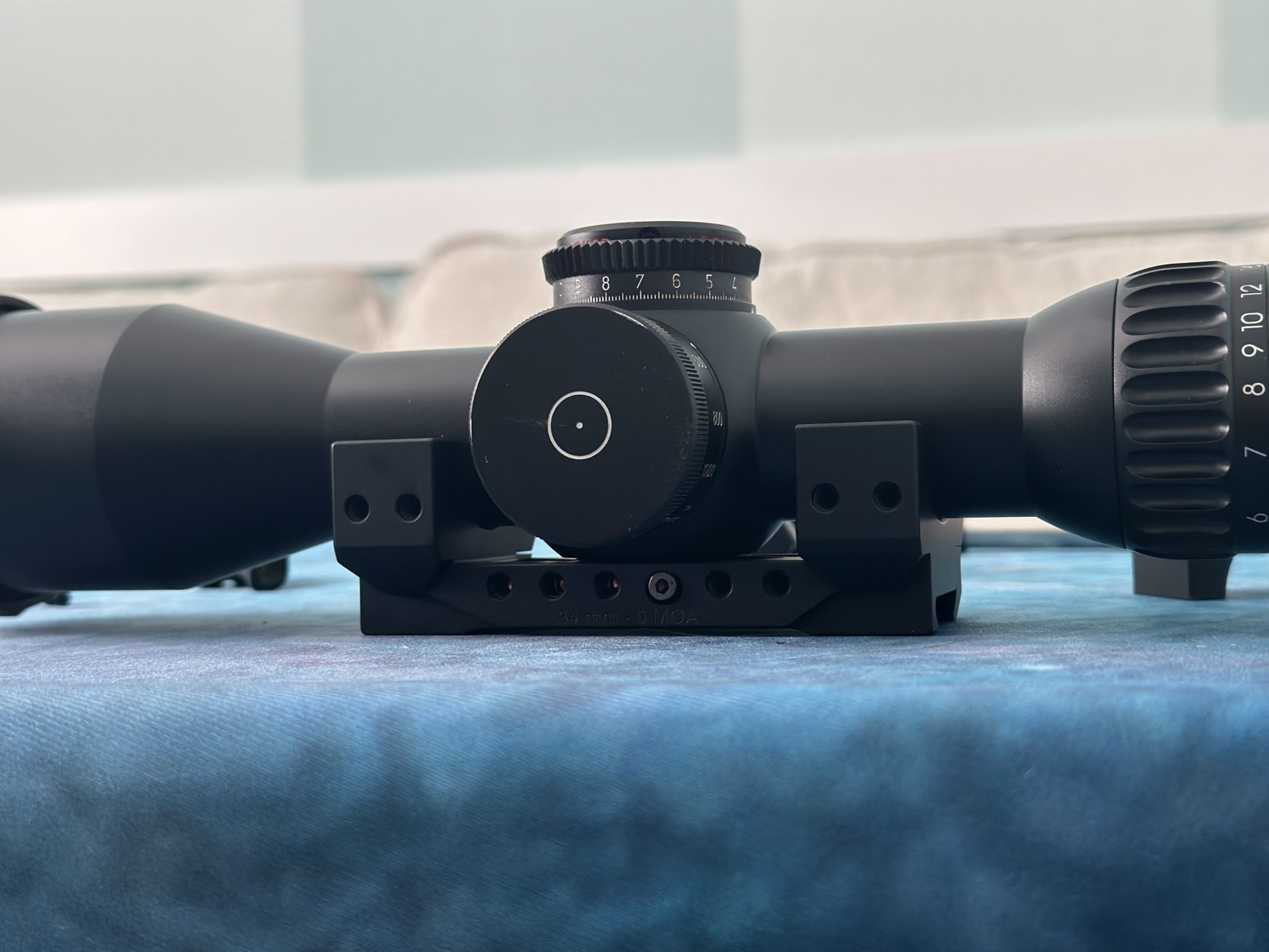

    Just got back from SHOT SHOW and Glen Seekins had the new mounts there, with new accessories.
    The "Key" to this mount is the wedge Glen has added to it underneath. This locks the mount to the rail,
    The screw at the bottom is the locking mechanism for the wedge. It's so effective that you can tighten the side clamps to 10 inch pounds or even potentially less and it will still hold.
    The other neat and well thought out part, the Level, you know me and a level, my thoughts are, if you run a level you better manage it.
    Well the two screws next to the level are to adjust it so it's right because you can't just slap a level on and expect it to be correct, some times they need an adjustment, Well Adjustment included.
    Looking forward to try this out, and putting it through the paces.

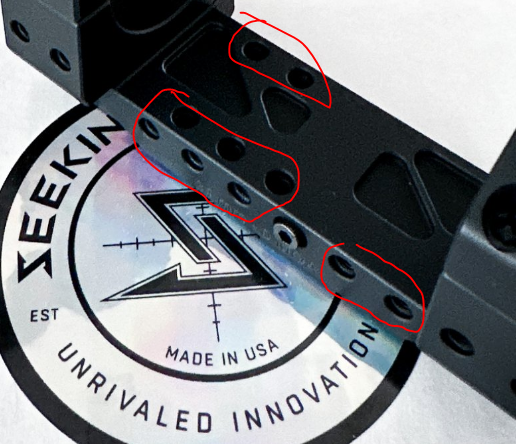

    The ring caps are also backward compatible with the Vortex or previous Seekins Rings
    That looks great! Glen always has some great products. Will have to pick one up when they are available.
    I wish the rear upper ring half was the same as the front ring. I had to mount my low pro bubble level behind the turrets (closer to my eye) because my S&B's parallax knob is huge but so far so good though!
    Just move it to the rear. Well you could unless you needed that big unicorn horn on the front. LOL
    Reactions: Holliday
    My guess would be attachment points for offset or pic rails, dope cards, levels, timers, etc.
    100%.
    If you look at the level, the part where it mounts to the top of the ring has a nice radius, as if to fit under a scope tube……
    Spin the mount so your level is in the back and use the top cap on the front for your diving board.
    And the bolt that holds the level for “tuning” as Frank said, will allow for movement there, or probably even the holes on the side of the mount between rings.
    Just guesses and looks that way from a quick look.

    you guys are not smart at all, and should please just stop with the lower. Lower is bad, lower rolls your head, lower compromises every position except offhand, lower is fucking stupid
    This is 1.18" mount and it's supposed to be one of the most popular heights, this is how dumb the end users are,
    They don't fit, the saddles are too big so you can't mount the scope. If you are less than a 1/4" from your barrel with your bell odds are you bent your tube, or compromised the scope. Lower is not better and does not work.
    For our modern shooting and rifles we should be 1.3" at the lowest point, and higher is better fundamentally. Stop asking these guys to make low. Lower is an old wives tale that needs to be retired
    Because we have been removing scopes and testing them in class, we see it compromises the tubes on recoil when the bells hit the rails
    We had a student, super low NF, about 1/8" off the rail, tested the new scope worked, next year did it again, off, and looking it we can see the bow in the tube.
    You all think you are smart, but whatever ignore solid advice
    Reactions: Milf Dots and BurtG

    while those are ELR guns, the point of this should be, look at our cheek heights today
    in most cases you struggle to lower the cheek because the scopes are too low, but we have close to 4" of height we can take advantage of which in turn keeps your head straight and your eyes aligned better.
    ELR aside, raising the scope to a COMFORTABLE height has far more positive benefits then the idiots here want to make fun of
    When the scope is too low you only have two options, cant your head into the rifle or cant the rifle into you. Neither of those are good options.
    You don't get it though, with extra elevation like we have, the saddles are bigger so the scopes won't fit in the rings.
    Adding can't in a lower mount, it won't work as well, they need to adjust the front from the back, you have no room to work
    Its a mechanical thing, the majority of scopes today won't fit just like I posted, We added more elevation today that means we need a bit more room.
    You can see the gap, and this scope is not big, it's an ultra short. The lowest in 2023 should be around 1.24"
