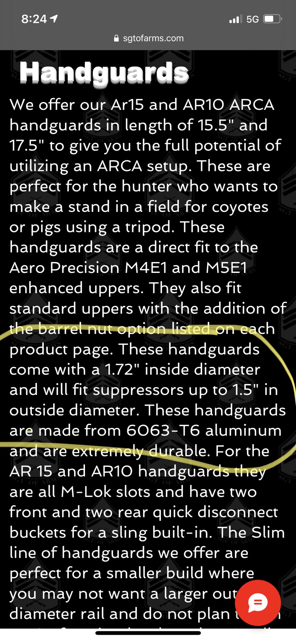

    So that aero clears an OCM/aem5 can internally?
    That’s a sgt of arms with arca but yes. I think the round aero fits even more I’ve got one laying around here somewhere
    I had a 1.75 OD suppressor inside the aero quantum set. I’m pretty sure they are fairly close dimensionally.
