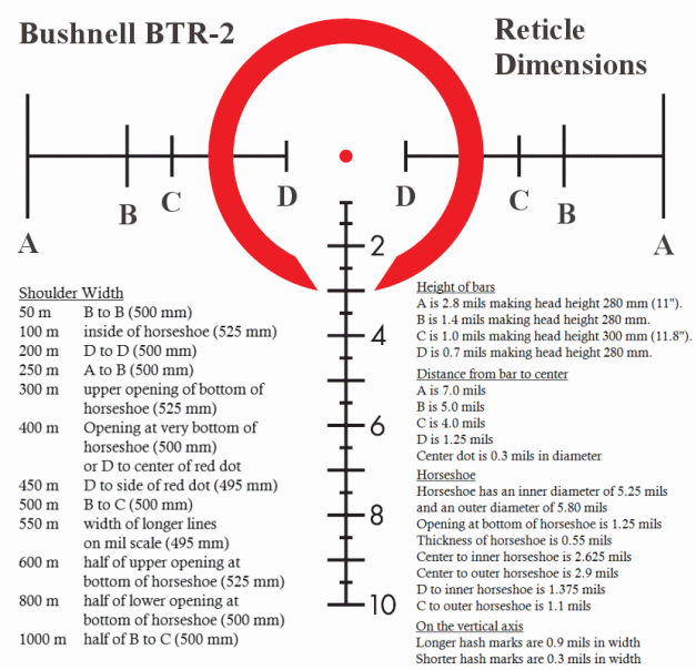

I just ordered 2 of the Bushnell Elites Doug has on sale. This is the reticle breakdown. While a straight mil based windage would have suited me better, the use of this scope as a DMR type means it wont be dialed much if at all.
The mil based elevation stadia is easy and the windage will still be just a ruler in front of your eyes....if not a perfect one. They are made by LOW I was told so they should be good optics.

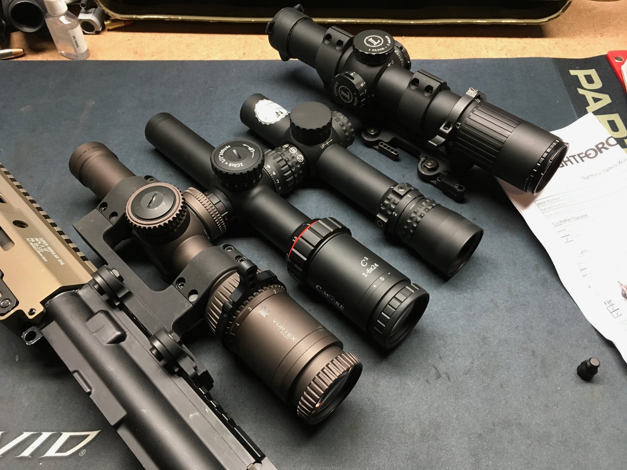

I have only had a few of them at the same time (Kahles not pictured). My preference of those I owned was:
Kahles k16- Excellent all-around, less durable than razor and probably NF. Bent the diopter on one by accident, but did not affect function. Reticle options are OK. SM1 is not going to be daylight-bright.
C More 1-6- Surprisingly good. Close optically to razor and in weight to Razor Gen II-E. Reticle is fast from 5-800 yards. Great scope aside from the cheesy turrets.
Razor 1-6- Excellent optically, had one reticle fiber delaminate, but very durable. Very heavy and the zoom ring is far stiffer than it needs to be, even after the update.
Leupold Mk6- Weight is excellent but tubes are the thinnest I have ever seen. Reticle illumination appears to flicker as you move your eye around the visible 'eye box'
NF NX8- Really wanted to like this. It does being small and having bright illumination very well, but not much else.
