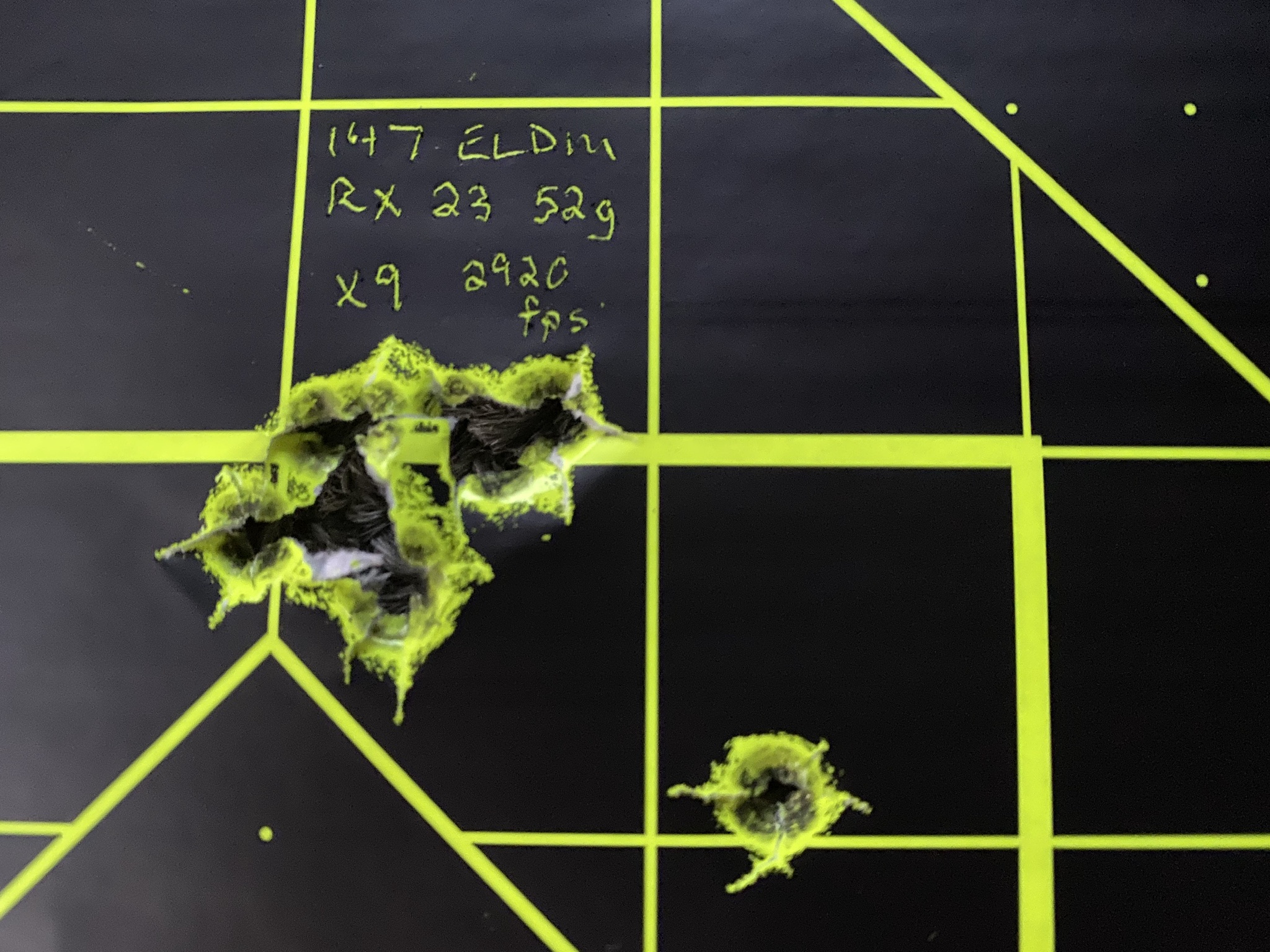

I returned a CA MPR 6.5 PRC because the folding stock had about 1mm play in it. They paid shipping and had it returned in 2 weeks with a new stock, Carbon barrel and bolt because they said it didn’t meet their accuracy standards. I didn’t ask for any of that they just took it upon their self to show good integrity. I was shooting sub MOA with factory ammo and hand loads. Barrel had about 500-600 rds through it. I realize this is anecdotal but it was my experience.
