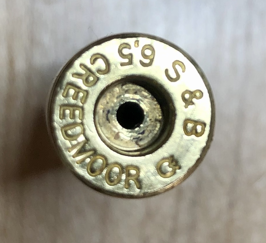

Picked up some range brass and it had the S&B logo on the head. Was not aware they started making 6.5 Creedmoor ammo, but i guess with the panic buying going on right now, all ammo producers can make a lot of money exporting to the USA.

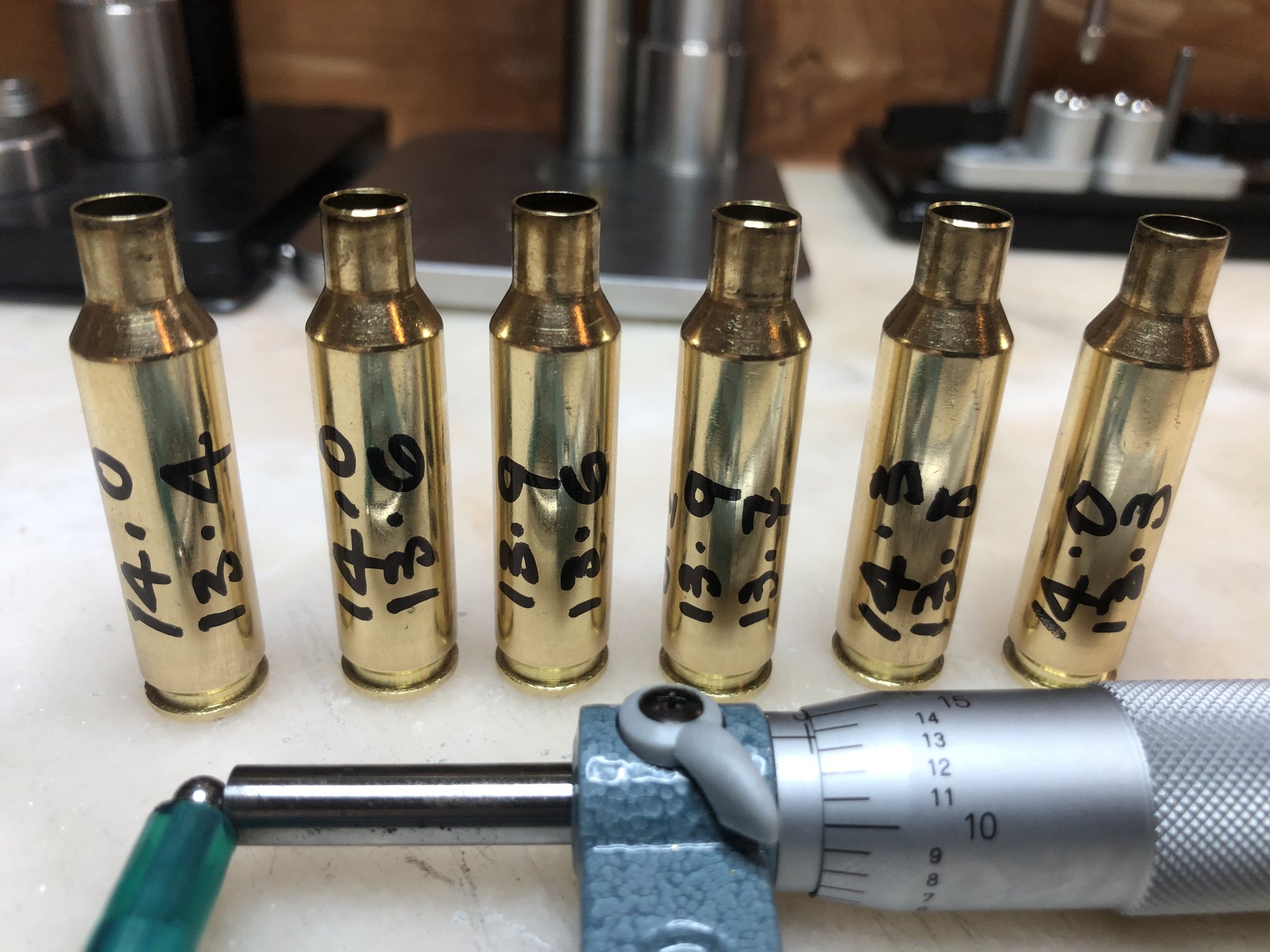

Measured the 6 cases i got: Neck thickness variation was between 0.2 thou and 0.9 thou, average of 0.4. Which is on par or possibly better than Lapua. Necks are not overly thick, between 13.2 and 14.1 thou, average is probably 13.5 thou. So bo need to do neck turning. The carbon deposits on the necks has the desirable sine wave pattern... which

I checked the weight range and for the 6 cases i had on hand, it was only 1.4 gn ES. Yes it is a small sample, but still a very good result.
