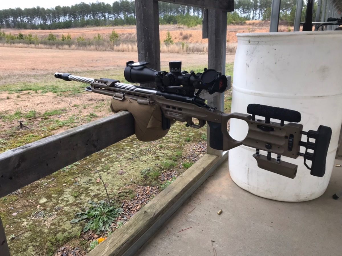

Only thing I would change with the original recommendation is get a PVA Osprey instead of the Proof. You can get it whatever length and contour you want. I got mine with flutes. Pic below of my 26” 6ARC. I have changed the scope and chassis since then but gives you an idea.

Why a mini chassis is a better question? Does nothing for you with the round and limits you to short rounds if you wanted to try something else. Get an Origin and you can have any short action caliber you want with the ease of a bolt head change. You limit yourself massively going with a mini action. That action in the pic I have a .223, .308, 6 Creed and 6.5 Creed barrels I can spin on it.

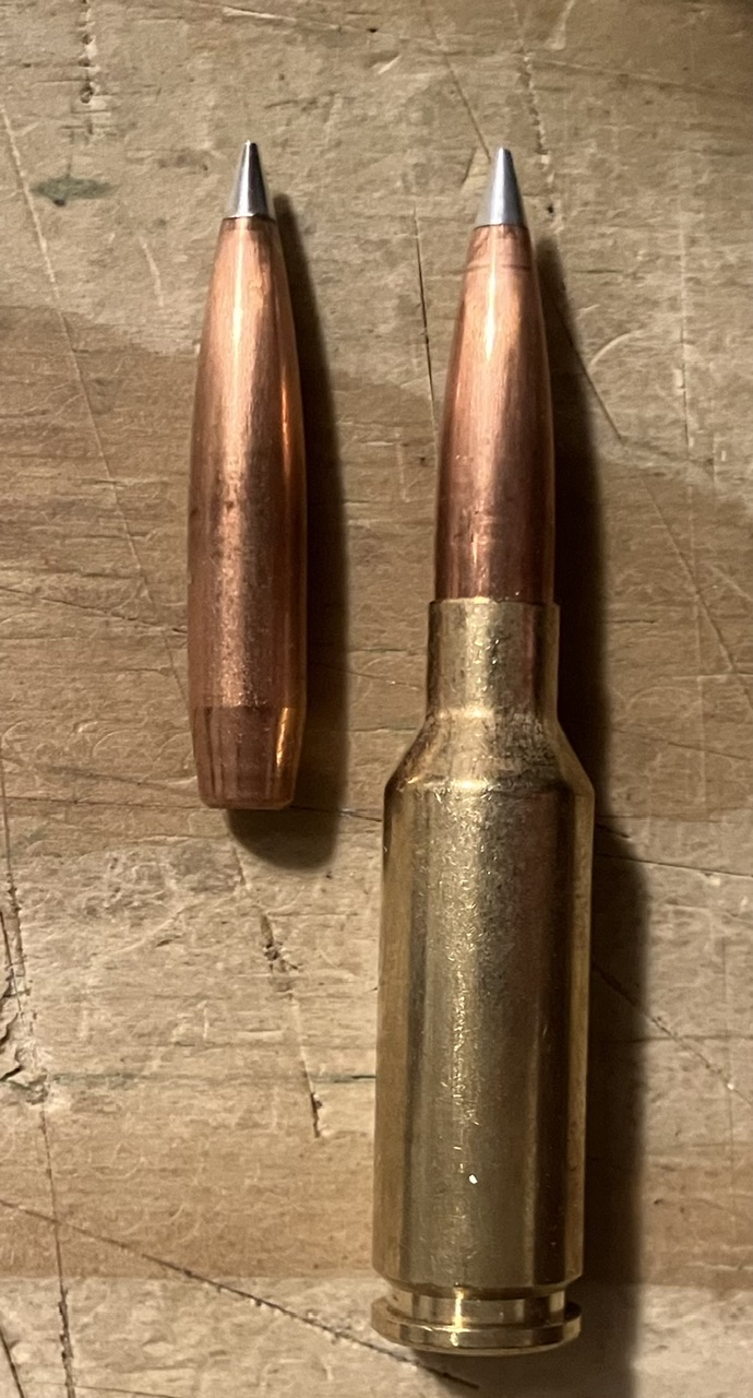

I just have an attachment to the mini action because I owned one previously. But I like the idea of being able to switch to a different cartridge like 6 prc I’m a big 6mm fan so that’s likely where I would go after I get tired of 6 arc. Also question about the 110 atips I know the ogive is a lot longer are you able to seat them out longer without jamming them in a saami chamber or do you have a longer throat? I saw on another 6 arc load data thread that guys running bergers had to get their chambers throated longer so they could load the bullets out longer without eating up case capacity.

No long throat in mine. I have the 110s loaded at 2.355” and again I will have to check but it’s probably in the .020-.030” off lands as that is where I like to stay. Below is a pic of my loaded ammo and a bullet. Doesn’t go too deep into the case.
