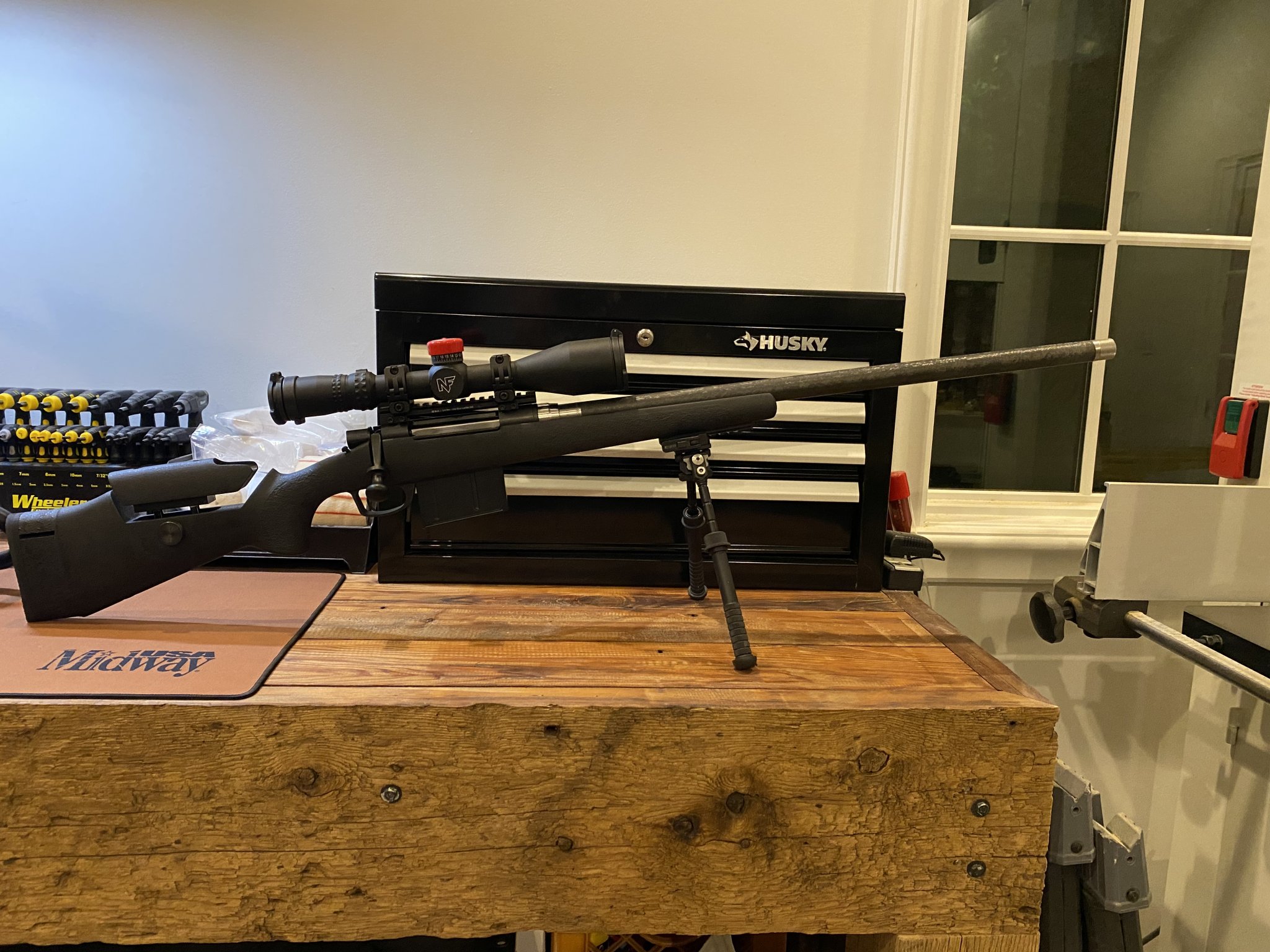

This week I finished building a 300WM for same purposes.
- Mausingfield Opentop LA (i.e., 300WM), 20moa (50mm scope) (45oz) (add ARC receiver wrench)
- Proof Research Sendero Carbon Fiber Savage Prefit 26” barrel, 1:9.4, muzzle thread 5/8-24 (2lbs, 12oz). Debated whether to use 24”.
- NSS Barrel Nut (60-65 ft lbs torque)
- Gen 3 Little Bastard Self Timing Muzzle Brake - 5/8x24 (not yet installed)
- Badger M5 Trigger Guard and Bottom Metal with AICS 5-round mag (hex screws for 700 BDL - 65 in lbs torque)
-McMillan HTG-Remington fiber stock, black, tac-edge fill w/ machined-in pillars w/ LOP spacer system, thumb wheel adj cheek piece, and rear flush mount cup (front mount included on rail), 4” picatinny rail (for Atlas bipod). 4-6 month stated lead time; received in 3 months (basic finish cuts production time). Order last so that you can provide information about all component. Josh was very helpful.
- Atlas bipod
- TriggerTech Rem 700 Special Trigger (no bolt release required)
- NightForce NX8 4-32x50
- ARC M-10 Scope Rings (30mm, 20moa, x-low)
- Belted magnum Go and No-Go Gauges from NSS
Less than an hour to put it all together; very easy. I have not weighed it yet, but it does not feel any heavier than my 7 mm mag Blaser R8 that has the same scope.
