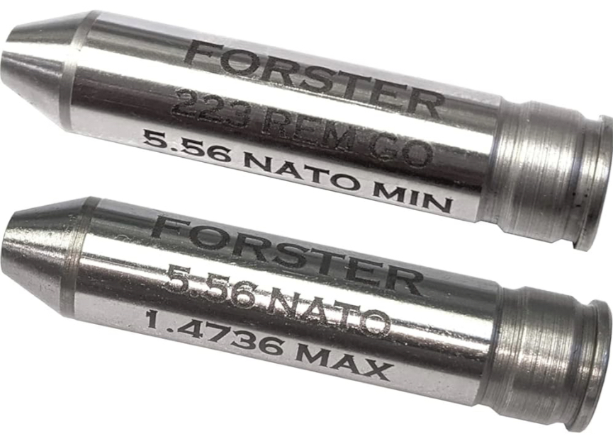

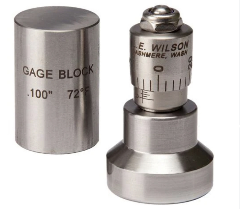

Haven’t really seen much discussion on this topic elsewhere.
In a 5.56x45mm AR, letting the bolt fly loose onto a round can set the shoulders back by as much as 0.004” to 0.005”, depending on the make of brass (Federal GMM and Bulk .223 Remington in those 300 round boxes - they’re soft!).
In effect, if I had insufficiently headspaced brass at, say +0.004”, and release the bolt onto a chamber with headspace measured at +0.001” - the brass (empty OR loaded) will, more often than not, still chamber.
Note: Relative measurements were obtained using Forster Case Gauges and an L. E. Wilson Case Gauge Depth Micrometer. For example, Case Gauge 1.4636 allows the bolt to close with light finger pressure sans ejector. This Case Gauge measures at exactly 0.000” using a Headspace Gauge and the Micrometer pictured above. All sized brass is made to approximate the same headspace of 0.000” +/- 0.002”.
Since I know the exact headspace of my chamber - and that the act of chambering a round also bumps the shoulders fairly effectively - why not FLS and headspace brass to match the chamber’s headspace as close as possible, instead of following the usual recommendation of -0.003” to -0.005” less than that of a fired case (and we know how insufficient those values can be with overgassed rifles)?
At the moment, my brass matches the headspace of my chamber by +/- 0.002”, and I haven’t had any reliability or accuracy issues over the last 420 rounds (this AR is a range toy). I’ll only have to worry about “squishspacing” the oversized 0.002”, not the undersized half.
View attachment 8643895 View attachment 8643896
Since I know the exact headspace of my chamber - and that the act of chabering a round also bups the shoulders fairly effectively - why not FLS and headspace brass to match the chamber’s headspace as close as possible, instead of following the usual recommendation of -0.003” to -0.005” less than that of a fired case (and we know how insufficient those values can be with overgassed rifles)?
Any negatives to this approach?

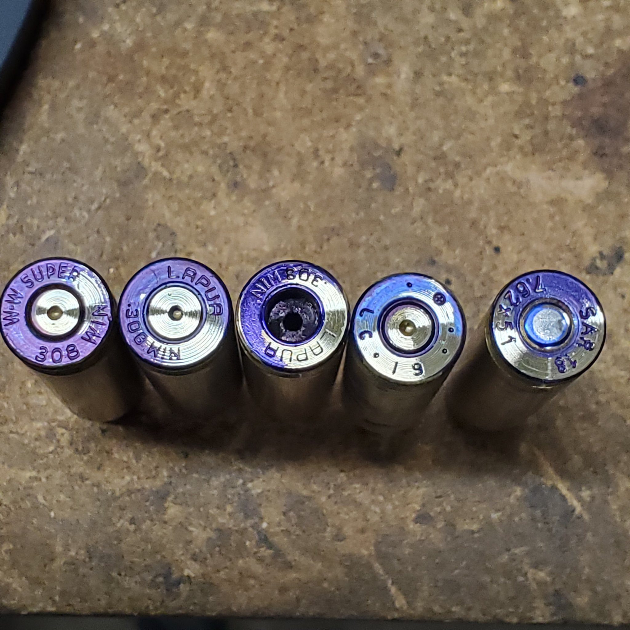

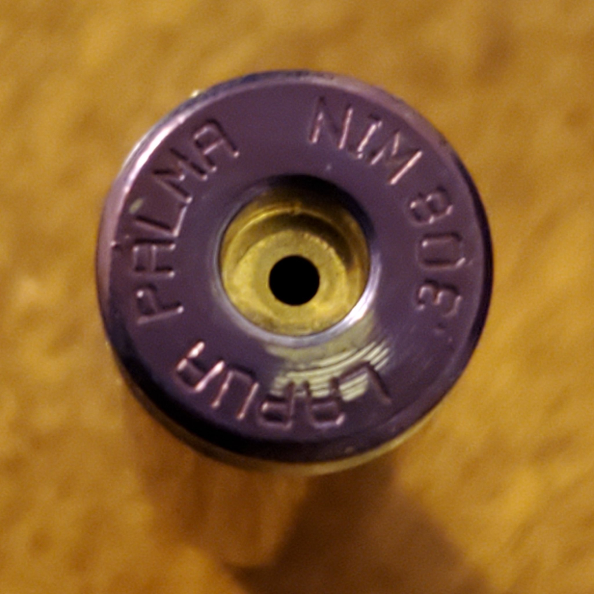

A small part of the measurement error is the variations in the case head....which is not completely flat on any case fired or new ...with any brand.
So thats one area you can not control, and you keep measuring your headspace and it fluctuates a bit, and even seems to change when you index the same case off the high spot and it drops a half thousandth or so...
Even If Annealing Is Done! It does nothing to make the case heads flat.
