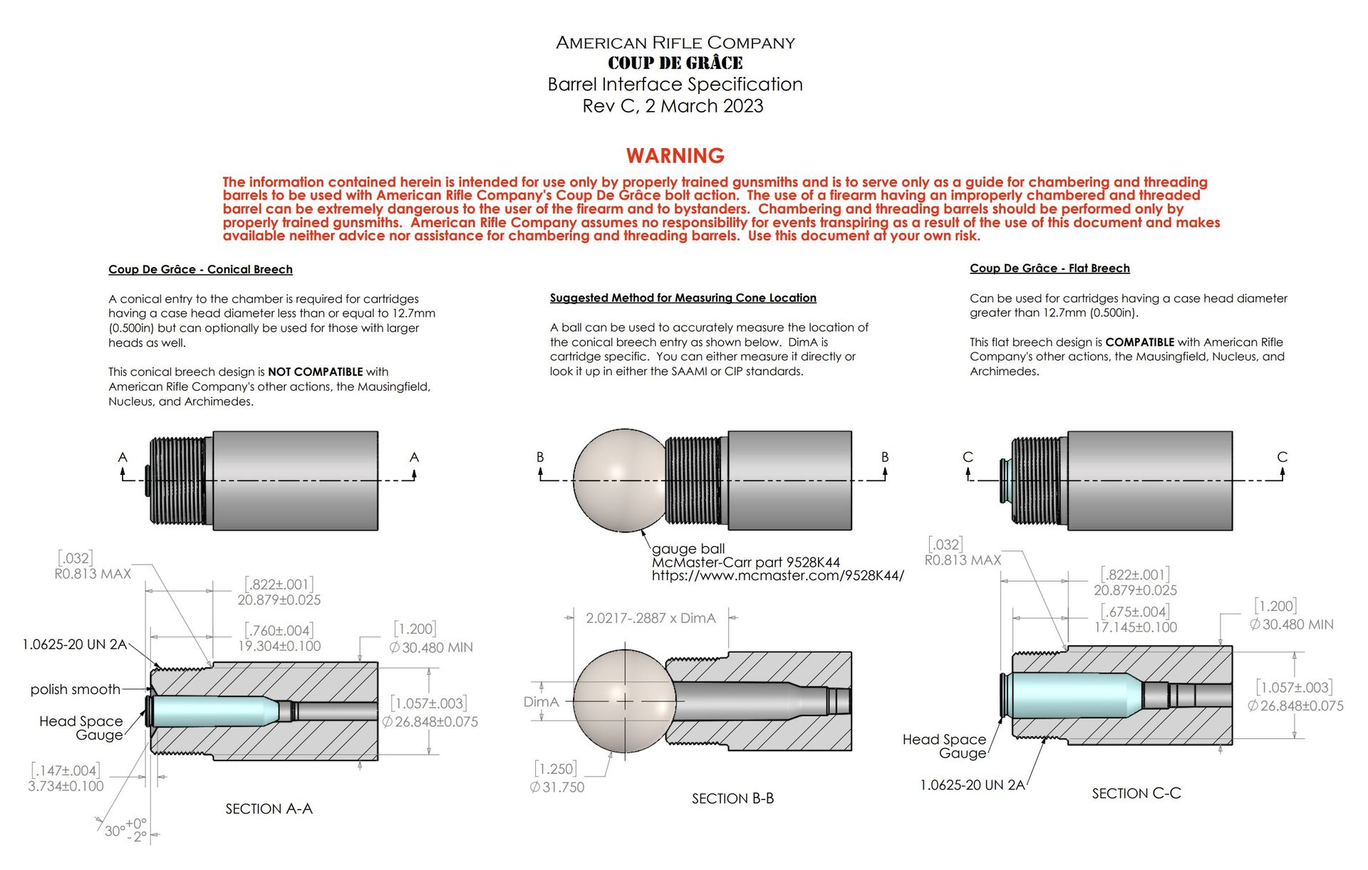

    I/we are not a fan of prefits. Main reason is the actions vary tolerance wise along with the bolt. Even if you have a +/-.002” tolerance on the actions and bolts… you take the barrel the opposite way for headspace (even though it technically is in spec) and the action goes the other way.. I still see stuff having headspace or bolt clearance issues. Which can lead to function or accuracy issues.
    I don’t know of an action/receiver where the threads are timed off hand. So when you screw the barrel on and it’s pre engraved… you don’t know where the engraving is going to time up for you. We’ve done the engraving in two places opposite one another. So it could be upside down… it could be right side up… it could be on the stock line etc…
    I won’t name the action/gun maker as the point is not to bash on anyone but I actually tracked where one in ten fittings there was a fitment issue. When that happens…. All we can tell the customer is to send us everything so we can look at it and correct whatever is wrong. Everyone one of those the barrel was in spec. (I have the factory drawings for the barrel breech spec’s) and it was either the bolt affected headspace or it hit the barrel and wouldn’t close or the barrel didn’t fit the receiver properly. So we always ended up adjusting something.
    When we did barrels for the MSR rifles. They had a +/-.002” tolerance on headspace for example. We did the barrels to spec and had a master bolt and master barrel extension to double check the fit. If anything was off… then the factory had to make the adjustment on they’re end after the barrels where delivered.
    So in the end… I’ll say the bulk of the time you might not have an issue…. Just be prepared if you do have an issue.

    I just had a chance to unbox and examine the Bartlein blank I sent to Chase Fisher to be spun for this CDG prefit and I'm very happy with what I saw.
    Now, I'm no expert but everything looks very good. Nice clean and uniform threads, nice clean muzzle crown, very nice smooth chamber with nothing odd to be seen at the body/shoulder junction, very clean and shiny free bore, and the leade ends very uniformly at the free bore all the way around.
    Of course the proof is when I shoot it but the gunsmithing looks very nice.
    He did tell me that he doesn't usually cut off the coin (engraving from the blank manf), that he will do it but its a bit more work, but perhaps I misunderstood as the coin was indeed shipped back to me in the box with the barrel.
    Chase beat his estimated lead time by quite a bit...from him setting my expectations at 9 weeks then shipping at about 4 weeks. And his price is good and very competitive. All good and I wouldn't hesitate to send him more barrel work in the future.
    In addition, he provided a document with the specs on his work which I find to be very polite and transparent.

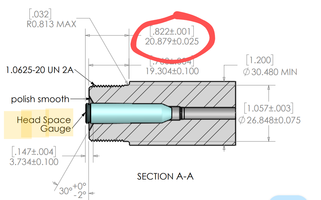

    But, I do have a couple of questions on the document shown below. I know I can call him on Mon, but I'd rather let him do barrels than answer perhaps dumb questions from me that one of you might clear up.
    1. He shows "Overall length of headspace: .8215" This is a 6.5 CM barrel and I don't understand what this dimension is trying to tell me. It sure isn't the length from the cartridge base to the datum line in the shoulder or anywhere close. What am I missing here?
    2. He shows torque as being 80 to...er, looks like maybe 90 ft/lbs and crush at torque of .002". Ted says to torque barrels on his CDG at 100-150 ft/lbs and my intention was to go at least 100 and was considering 125 ft/lbs. So, I'm guessing that this would result in a bit more thread crush and a very slight reduction in headspace...er, right? And yes, I'm probably way over thinking this but I found myself curious when looking over the specs below.
    Thanks and cheers

    From the published tenon drawing that’s the headspace protrusion to the barrel shoulder, within half a thou
    Ok, but isn't "headspace" defined as the distance from cartridge case base to where the case impacts the chamber which is at the datum line of shoulder and which is 1.541 - 1.551?
    And yes, I see where this dimension comes from on the tenon drawing...just surprised that he calls it overall headspace?
    For my next act, we can debate how many angels can dance on the head of a pin. hahaha
    Thanks for the reply. Now I understand what this number is indicating.
    .822 +/- .001 (.821-.823) is specific to the CDG action; not the cartridge. The dimension is the allowable tolerance from the base of the head space gauge to the shoulder of the barrel. The dimension allows clearance for the allowable tolerance from the receiver face to the bolt face when the breech is fully locked in firing position.
    Cartridge dimensions express allowable tolerances to manufacture chamber reamers and ammunition in order to allow clearance for the proper function and safety of firearms; they are not specific to a particular design of a firearm.
    Firearms have to either be designed to function with particular cartridges or cartridges must be designed to function with a particular design of firearms.
    Once in a while they are designed concurrently if an entity has the resources to do so.
    For posterity, Chase
    Thanks Chase...I got it when my friend @spife7980 pointed out the tenon drawing figures.
    As I noted above, I am very happy with the barrel you spun for me based on just visual inspection and I'm sure it will shoot wonderfully when I get this rifle put together.
    My interest in what that number meant on your spec sheet was just idle interest. I'm retired and do that a lot! haha
