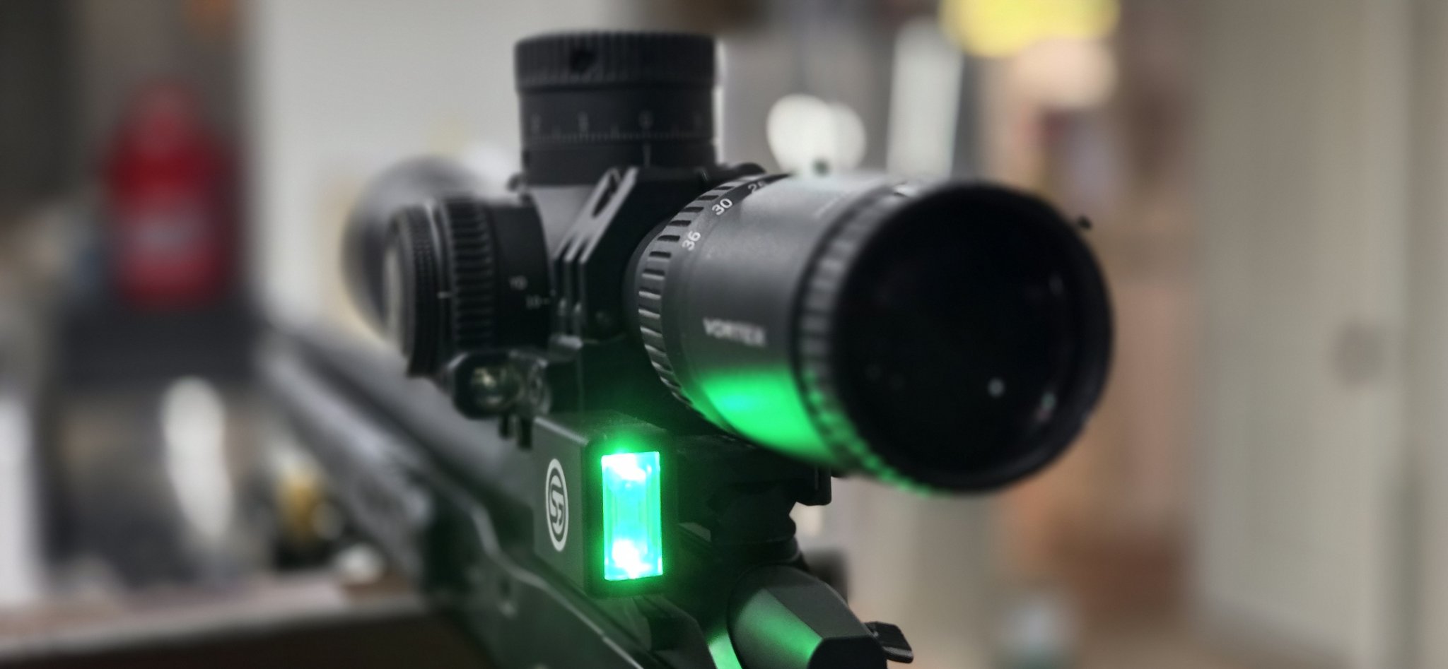

I ordered both, kept the Pulse. Set up on the back of the rifle it's pretty in your face, even in the sun, and no need for a fiber kit. It's super easy to use the app to change brightness, see battery level, calibrate and more. The battery will easily last a couple days, plenty for a 2 day match. Charging it is easy as well, could charge it off a battery bank in between stages if you forgot the night before.

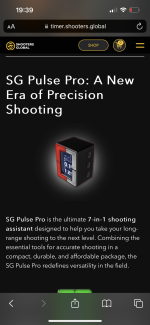

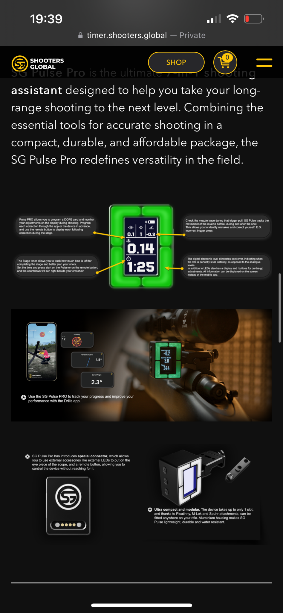

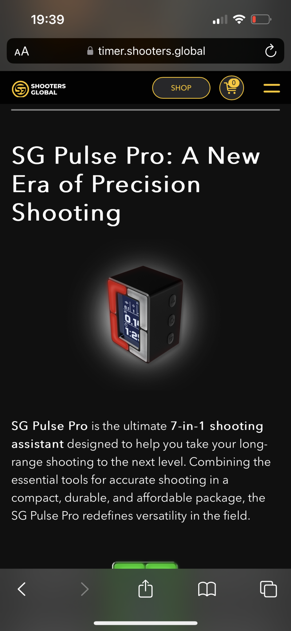

I have both. I prefer the Pulse. More noticeable in the peripheral than the send it. Plus it’s much cheaper, nearly two units for the price of one. And SG announced the new SG Pulse Pro coming out, but not sure when.

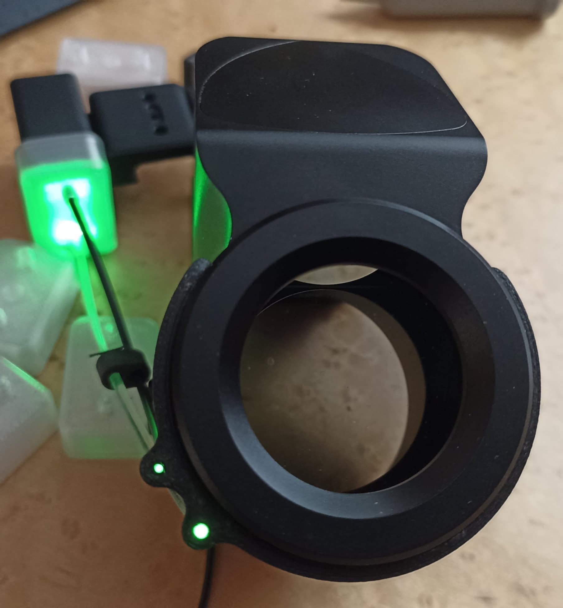

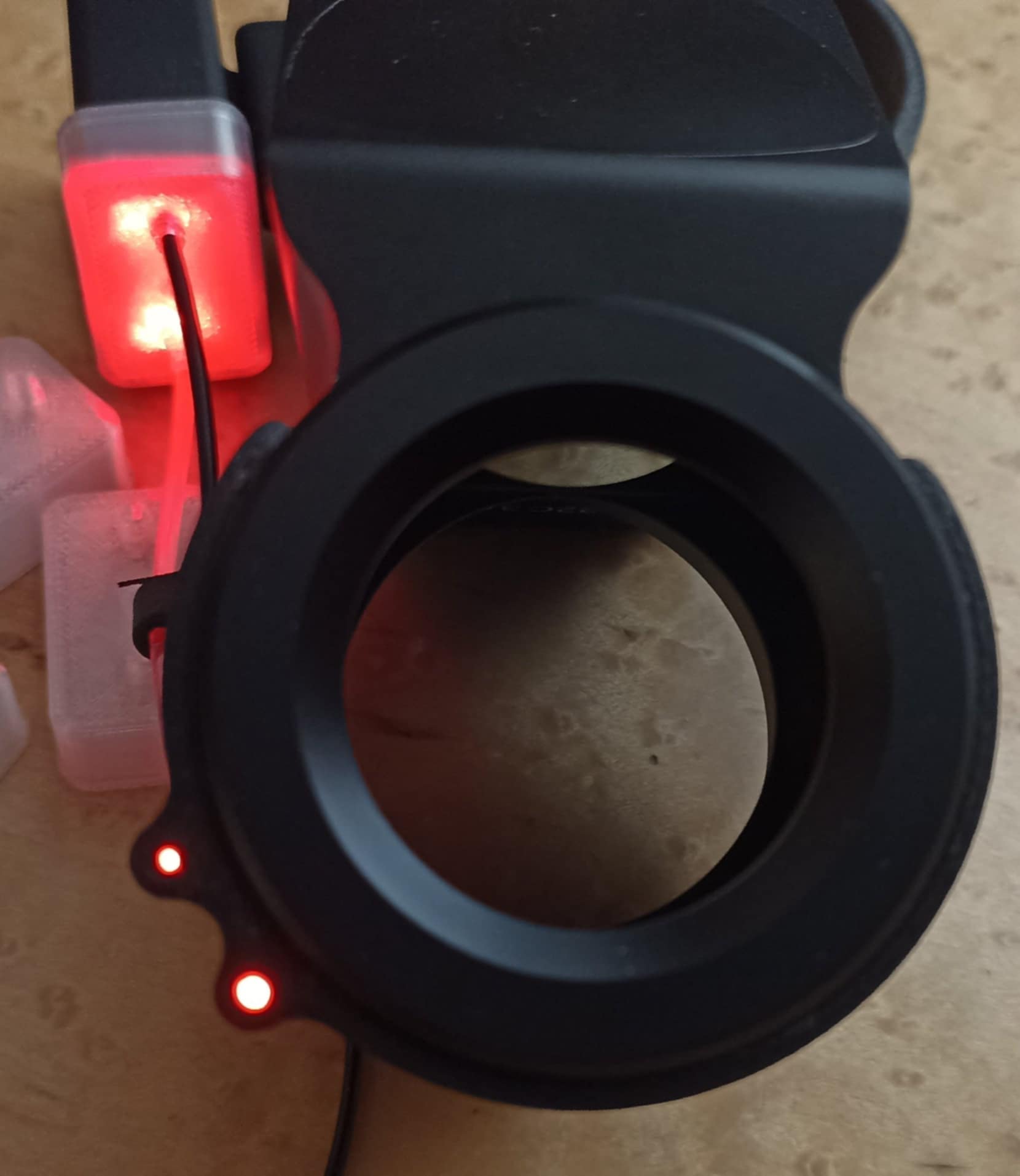

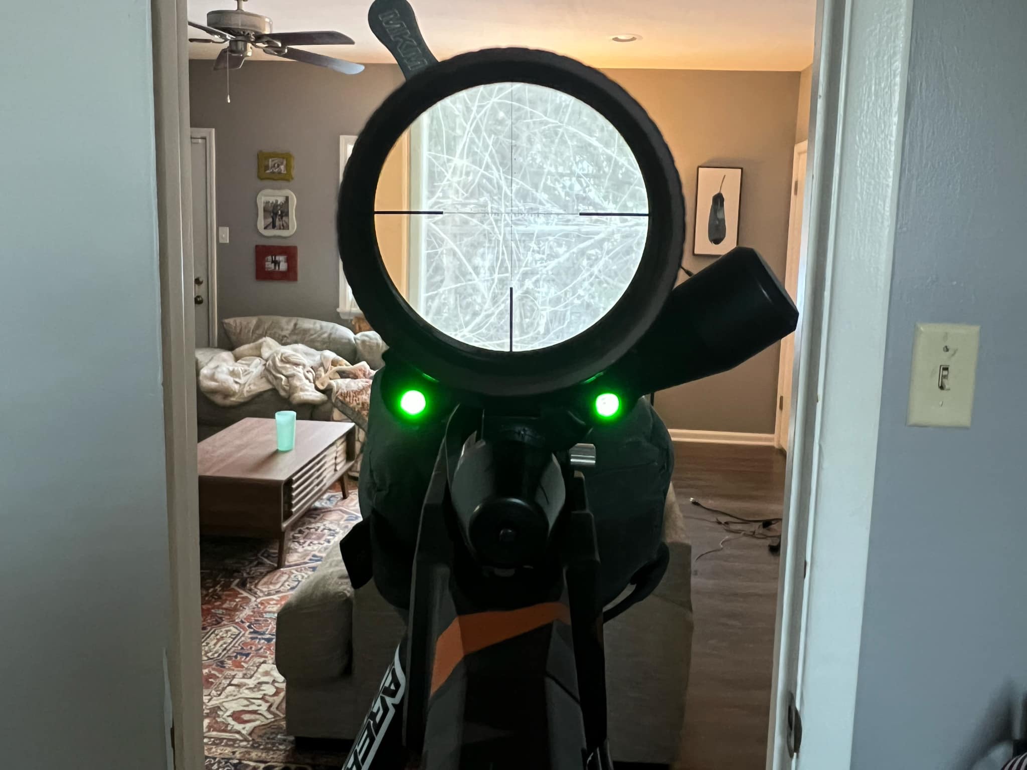

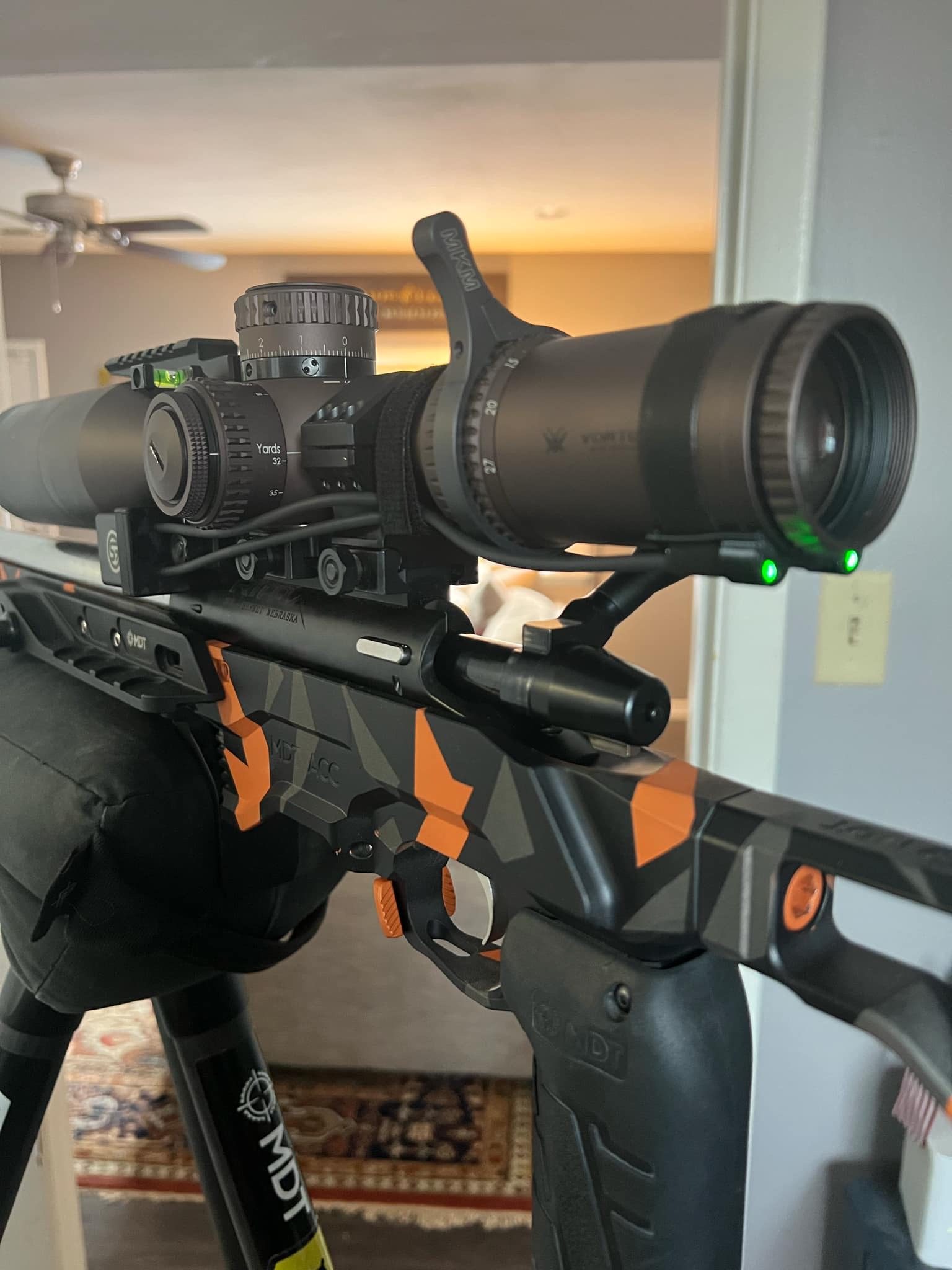

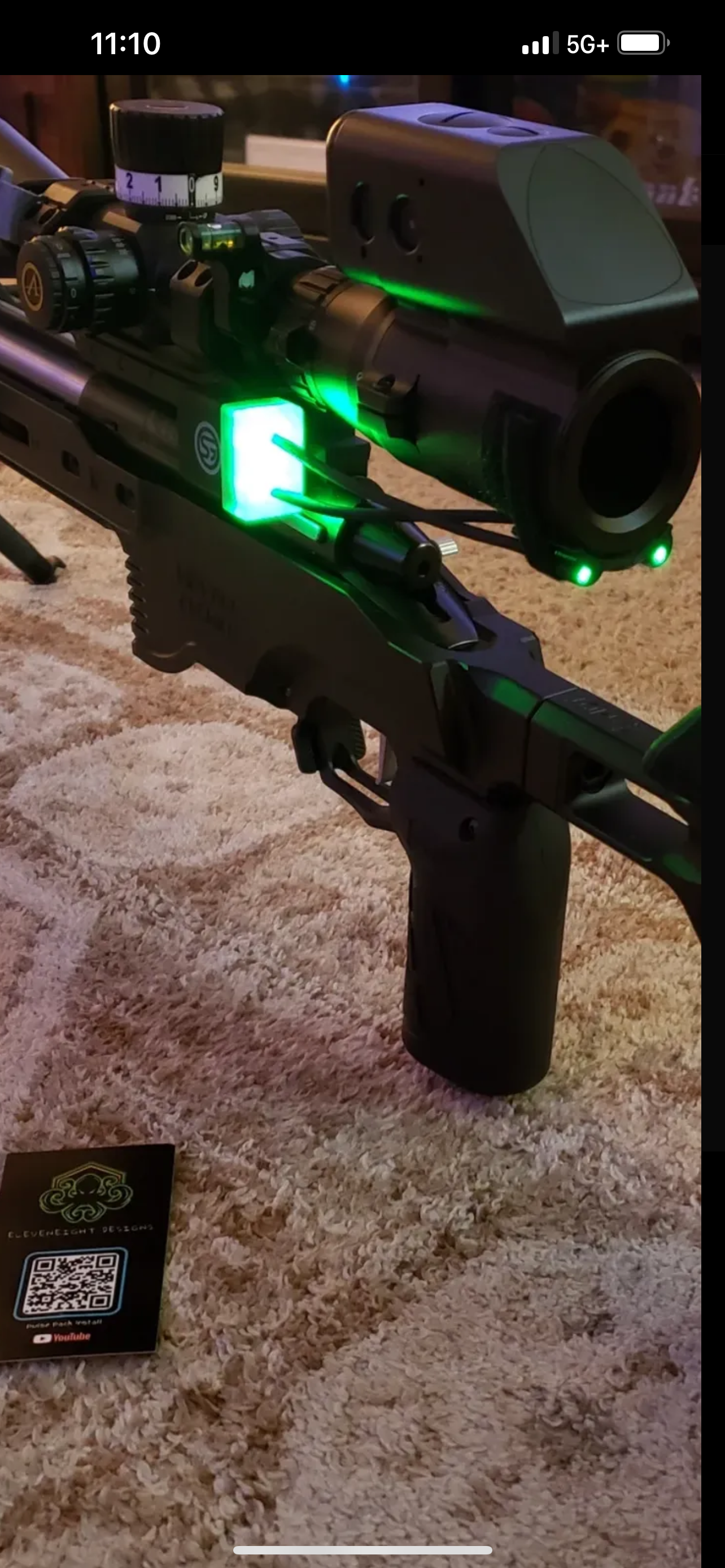

Just finished an ocular adapter for SG Pulse on TriggerCam 2.1 ,will shortly be availible once i make some stock , its a snap on fit so no adhesive used.
*two different fiber optic used on the prototype to test different diameters ,unlike sendit pulse does not have a led ladder there is no point in having 4 or left and right as they all glow in the same color ,was even considering using just one fiber ,short unobstructed fiber path might be most beneficial

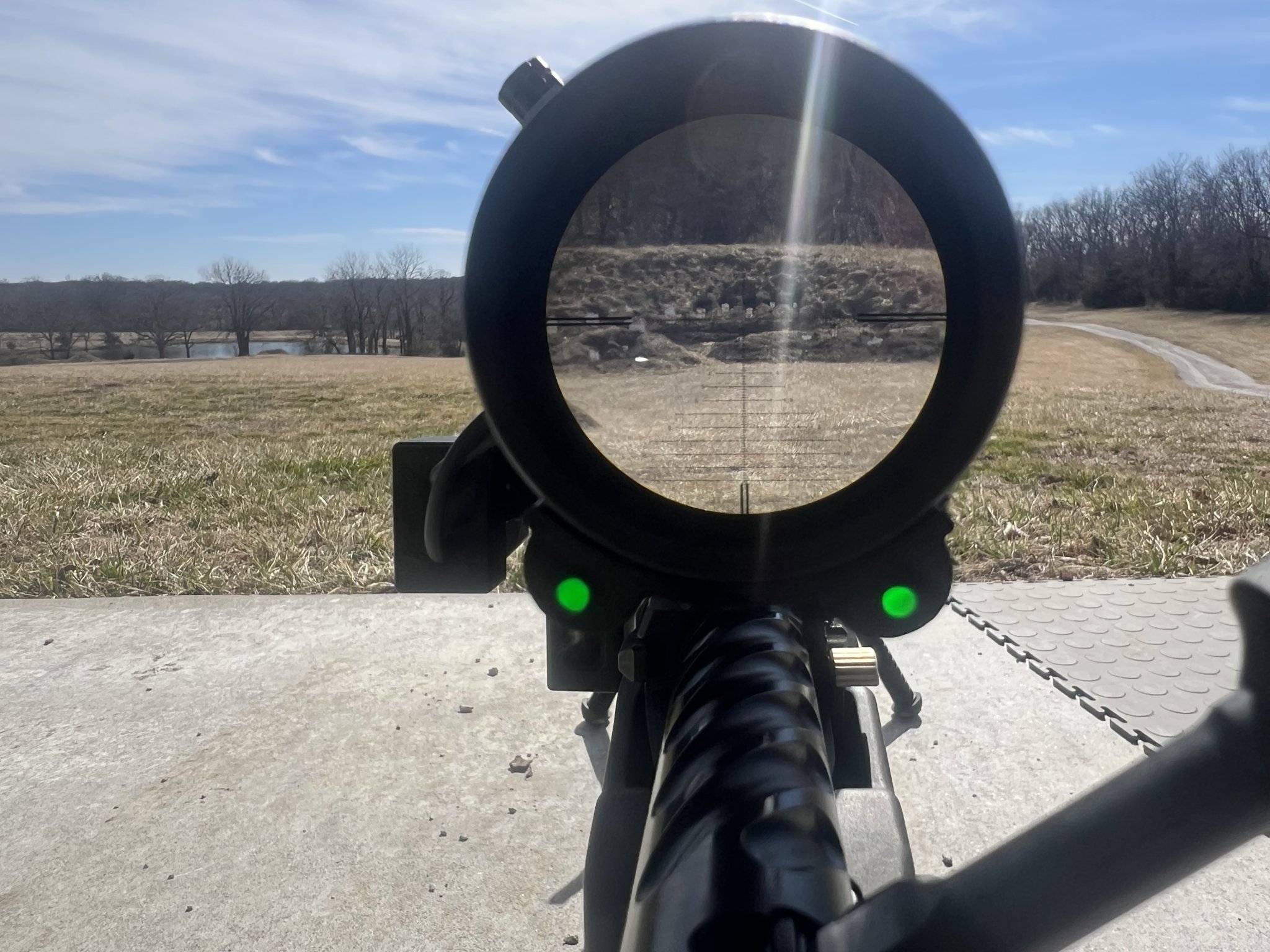

The “on the clock” factor is what makes me appreciate the digital levels over a bubble. For me it is much easier to reference a colored light with my off eye than view a bubble. On the clock is where the ocular setups with either level system really shine I think too, you can stay 100% focused in the scope and track state of level
