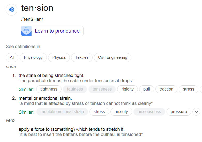

Stop using the word "tension", unless you can measure your brass hardness you have no idea what the tension is. Inconsistent seating pressure can be cause by many different things; chamfer, hardness, ID variation, neck shoulder junction donuts, etc. Start by describing exactly what is causing the seating pressure inconsistency.
Everyone on the internet just recommends to do what they do even when they don't know why they do it.
This post only proves the point that “tension” shouldn’t be used to refer to the inside diameter or interference fit.
In most any other thing we don’t just say “we all know what they mean” even though it’s completely wrong. We’d guide them and fix the issue.
