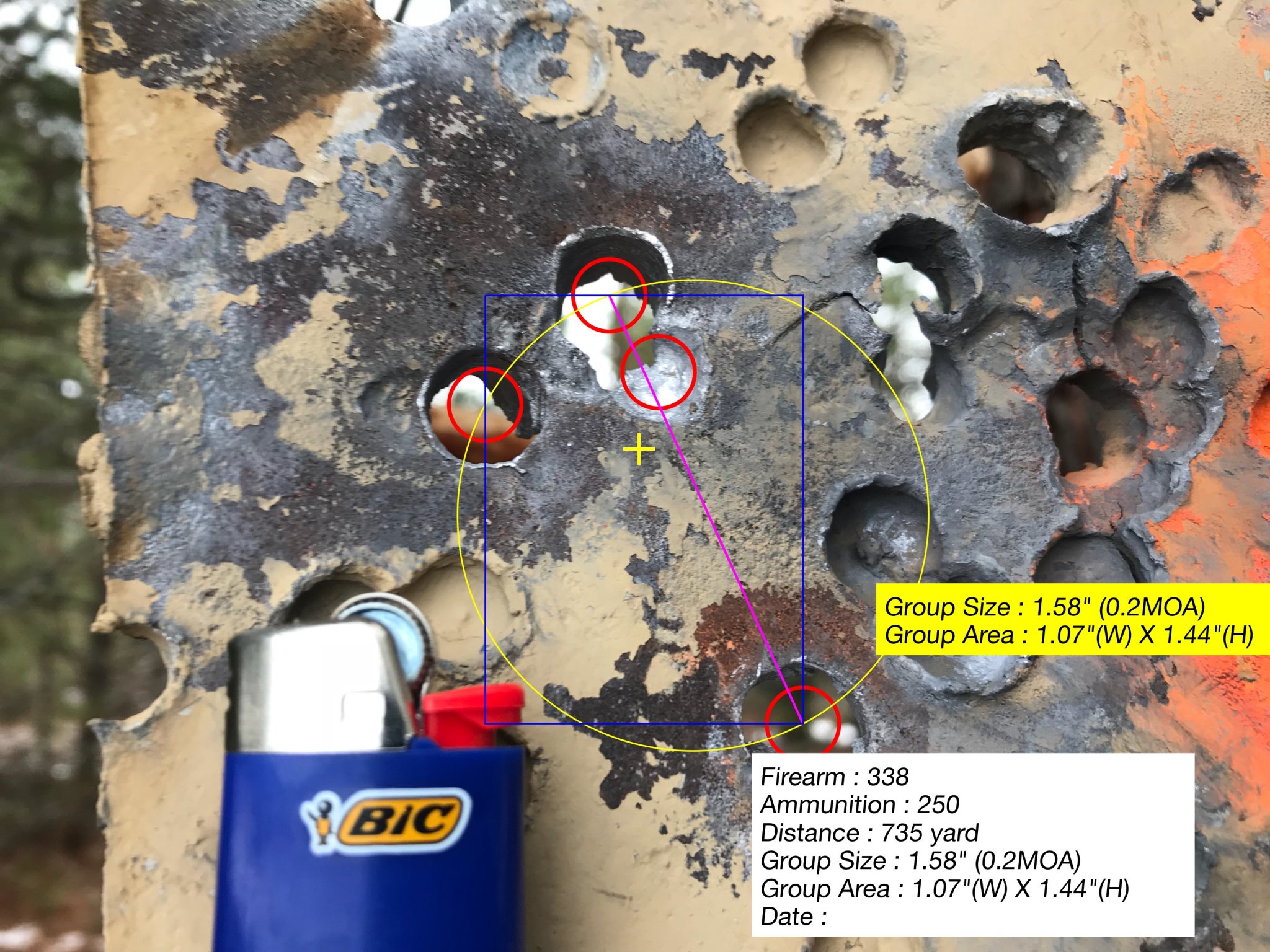

Mild steel at 1000 gets craters with the 300 wm. Around 12-1300 your fine with mild steel. Past a grand 1.5 moa is nice if you miss read wind. Especially if your back stop is bullet gobbling vegetation
At less than a grand the 338 puts holes in 1/2” mild
