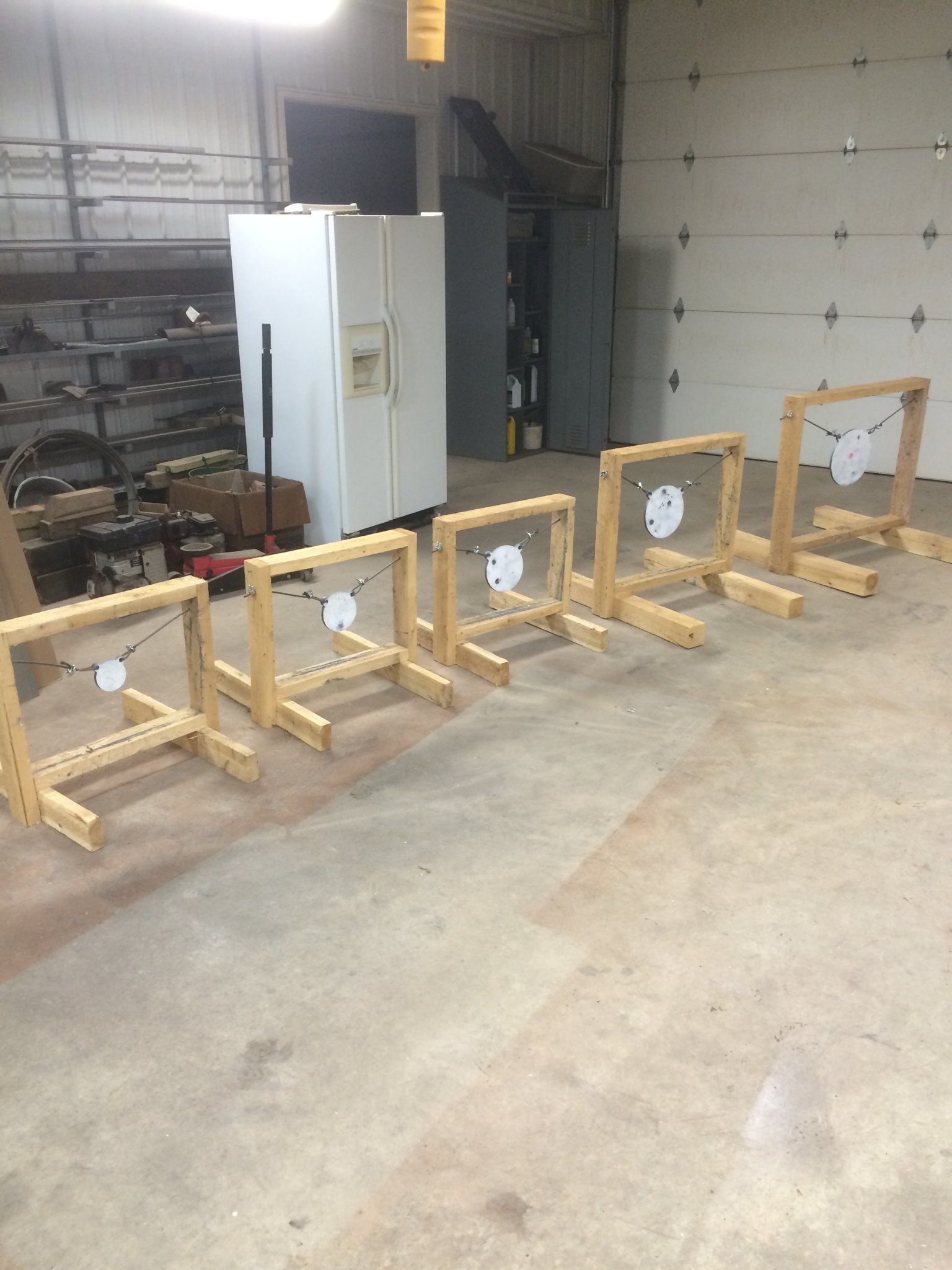

I made wooden plate hangers that I can set anywhere for mine. The fragments have just about cut the 2X4 down the center on them

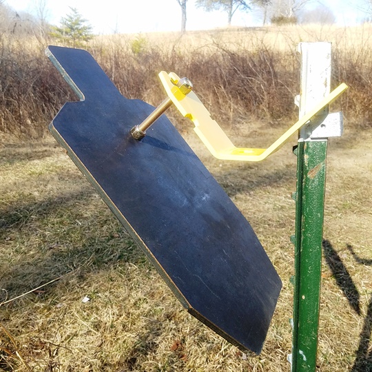

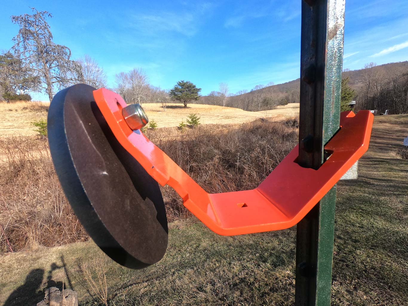

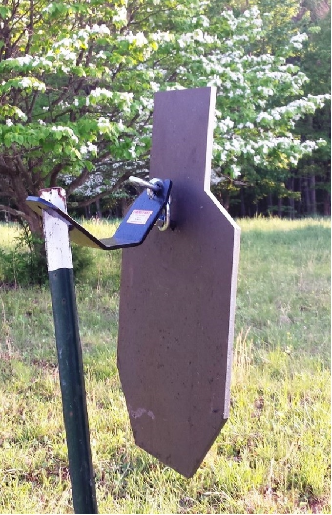

The previous input is spot on. Here’s a few pictures. Hanging is good for longer ranges where energy has been expended. Angled is good for target life, and required for safety if you’re going to do anything close up like pistol caliber drills. The 2x4 and conduit bracket kits are easy to find at Scheels, Cabela’s, Amazon etc. The angled brackets tend be at 15 degrees. Buy a grade 5 bolt for the 2x4 hanger and it will survive longer. And don’t shoot green tip 5.56 at anything unless you like replacing AR500 targets.

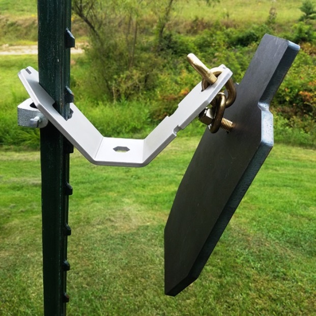

I really like the T-post target hanger system from D-M Targets. He also has an angled hanger bracket if you want the target sloped downward.
I use them for both long range and also for close up pistol targets, have thousands of rounds on them trouble free. The hangers from JC Steel are good too.
Seems like an extreme angle, you lose half the target height.
Angles are very adjustable with this system depending on the plate/hanger and mounting combination you select.
The standard angle is 17 degrees which leaves 96% of the plate visible. A 12" plate would have a 11.52" visible exposure.
The 66% IPSC Extreme angle (12 x 20") hangs at 40 degrees and has a 76% exposure with 15 inches showing.

^^^I have used the JC Steel tpost hangers. Work great with my 66% IPSC's.

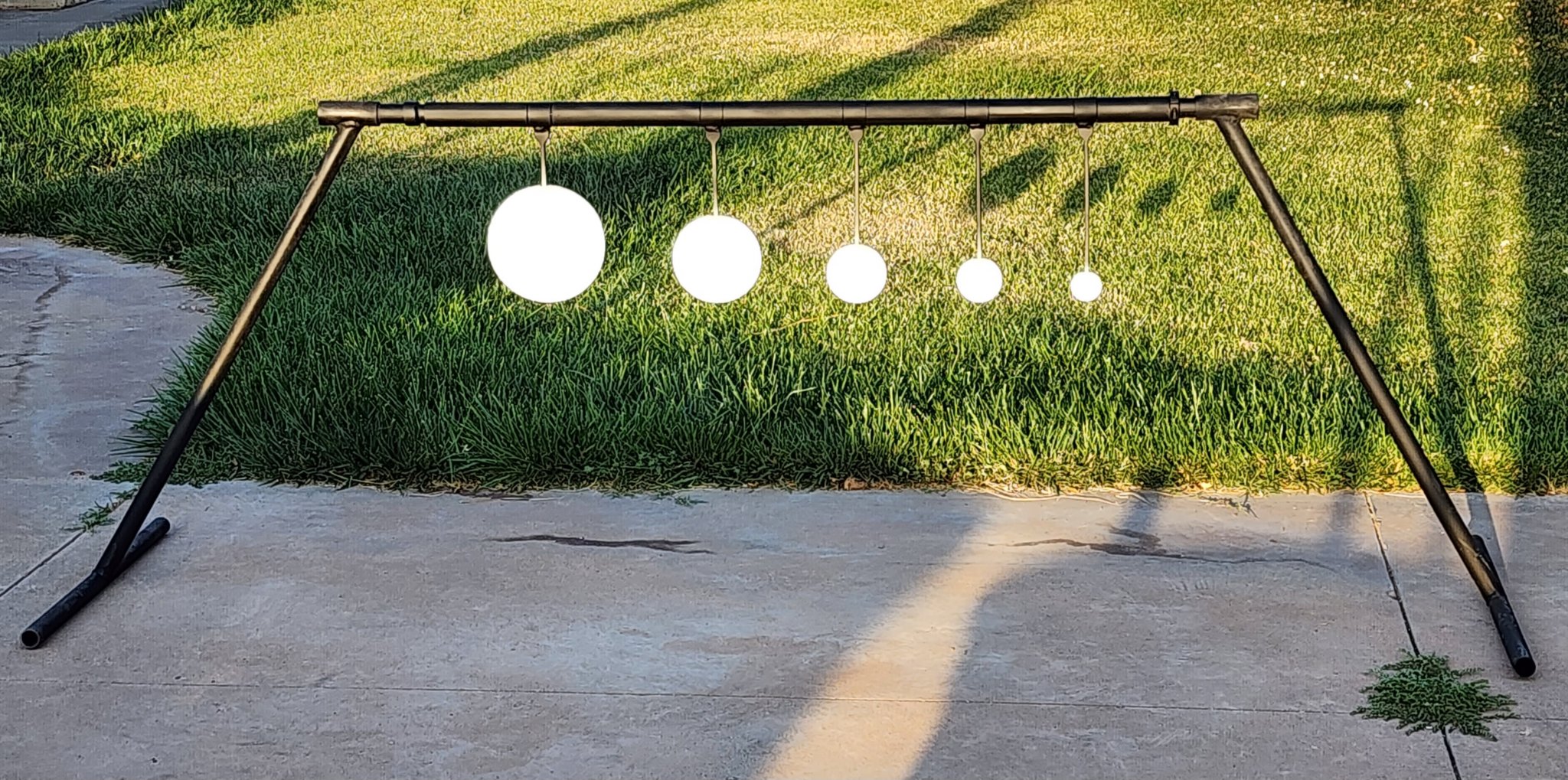

Here is a pic of my 500-yard setup. Large target as a sighter and progressively smaller, all on a single 6' T Post.
Because of their single mounting point on a 3-link chain, they react noticeably with hits and reset within 3 seconds, and they ring like a bell.
This target has been in place and shot on a regular basis for 5 years with the same T post probably because the targets are stacked with very little room for the bullet to get through to the T Post.

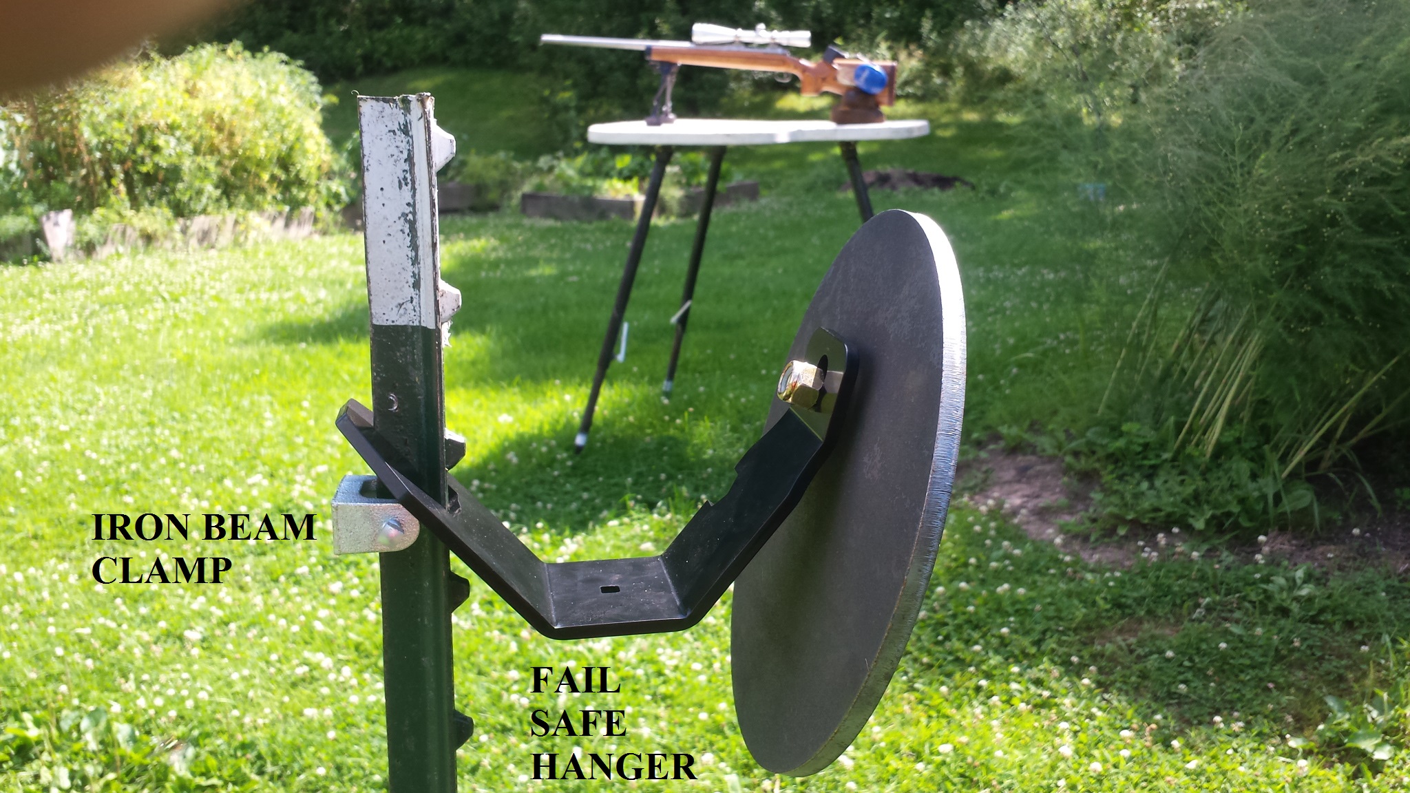

Thanks Vinconco for the recommendation. I have purchased the following targets from Hang Fast:
  • 10 yards 6-inch round on Fail Safe Hanger
  • 12 yards 6-inch round on Fail Safe Hanger
  • 16 yards 6-inch round on Fail Safe Hanger
  • 32 yards 8-inch round on Fail Safe Hanger
  • 65 yards 10-inch round on Standard Hanger w/ chain mount
  • 100 yards 12-inch round on Standard Hanger w/ chain mount
The T-bar installation is quick and easy. The Hang Fast system is also quick to deploy and retrieve once the posts are set up.
I don't want to make any more wooden target hangers, especially in volume lol.

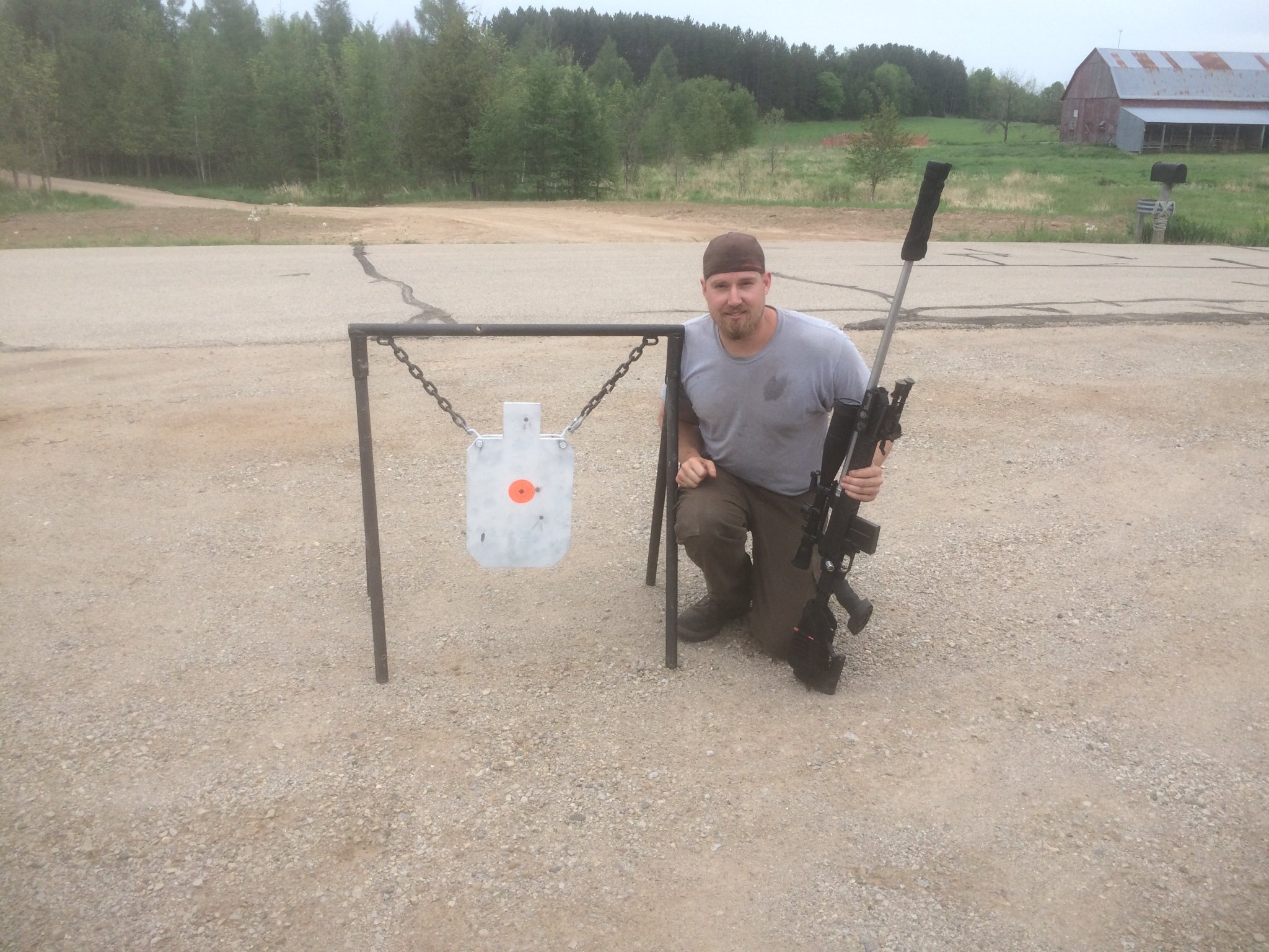

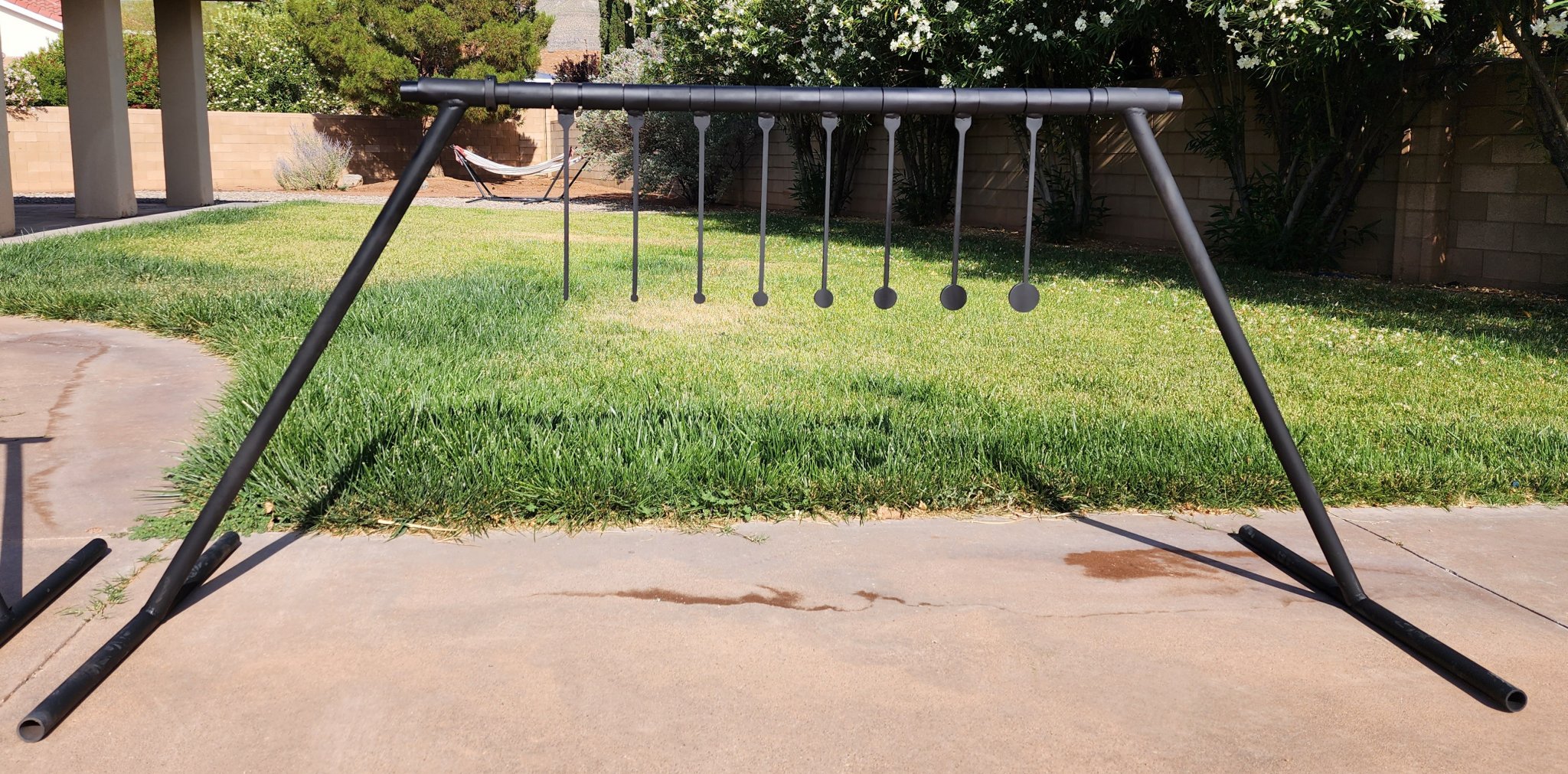

Hello all:

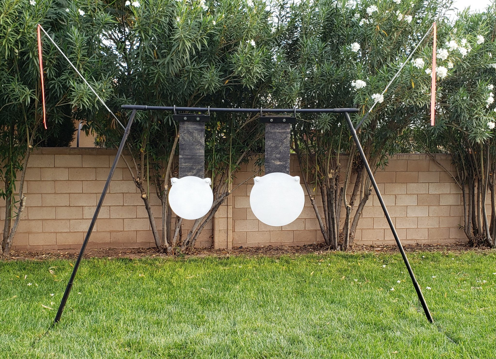

Thanks for the replies and great information. Here's what I ended up doing for one target.
It's an AR500 target suspended on chains.
I can get up to 200 meters on this one target.

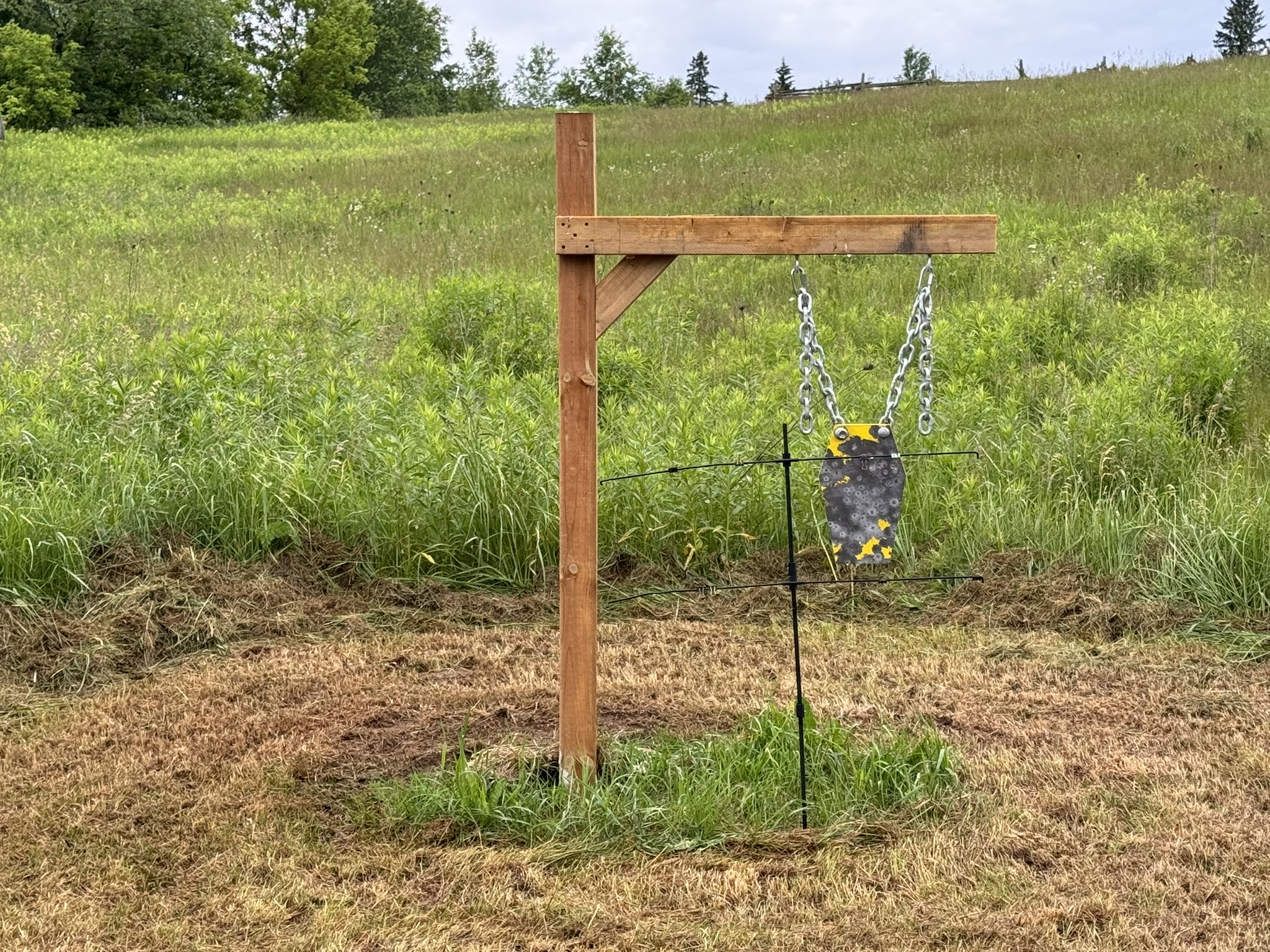

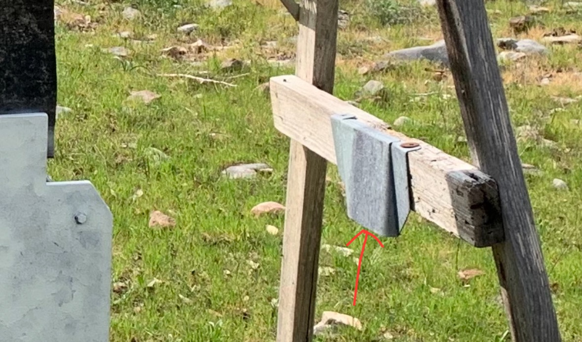

Late reply but I would suggest adding a little sheet metal buffer where the wooden posts start showing signs of getting chewed up by splatter
An example of what I mean, the metal can resist getting chewed in half better than the wood behind it prolonging the frames usefulness.
