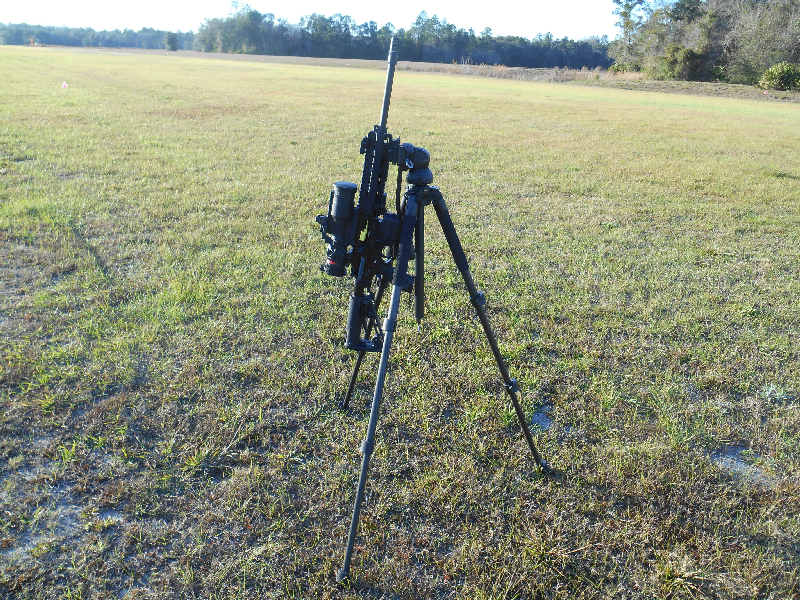

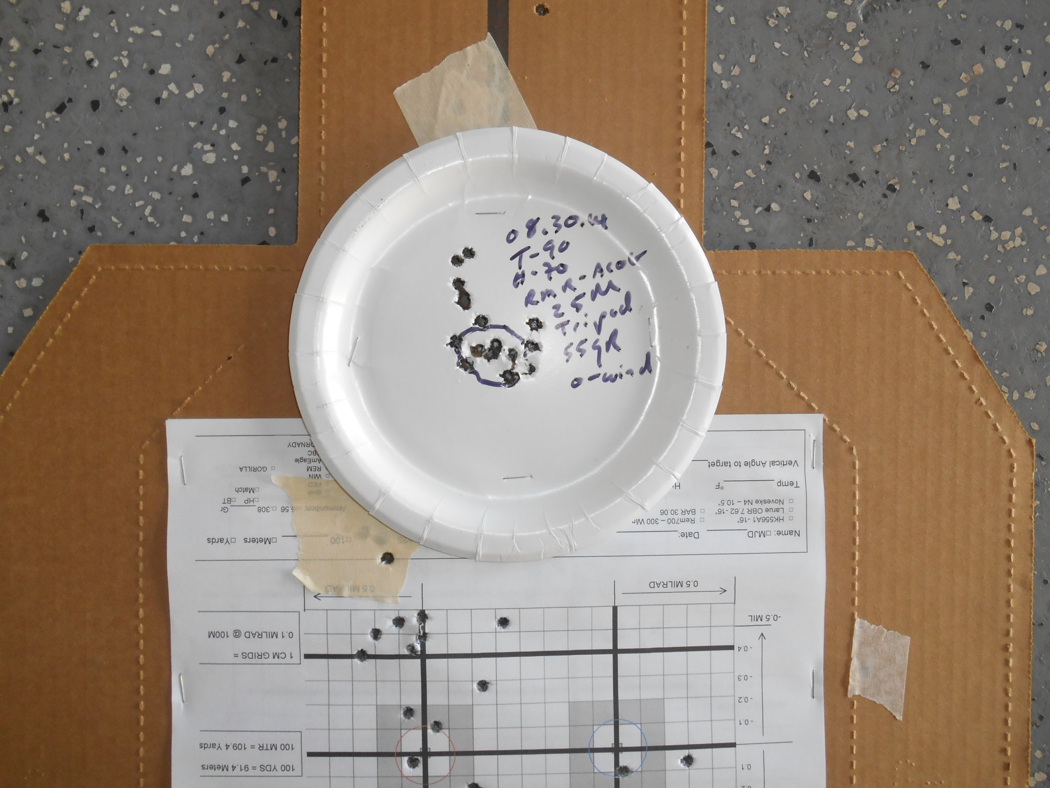

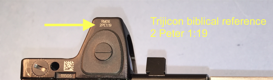

I set up this 8 MOA RMR/ 6x48 ACOG chevron reticle HK MR556A1 tripod assembly with a 25 yard zero for the red dot; the big ACOG has very good light gathering optics in low light conditions. Use this combination at dusk / dawn to eradicate varmints off a grass airfield as the rascals could dig some landing gear size potholes. Then there was the Biblical references scandal which several of my optics were blessed.
