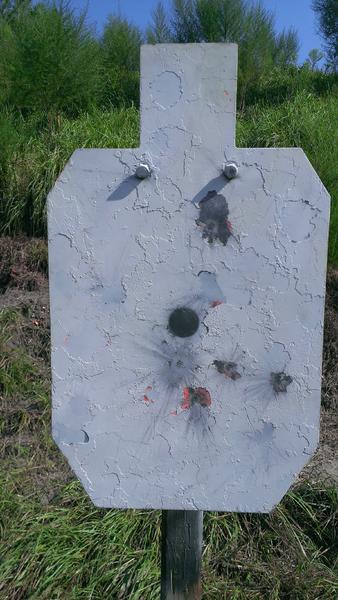

    Here's three shots from this morning including the fouled cold bore.
    All .1 Mil low and .1 Mil right:

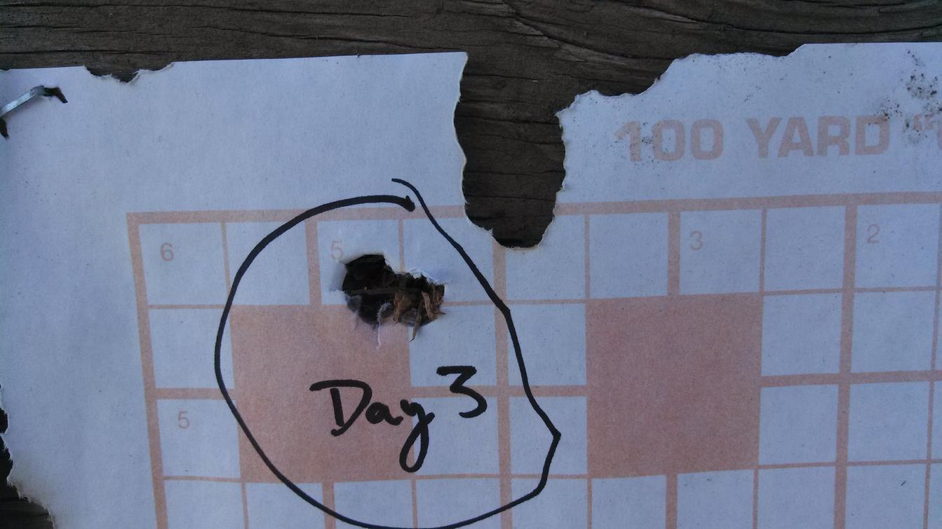

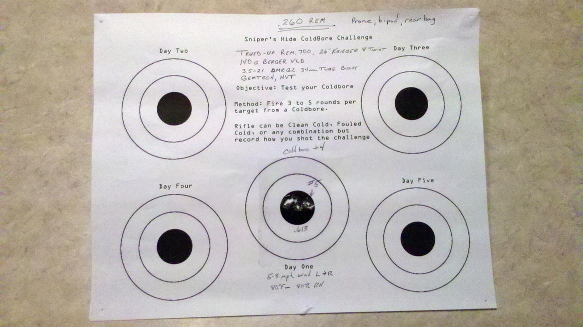

    Day 3
    nice shooting Sinclair and Savage... Here's my day 3... absolutely 0 wind at the gun, on the 243 target i need to give it about .1 mil down for cold bore from now on. That 5th shot i'm definitely gonna blame operator error, i pulled the trigger on a boil.
    The first shot with the 260, hornady brass was used, the last four were R-P. The hornady round felt like it had more neck tension during seating, so I'm not sure if that had anything to do with where it landed, or if i just let it play mind games.

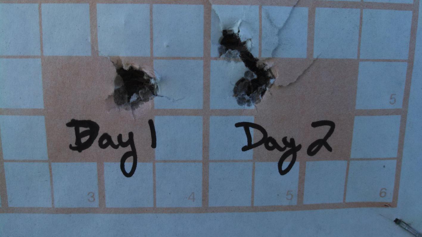

    Heres my day one and then day two right next to it. Pulled the last one on day two. I was so excited I had another one hole going I blew it. GAP 308 shooting 178gr Amaxs over 42.5 of var get. That's my best group to date on day one! Never had a rifle that shoots like this GAP. Can't wait to get my next one.
    Edited to add this is fouled/cold bore

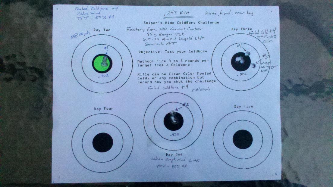

    Fired day 3. Reposted day 1 and 2 to keep them together. Again GAP 308 shooting 178gr Amax over varget. Each time point of aim was the corner of the target. Top left on day 2 and top right on day 1 and 3.
    Fouled/cold bore for each group.
    Why don't you use the same point of aim?
    My son has riddle the targets I had set up with holes so I was picking spots without holes everywhere. I was going to group all five days on that one set of four squares, until my son filled the others with holes. Other than that no reason
