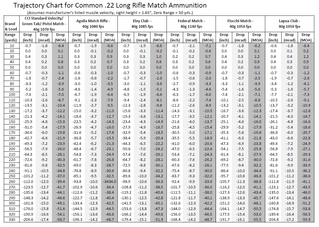

I'm looking to see if anyone wants to be kind enough to share some dope for Sk Long Range match. I've searched and looked at the sticky but cant seem to find this round listed. I understand that this info will vary a bit rifle to rifle and lot to lot. I'll be shooting my first 22lr match next weekend and have only shot my rifle out to 100 yards. So just looking to have something to base off of and hopefully just make adjustments on the fly if needed. I'm using a steel barreled Bergara B14r with a Strike Eagle. Thanks in advance for any help.

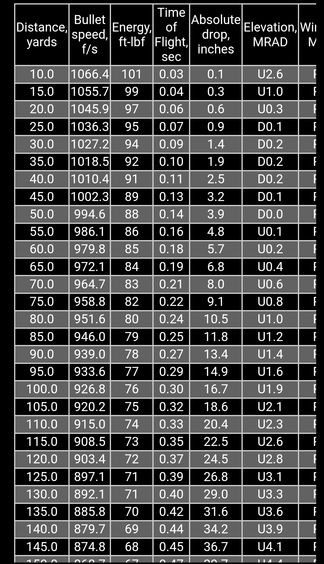

I'm shooting a bergara with SK long range and my info pretty much matches BirdDog's velocity is set in strelok at 1079 right now and it was correct for targets to 300 last time at the range

Thank you again for the info I'll be able to work with that for sure. The match I'm shooting is just a local club match but would prefer not to look like too much of a goober out there. This should at least put me on target. I'm in Az so elevation where I'm at is just a bit higher. I punched the info into the calculator for the G1 BC .121 and everything is about the same as what you have.
