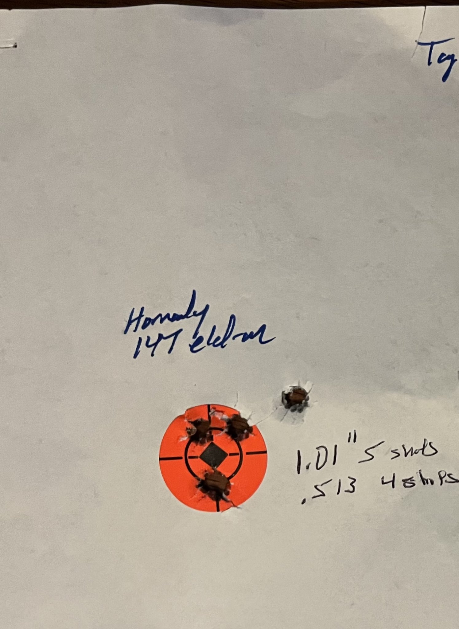

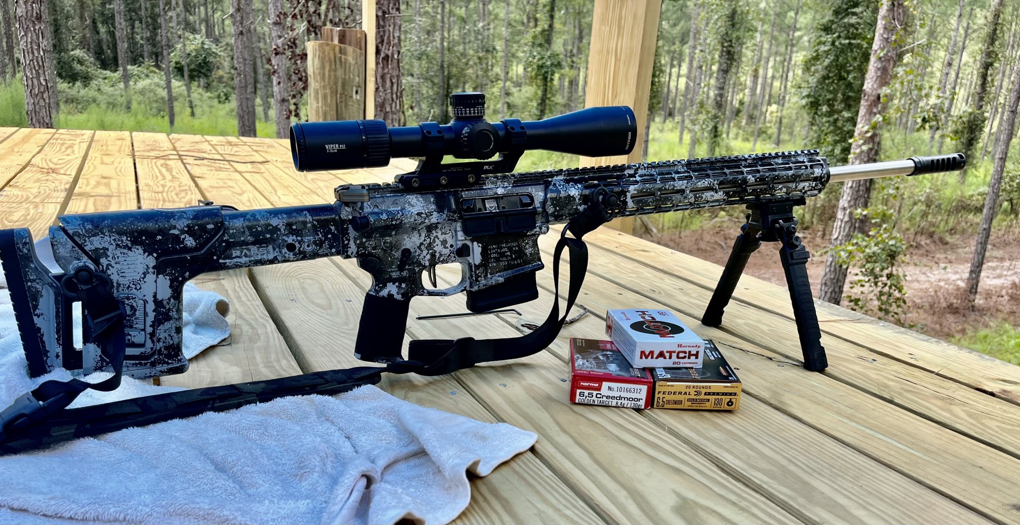

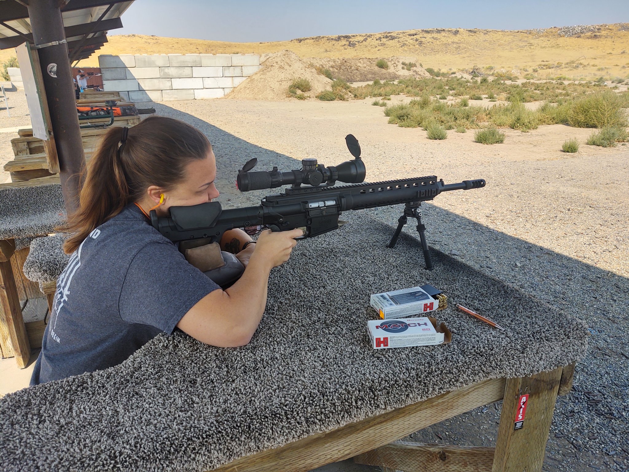

Just finished my wife’s new range toy and gave it a test run. She said she wanted a large frame AR too so I obliged. I had other plans for this set but she liked the hydro dip much more than me so I built it out for her.
Aero M5e1
6.5 creedmoor Proof 22” SS
Bedded to a thermo fit
Ultradyne Apollo S brake
Superlative gas block
RCA bcg
CMMG zeroed mk3 lpk
Larue mbt2-s (her preference)

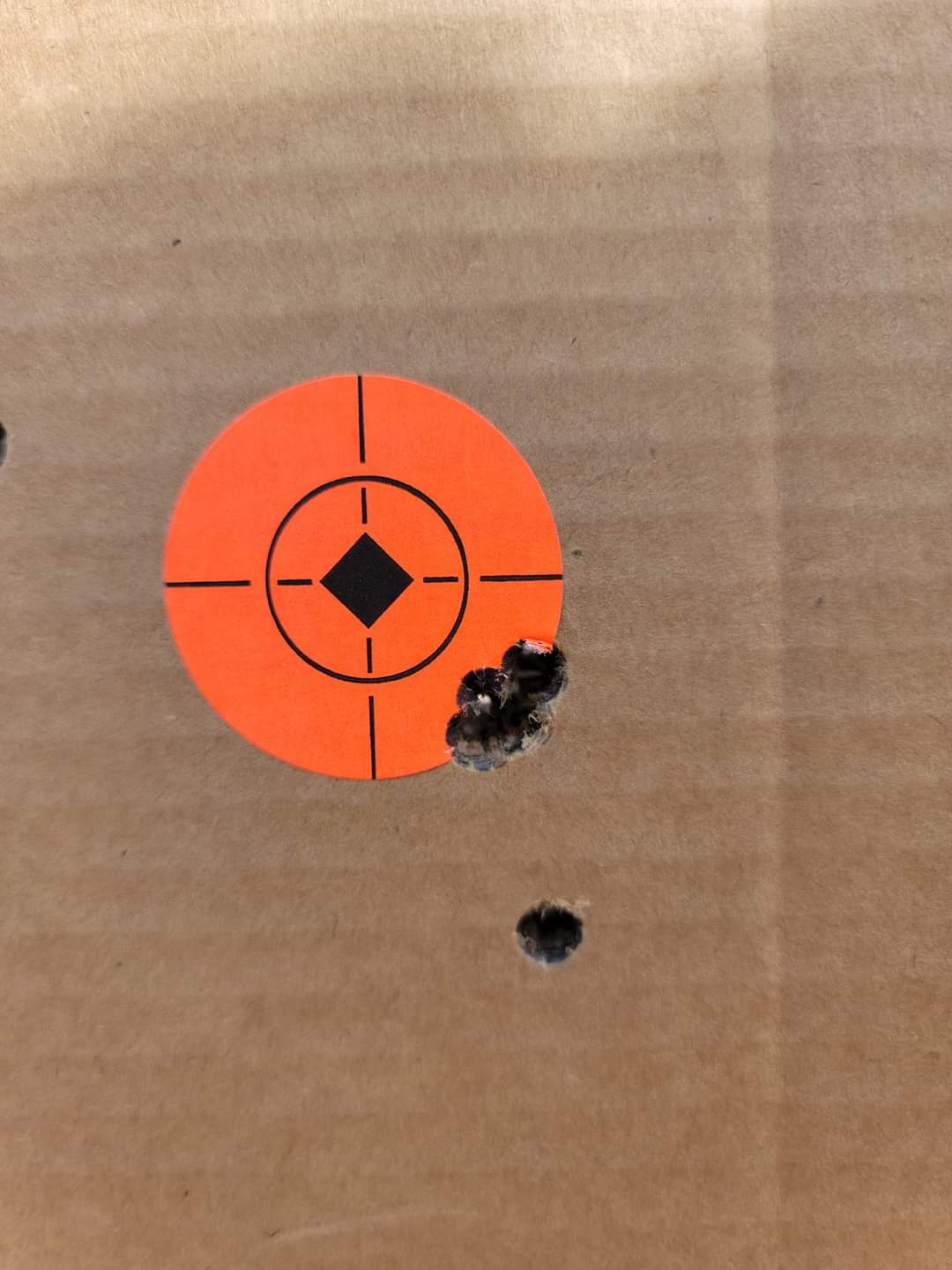

Shot prone to practice starting with 15 rds today breaking it in, then put 5 147 eldm’s and 5 130 FGMM rounds on paper to see which it may prefer. Going to put it on the bench with these two next time to see if I can get rid of that dang flyer. I’m pretty rusty shooting prone, been a minute until recently.

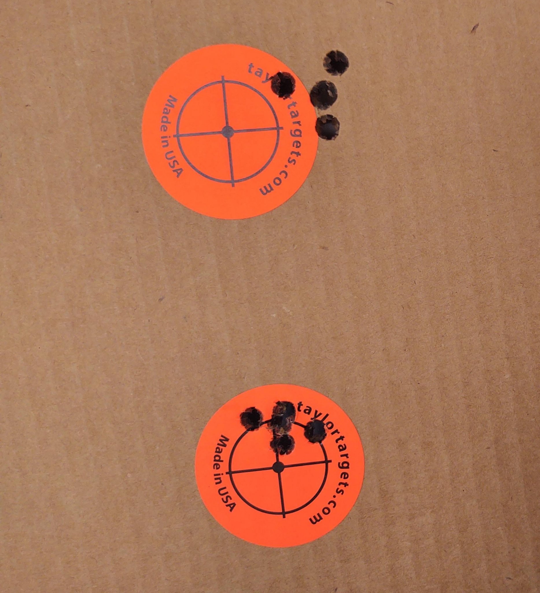

OP, try loading more than five in the mag when shooting five shot groups. Sounds weird, but sometimes it helps.
I gave my old lady the OBR that I rebarreled with a CLE 18" 6.5CM Bartlein thats why I haven't done a in depth review on it yet, set everything up for her, Scope, LOP, Cheek Hight, Trigger. She likes the TT Adaptable, I run the Diamond's and our eys are so different we cant share a scope. Even though she's a retired ITCS she wasn't required to qualify with the M16 or M4 only the M9 and M500 so this was her first time ever shooting an Gasser let alone a Large frame.
It's so much easier teaching somebody who hasn't picked up any bad habits yet. The day before after fitting the rifle to her I ran her through a bunch of dry firing drills getting her familiar with the controls and how to perform remedial action in case of a malfunctions.
Next day at the range I conducted a 5 min refresher, and observed here first 5rd group on steel watching to make sure she didn't forget any of the fundamentals we went over the day before. The first shot took her by surprise and she took her finger off the trigger shoe not following through and failing to conduct proper reset. For the next 4 shots I got behind the rifle and had her observe recoil management, posture and the basic fundamentals which by doing so in a live fire scenario allowed her the chance to visualize and connect the dots from what she had verbally learned during yesterday's dry firing and today's live firing.
Got her back behind the rifle and handed here another 5rds and observed her re-engaging the steel without missing a step, then had her pivot back over to paper and I went back to tinkering with another project.
Like most range days I had a creeper come by my bench inquiring about what i was working on. While trying to complete my tasks and do my best to politely answer the man's questions I start hearing "Hon..Hon..Come here..Come here", after mentally screaming FML!!!!!!! I turn around and observe what can only be described as a kid on Christmas Morning with a shit eating grin..
These are her first (3) 5rd groups with Hornaday box ammo.

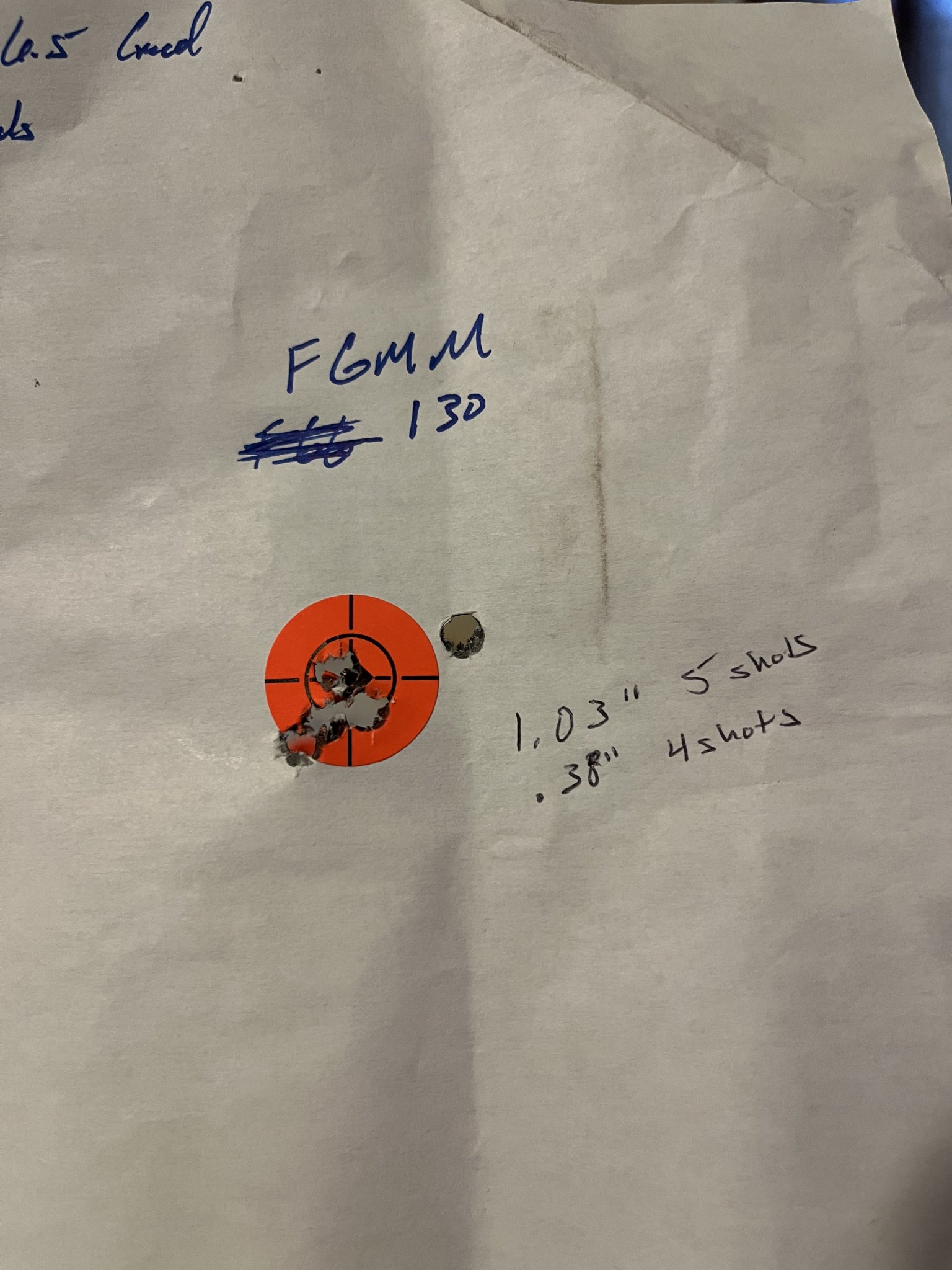

That flyer ain’t rust…welcome to the world of big frame ARs! Get used to it.
I enjoy the challenge
I won't add to the negative waves....ok, yes I will. Your gun shoots great. Lots of variables to look at with fliers. Sometimes it's hard to rule out stuff. Is it the first round, or the last round? Was it you? Is it the load or rifle etc... I think you've done a great job on the build.
Not enough time behind it to know. This was the initial barrel break in and function test. It was 95* and humid with no wind, so miserable. I’ll have more time with it

Some fine shooting on her part and a nice rifle to do it with!
