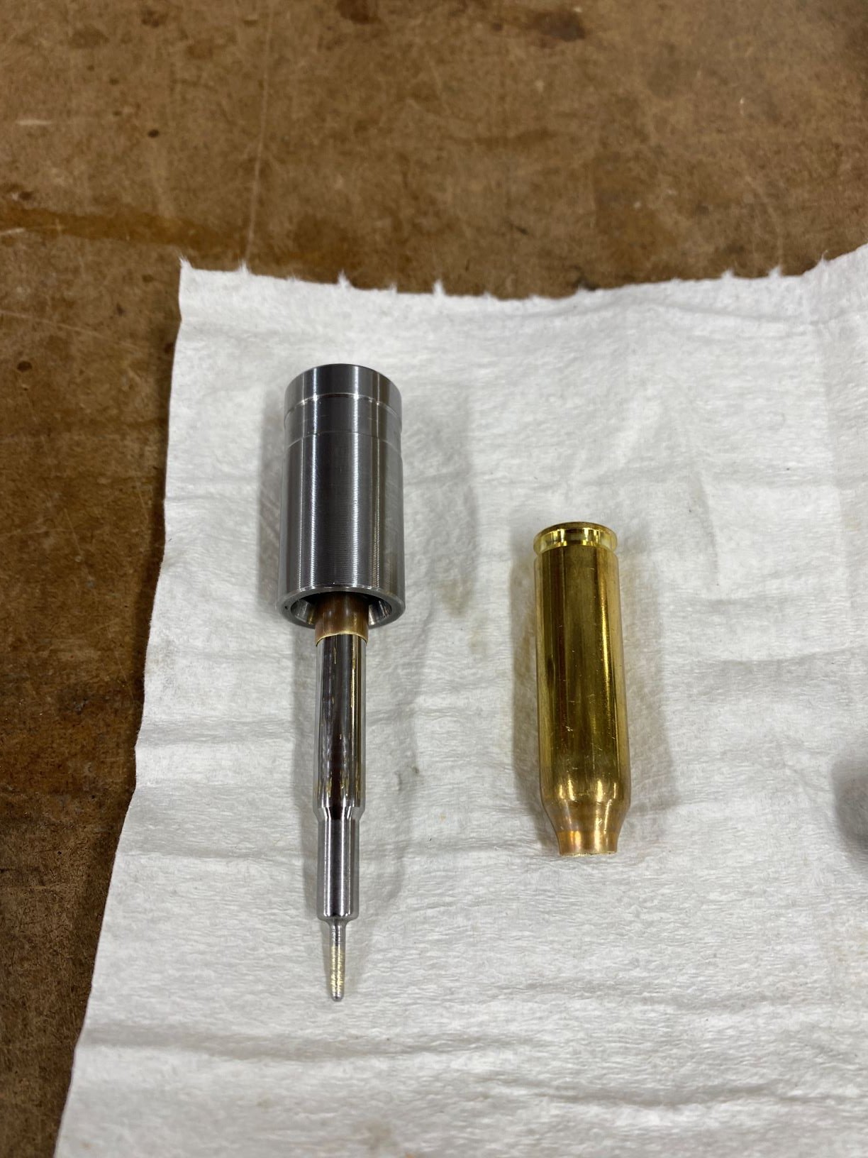

I was neck sizing new Lapua 6.5CM brass, just to get the necks nice and round for loading. Was using a Lee collet neck sizing die. I didn't think I needed to lube the cases just for neck sizing, but I'm thinking I guessed wrong. Pulled the neck right off one of the cases. Was I wrong in assuming I didn't need to lube when neck sizing only? Should I be concerned about the other cases I sized without lube? I need to get a new die and will lube from now on. Here's a pic of the carnage.

I use a Lee collet die for my 6.5 creed and never use lube. These dies shouldn't open up the neck. They should squeeze it smaller. Did you full length size, body size, or were you neck sizing fire formed brass?
I was neck sizing new brass right out of the box. I suspect I was using too much pressure. I can actually see on the case neck where the 4 petals of the collet made contact, because a little ridge was left on the brass between the petals.
I was running the die until it had pressure, pushed through that and continued to run the die until it bottomed out and came to a hard stop. Will try less pressure going forward. All I wan to do is take is make the neck opening round and remove any dents.
No you don’t need lube. I’ve run thousands of rounds through lee collet dies no lube
The issue your having is the collet squeezes the case neck to the mandrel. There’s no expanding process. One reason the collet die is so efficient because it doesn’t overwork brass
Your trying to size factory sized brass where the inside of the case neck is less than the diameter of the outside of the mandrel. Essentially your seating the mandrel into the case like a bullet
Lapua case is probably .003” neck tension from the factory. In my experience most collet mandrels size to about .0015” neck tension
So you seated the mandrel of your die into your case neck and tore it apart coming back on the press. If you insist on doing this you’ll need to expand the necks first
Personally I run my first load of Lapua brass directly out of the box without touching the cases. If I get one that’s jacked up or notice different tension I’ll use it as a fouler or to get on paper before load testing
I run mine in a rcbs rock chucker. Set up so it applies just enough pressure on cam over to size the neck. It doesn’t take much. You’ll notice when you cam over there will be slight resistance. The resistance will get more as you screw the die down (in small increments 1/16 turn ish) but at some point the neck will stop sizing smaller. This is because the mandrel will only let it size down that far. Mine sizes with just the weight of the handle lowering.
If you apply to much pressure you’ll see the marks your referring to which are the collet fingers (slight marks are normal but not gouges) If you apply to much or continue to do what your currently doing you’ll blow the cap off the die. That’s it’s fail safe if you apply to much pressure
When you size once fired brass you’ll feel the initial resistance on the press which is the pin pushing the primer out. After that you’ll have no resistance until the press cams over or the ram gets to its upmost position depending on the press you have. This is the point where the sizing takes place.
Likely right now you have resistance on the way up because the mandrel is seating in the neck. *edit* Judging by your pic this is the case as there’s clearly brass the entire way up the mandrel
Oh and FYI on the decapping pin covered in brass,
Your 6.5 CM is likely small rifle primer brass
That pin on the collet die comes to size for flash holes for the large rifle primers. If you try to slide the decapping pin through a piece of your 6.5 brass it likely won’t freely pass through the hole (try it from the case head side of the brass) Then do the same through a 308 Lapua brass or large primer 6.5 piece of brass

@hafejd30, I never thought of it that way. I had found a couple of cases with dents in the mouth and that started me down this path. Was just playing around and noticed a couple of more things. First, my Lapua brass is small primer and the decapping pin on the Lee collet die is apparently made for large primer. I know because I how have 35 pieces of brass with wrecked primer holes. At a buck a piece right now for brass that kind of hurts!
I also noticed that part of the sliding die was hanging up in the mouth of the die. Right where Lee stamped their name and size info. Got that polished down so it slides smooth now. Tried running some large primer Hornady brass I had and it decapped and neck sized just as smooth as could be.
Lots of lessons learned for me. This is my first foray into loading rifle. Have done lots of pistol, but finding out there are some more nuances to rifle.
I've used my Lee collet neck sizers thousands of times & never had this. I'm not sure what could cause this other than the sleeve not dropping back down to release the neck. I have had some get caught as I was pushing the case up into the die of the neck if the OD was larger than usual & a couple of those were sort of stuck for a bit on the down stroke. There was deeper sleeve markings on the outside of the neck with those cases so I just assumed that the larger neck OD was the culprit.

Your OP appears to show that the Lapua brass is "crimping" at the neck to the mandrel stem and damaging the SRP flash hole with a Large Primer sized decapping pin.

If the neck is too soft the collet will cold weld the neck to the decapping rod. I have torn a neck off as well. It has nothing to do with the collet failing to release the neck.

Either the taper seized (always clean, polish and lube the tapers in the die, it’s set incorrectly or something is off with the die or brass.
I've just been down the "chuck the decap stem in drill and turn it down" so I can deprime fired Lapua brass(6BRX and 6Dasher) with a Lee Universal Depriming die.
FYI - for Lapua Small Primer flash holes aim for a deprime pin diameter appx .057-.061" to cleanly go through Lapua SRP without damage
Look at the brass galling on the decapping pin in the O/P's original post photo.
I believe I had two things going on at once. First, I did not realize the decapping pin was too large. Luckily I only ruined about 30 pcs of brass this way. I have a pin and will turn down the decapping pin to fit the small flash holes in my brass. Second, the sliding collar at the bottom of the die was not moving freely, as Barelstroker mentioned. I've polished up the sliding sleeve. I shifted to using an L.E. Wilson mandrel die for the time being on my new brass, but will revisit the Lee die once I need to process all my once fired brass.

I just had to turn a recapping pin down to fit the smaller flash hole in my Lapua SRP brass. You will wreck the hole if you use the larger standard size recapping pin.
No, someone mentioned a few posts up about his decapping pin having brass on it, and the likelyhood of a wrong recapping pin....

What old tricks? I cold welded a Lapua neck to the decapping rod. It tore off. I had to disassemble the die, pound on the neck that was stuck to the rod with a hammer and cut a groove through it with a dremel before it let go.
The only caveat with the Lee collet die is the initial neck OD. If that is too wide, the neck can become sort of stuck. When I resize, I can generally feel a slight resistance as the case travels up into the sleeve however, when I have used too large of a mandrel pin, that resistance can become large enough that I can tell things aren't what they should be.
You’d need a pretty opened up neck for that to happen but the lee will still handle that better than a bushing die.
