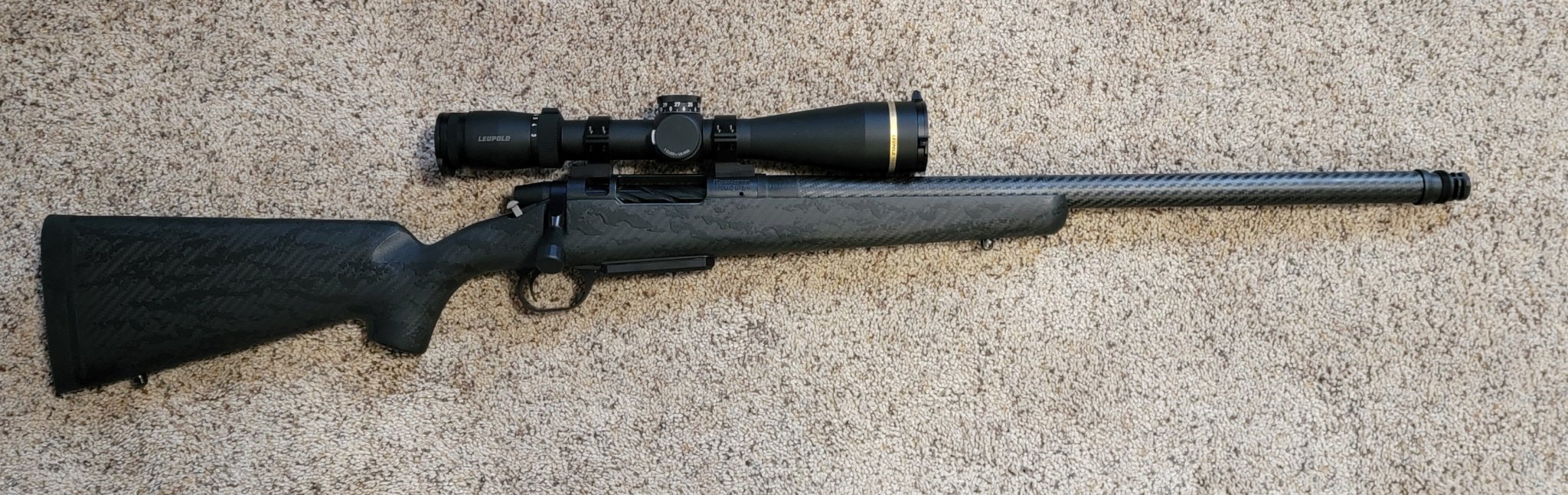

Well, our eyes are different, this is my vx6hd. It's glass is not on par with the zeiss I mounted yesterday.

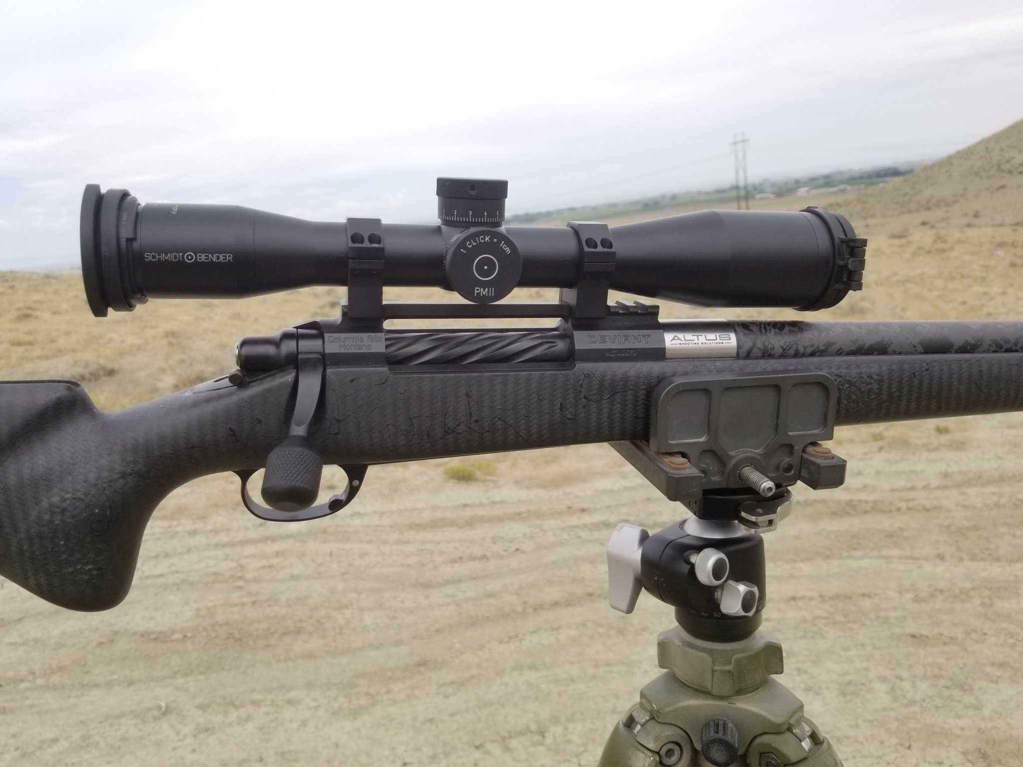

Schmidt and Bender PM2 10x42 fixed. Weight 20oz.
Thank you, one of my first choices also. Tell us more about that rifle, it's gotta be lightweight with the Manners UC and proof barrel?
If not the PMII 10x42, if you want second focal plane spend a little more for the NXS 2.5-10x42 or the SHV 3-10x42
