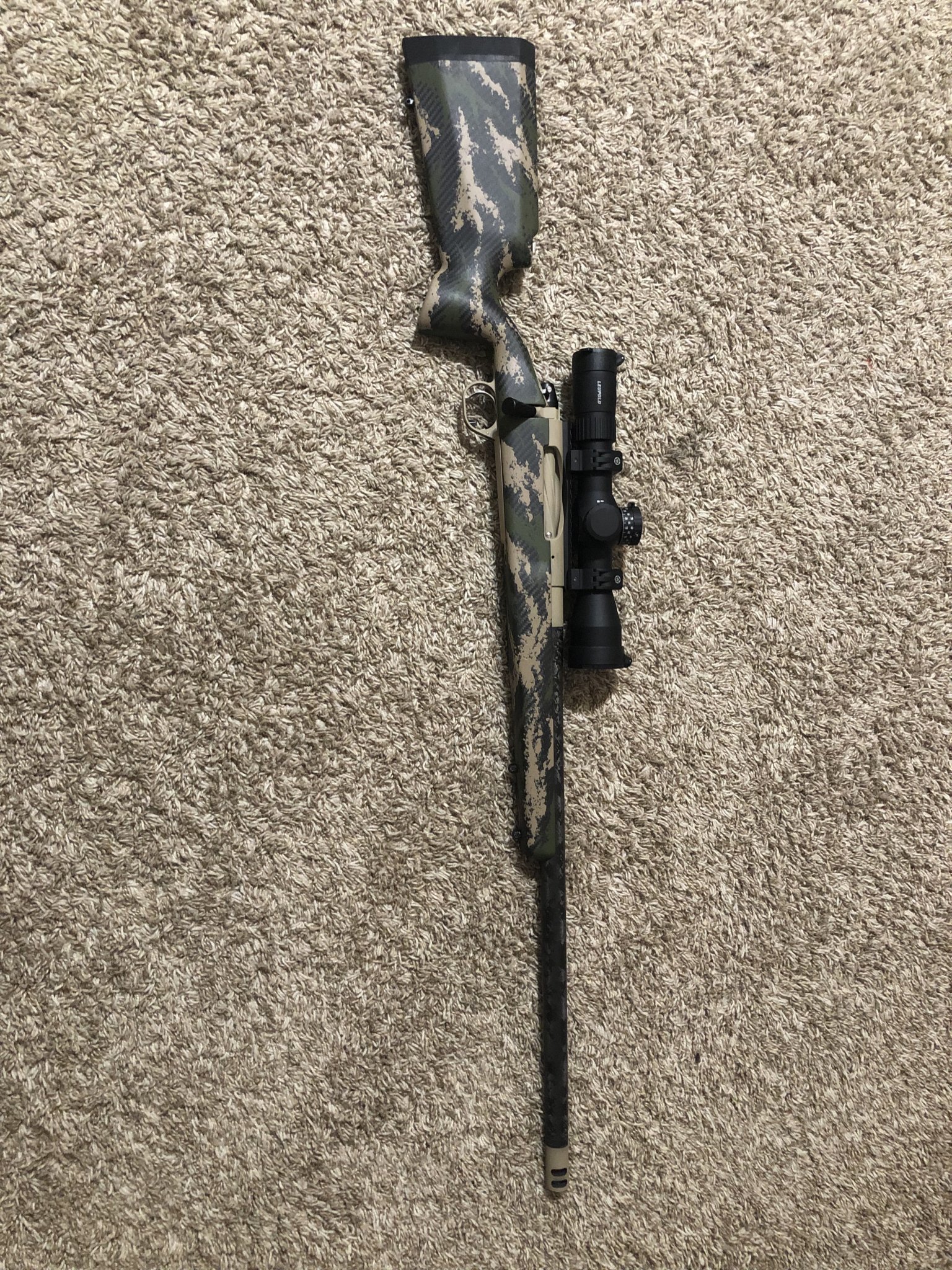

I built almost an identical rig in 280ai only using an sr3 and tt special and I have the mark 5hd 3-18. I went with a Hawkins Ti brake.
