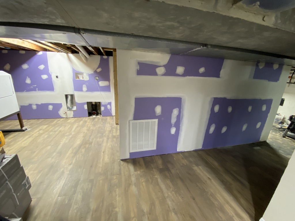

A couple of options.
1. Epoxy the holes, sand until flat.
2. Cut the area of sheetrock out and put blocking back there such as a 2x4 at minimum attached to studs. I normally do 2x6 or 2x8 in bathrooms. Then you don’t have to worry about it.
3. Remove the hanging hooks use PL530 and glue the mirror to wall so it will stay. I glue larger mirrors to the wall so they won’t fall.
4. Spackle the small holes and hope for the best.
5. Use a larger drywall expansion anchor.
6. Tear the whole bathroom out and remodel the whole thing.
Depending if its a newer home(lightweight drywall((air bubbles)) or older. Newer home at least 4” away from old anchor holes, make new holes. Think up, or down.
Old drywall 2.5” minimum.
plaster? Patch with plaster and put holes where ya want.
If you can make these anchors work they are amazing........takes a 3/4" hole. but one of them is rated for 300lbs. shear in 3/8" drywall.........several options available.......
I did something similar in one of my guest bathrooms at our new house like 4 years ago. Almost the exact same situation. Pissed me off so bad lol. I have room to move up and likely will at some point but it pissed me off so bad I just left it and avoid going in there as much as possible. Lol. But I like this picture hanging wire idea. Hard part will be getting the wire just the right length to make it level.
PS I hate that kind of shit. Like I really really hate hanging stuff. Seems like what should take 5 minutes winds up taking me hours.
Reactions: Jgunner
