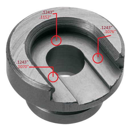

  • Decided to check if sanding the shell holder could have caused concentricity issues. Bought a depth gauge from Mitutoyo and measured three points on the deck; left, right and rear. Measured those points on an unaltered shell holder and they were all the same; .1243". There is no vernier scale on the device so I eyeballed that .0003". Sue me.
    • After sanding (as carefully as I possibly could I swear it), I had 3 different measurements on those same points; .1070, .1076 & .1152 (again with the 10000th of an inch eyeballing in the absence of a vernier scale)

The reason I was concerned about it being perfectly flat was because if there is camover, the shell holder will not engage the bottom of the die perfectly flush. I was concerned that could cause the brass to not be pushed into the die perfectly causing a lopsided/concentricity issue. Like... the actual surface the case is sitting on is still level but when the "top" of shell holder starts to get pressed against the bottom of the die, it will do so unevenly causing more stress on 1 side than the other.
