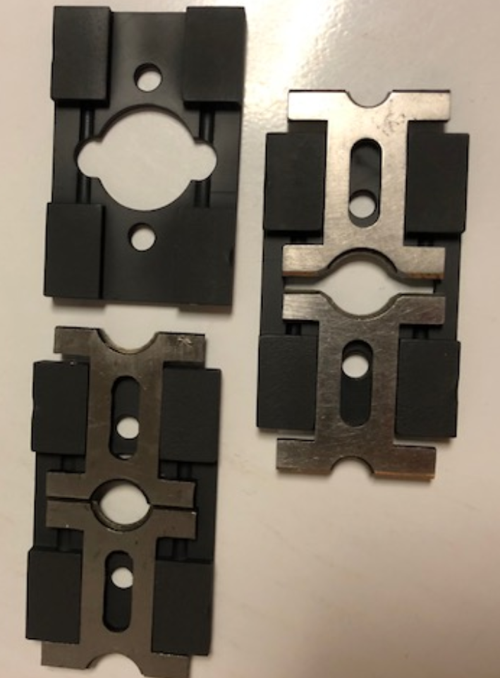

    I'm curious if anyone else has used shell holders on their co-axial press and your thoughts about how it worked. I was having problems with my jaws not opening enough for some of the larger calibers I reload for. I really didn't want to have to switch between the standard and large jaw plates, so I ordered the shell holder plate. The only possible negative thing I see so far is that the shell holders don't hold as firm as the standard spring jaws. Anyone else tried or use this setup?

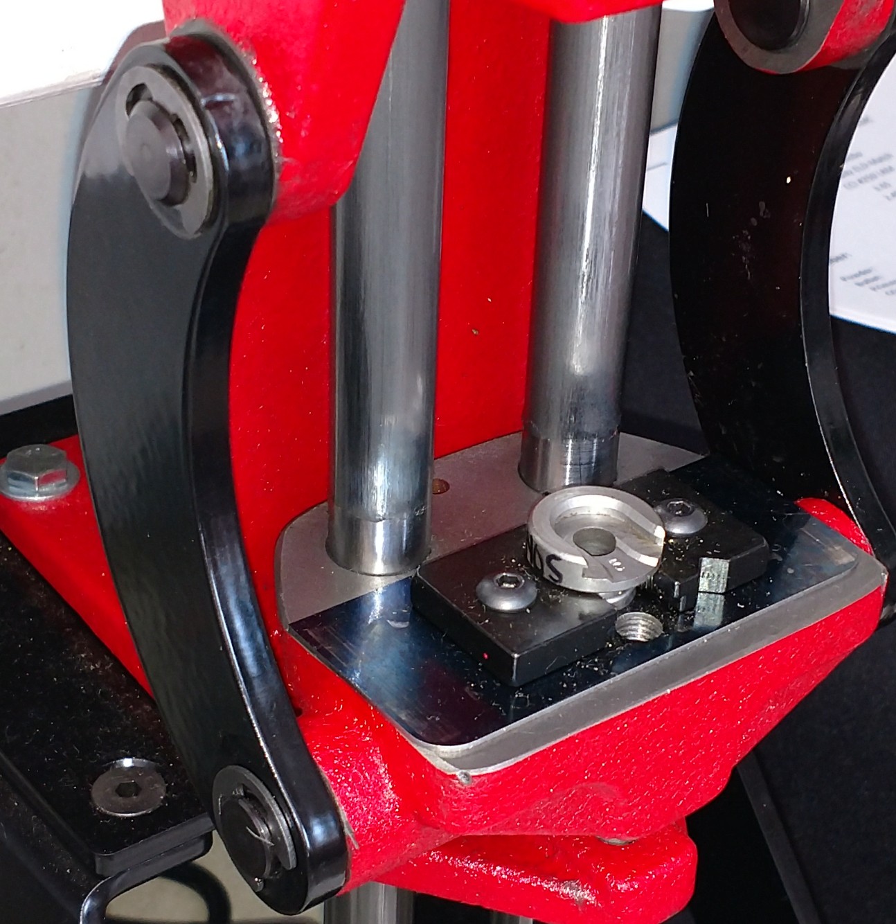

    I have the shell plate adapter for loading the 300 Norma, but I seem to be running out of room using the Whidden seating die and 230 Bergers. I have the seating die cranked out almost as far out as it will go, and I don't know if i could get them bullets seated any longer if I tried. So I ended up ordering the larger mouth jaws also (haven't received them yet) since the theory is the brass will sit maybe 1/4" lower with the large mouth jaws. I can then lower my seating die, which I need.
    A few things I did to address the concentricity concerns about free-float with the shellplate adapter in the CoAx press:
    1. I did not torque down the two screws holding the shell holder plate to the base of the CoAx press. This allows the shell holder plate to move slightly left/right and front/back as needed.
    2. The shell holder itself, as it slides into the shell holder plate, is set in place by a small set screw. I screwed that down just enough to make sure the shell holder stayed straight and did not spin as I put a piece of brass into the shell holder. This way, at least the shell holder can wiggle a little bit, but the shell holder plate is making most of the movements. I don't know if that is all really necessary, since the jaws hold the case very solid in place and the die moves as needed to be sure everything is in place.

    Pinhead, Thanks for the reply! I just installed the easy access linkages, but I don't think I'm going to keep them on. They really changed the feel of the press on the bottom end of the stroke. They almost give it a cam lock feel, not a positive stop feeling. I also just ordered another press with the larger capacity jaws for loading .300 Norma. I emailed Michael from (manzgear) and got a couple of the upgraded jaw holder plates on order. The plate on my current press is bent from pulling bullets with a collet puller. Hopefully these will be a little beefier.
