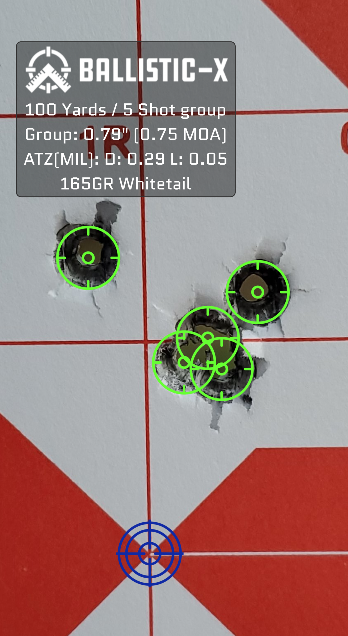

Have a 24" 300WSM 1:10 Select Match barrel that with some cheap Hornady Whitetail consistently shoots sub MOA. (have a bunch more stuff to try yet) Will order another when the time comes.
