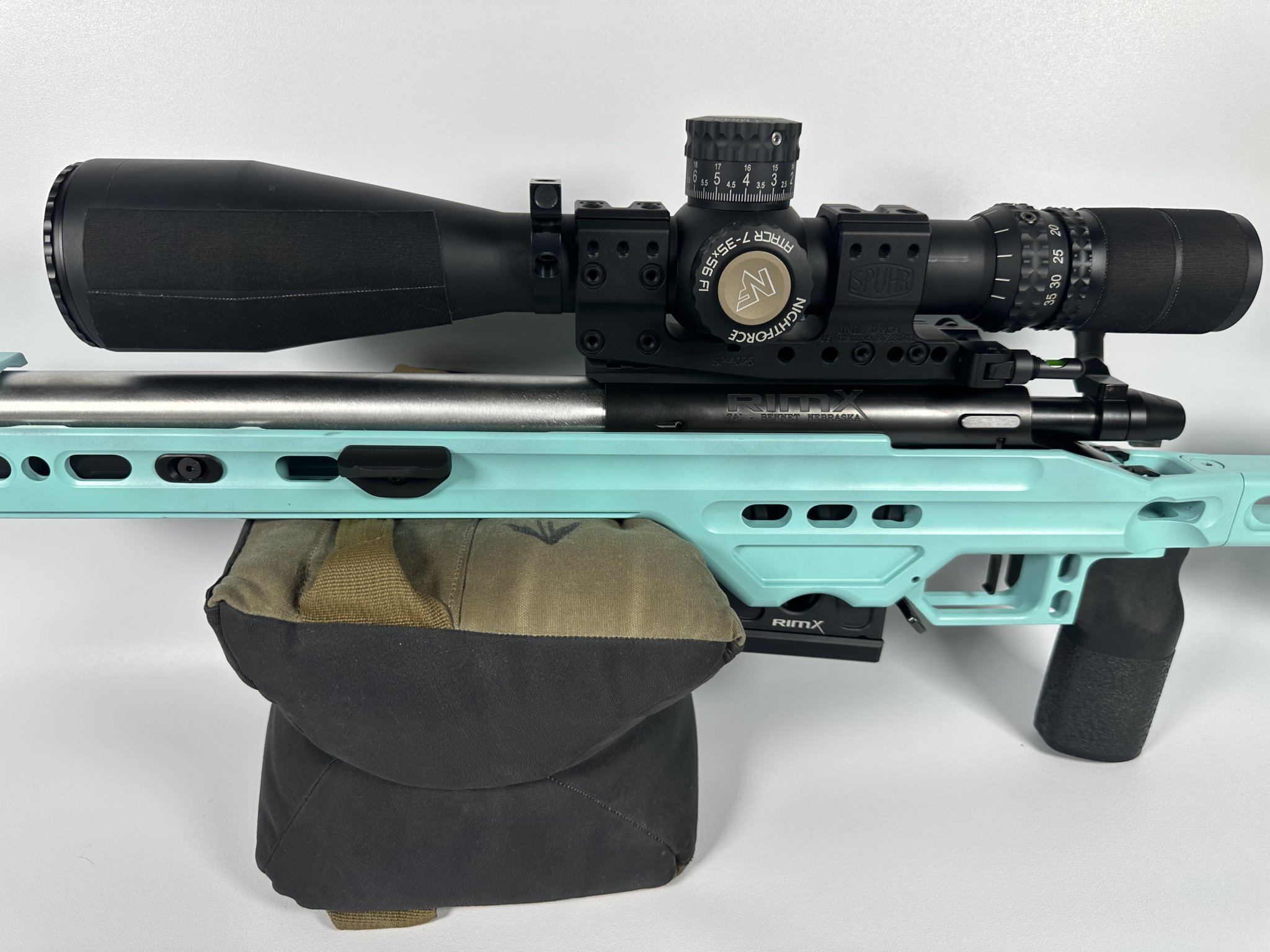

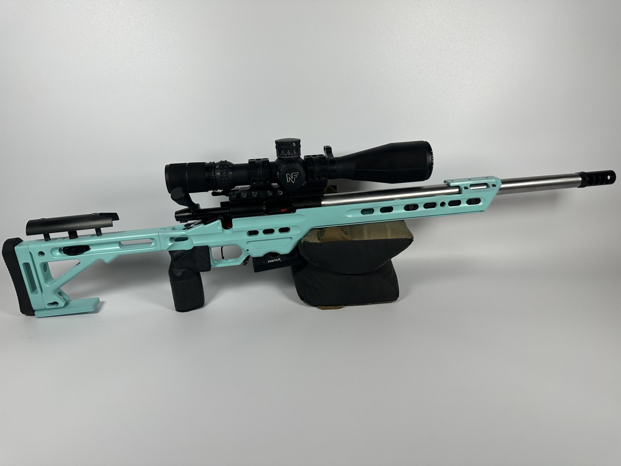

This is a new Green Mountain 20" 1.2" straight in an XLR Envy Pro I was testing a few weeks ago and really like the straight barrel..
