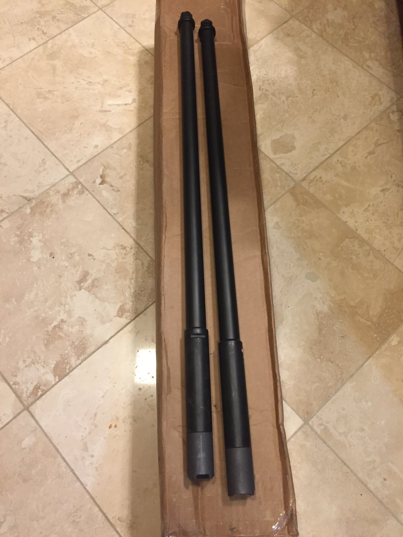

    Does anyone know how to pack stuff? I think I’m 4/7 for private sellers sending me barrels sticking out of the shipping container
    They act like slide hammers when shipped lol

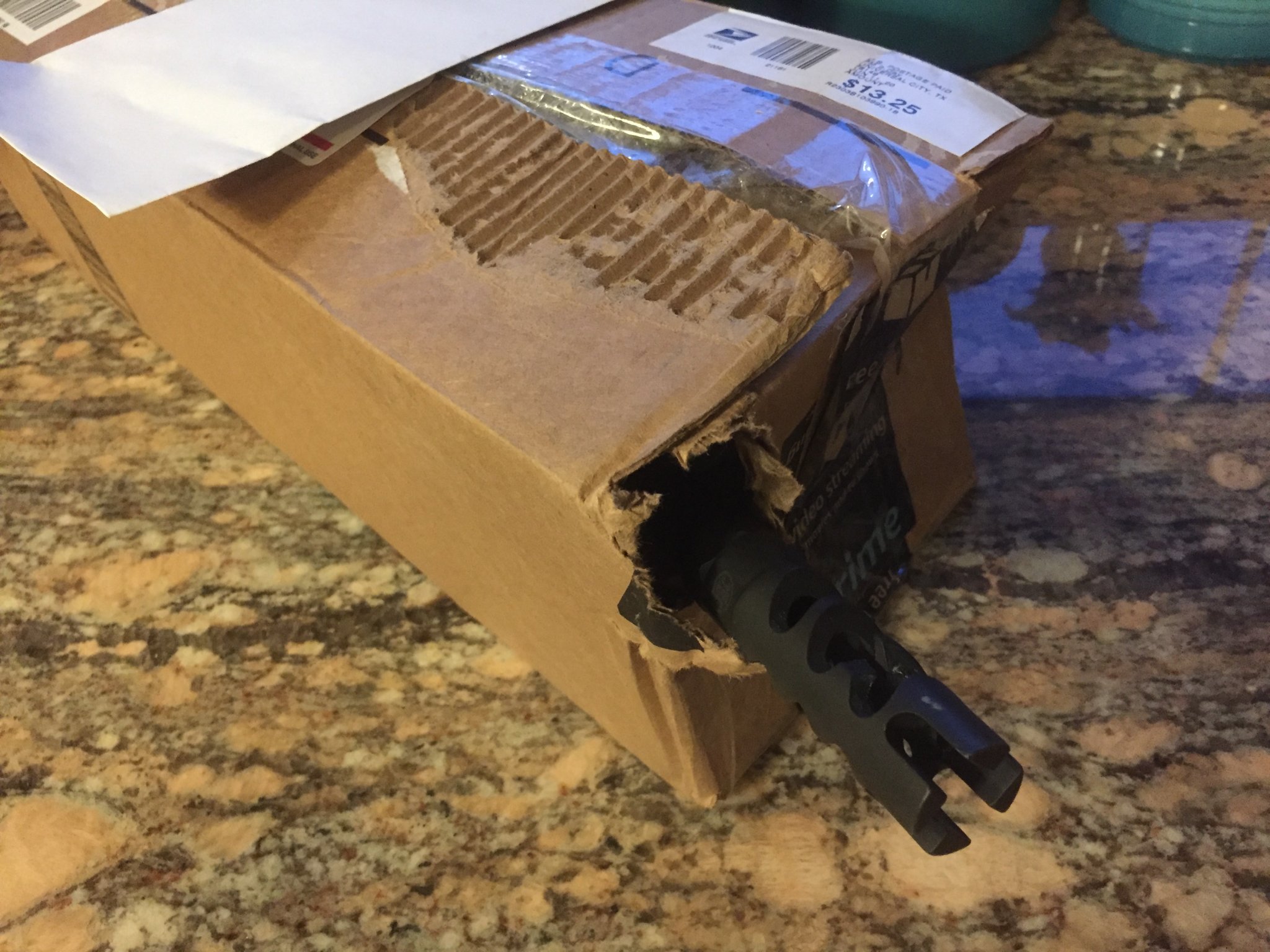

    I’ve had barrels arrive sticking out of those tubes too. Need to really tape them and or put some screws through the ends
    You gotta pack 'em tight.
    I've had close calls but only with really heavy .50BMG barrels. They were packed well but the best way to ship a barrel that big is to just wrap the barrel and cover the ends really well and slap a label on it. Otherwise you're liable to get an empty tube.
    I pack the shit out of 'em if I have to send a barrel. It ain't moving and if I don't have a box the right size I just cut up a piece of cardboard, wrap it and tape the piss out of it. I also wrap the muzzle and chamber/extension with bubble wrap and tape, just in case. You'll need a knife to get to it and it might look awful fugly with a WTF? vibe but it won't be arriving gommed up.
    Let me guess, SCAR 17 barrel? Looks like one I saw recently, just a guess.
    Love how the didn't bother to wrap the end. At all. Five stars all the way.

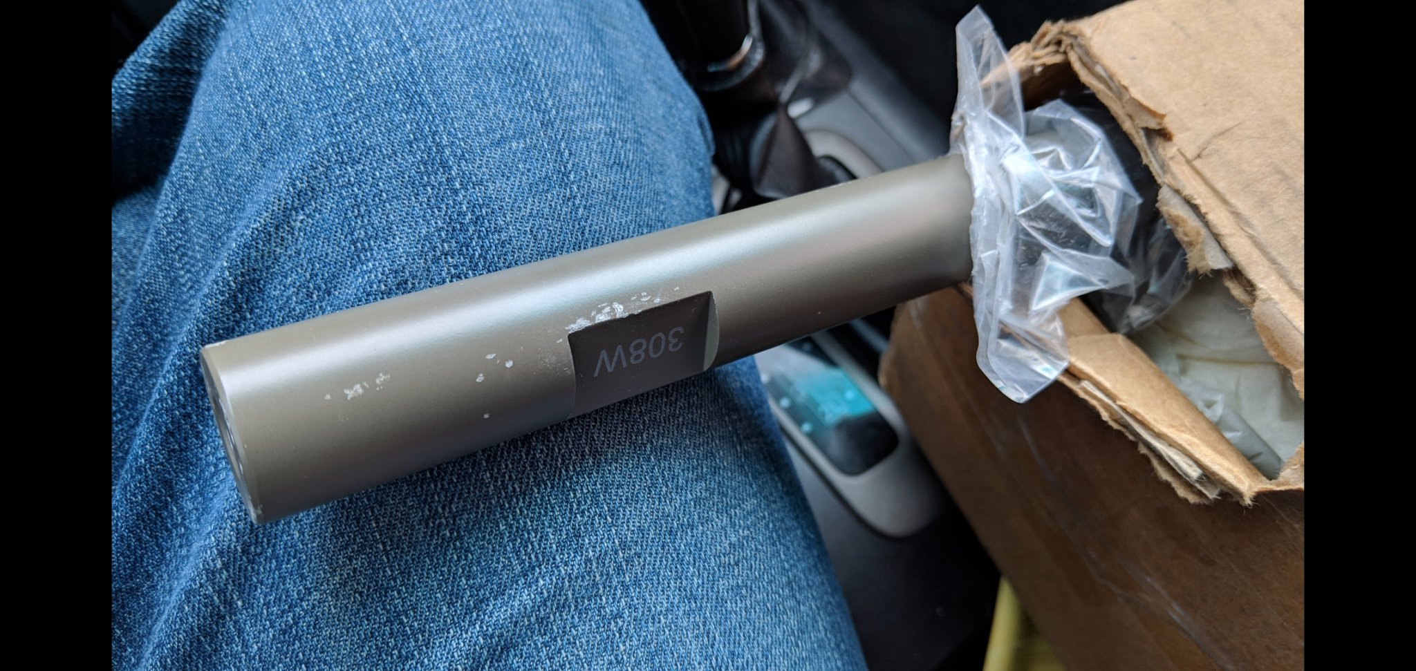

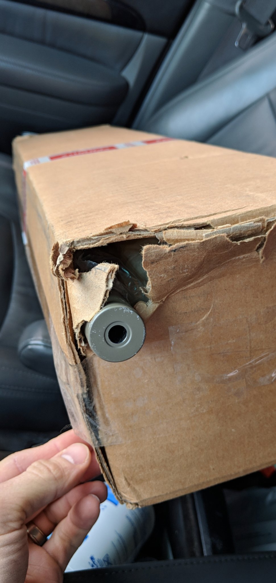

    Wow an AI barrel no less, not that it is ok on any rifle, but a AI WTF
    It never ceases to amaze me that people would risk having to refund a $100 + purchase to save $3.00 in packing materials.
