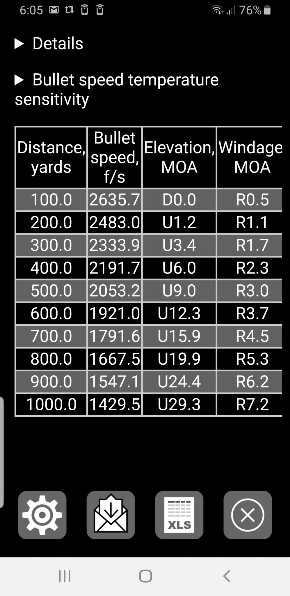

I don't shoot PRS, occasional steel and some F-Class. I have the free Shooter app. What would I gain in getting the $9.99 Shooter App. I have put the same info in a friends and came up with exact same table.
Also, I shot a fun match today and could not get my real world dope to fall in line with app. I am sure everything was entered correctly. 6.5 Creedmore, 140 Amax, 1-8 twist, 26 in barrel, I updated my atmospheric conditions with a Kestrel. No phone service to update automatically. I tried Litz data and Hornady data. My real world dope was 12.25 Moa at 600 and 29.5 at 1000. Zero is dead nuts on. My speed by a Lab Radar was 2755 fps with around 100 rounds on a new barrel. I do understand the barrel may have sped up since I am around 150 rounds on barrel now. I played with every setting on the app, sight height, muzzle velocity, bc, and more. To get my 600 yard to match my 1000 would be off by 2.25 Moa, and vice versa. I have another rifle in .223 Ackley and everything falls in line perfectly.
Any ideas on how to correct this?

I agree with ShtrRdy, tall target test should be your next step. Eliminate all the variables. I bought some of the SH B2B targets and it makes it super easy.
I think it's your app. I created a rifle in strelok with your gun and trued the mv to 2795, called for 12.3 at 600 and 29.3 at 1k.
Lots of articles on hear about truing mv then truing bc.

I think it's your app. I created a rifle in strelok with your gun and tried the mv to 2795, called for 12.3 at 600 and 29.3 at 1k.
Thanks, I downloaded Hornady's app last night and did the same and got alot closer results 12.67 at 600 and 29.3 at 1000. I can live with that
