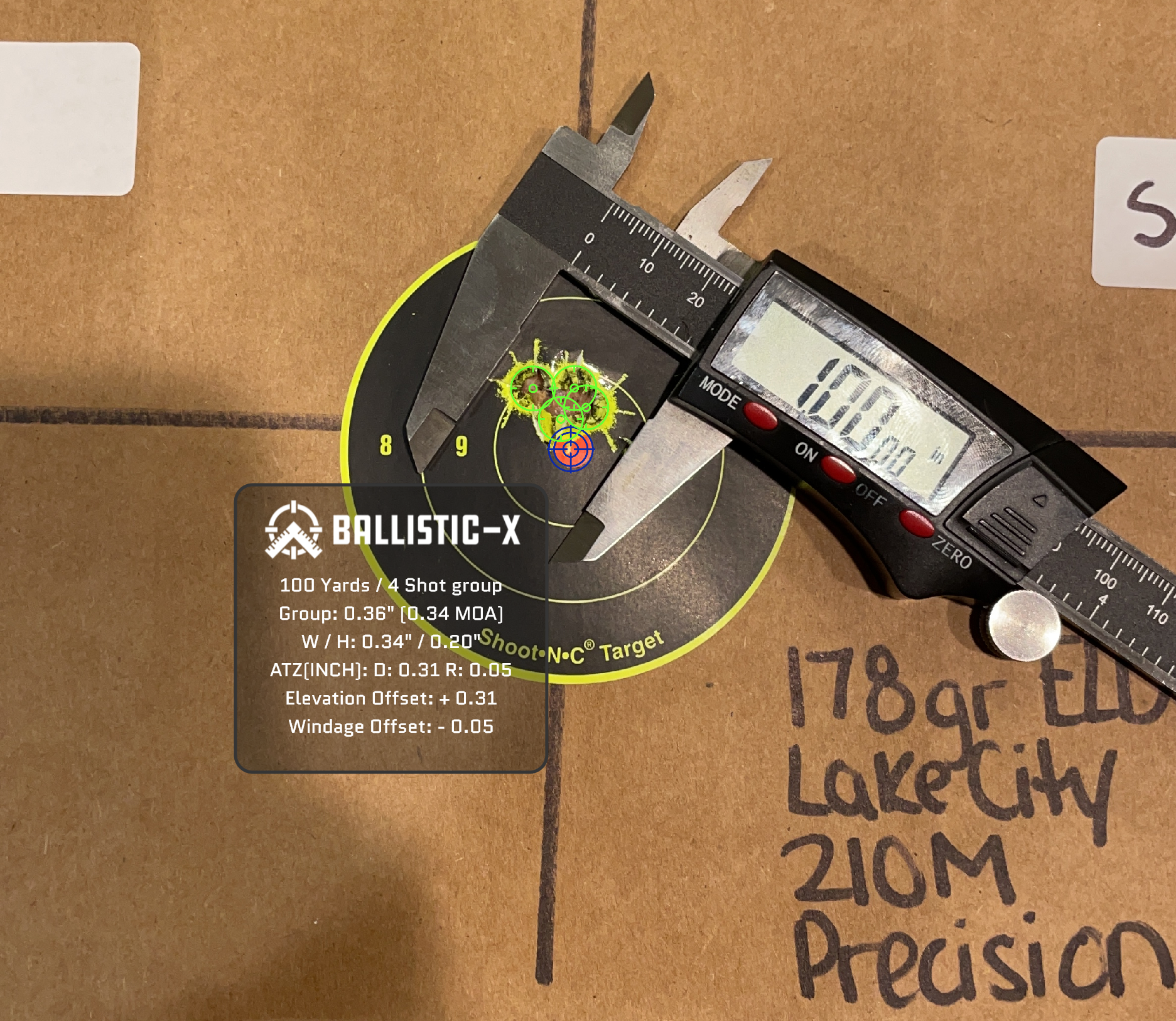

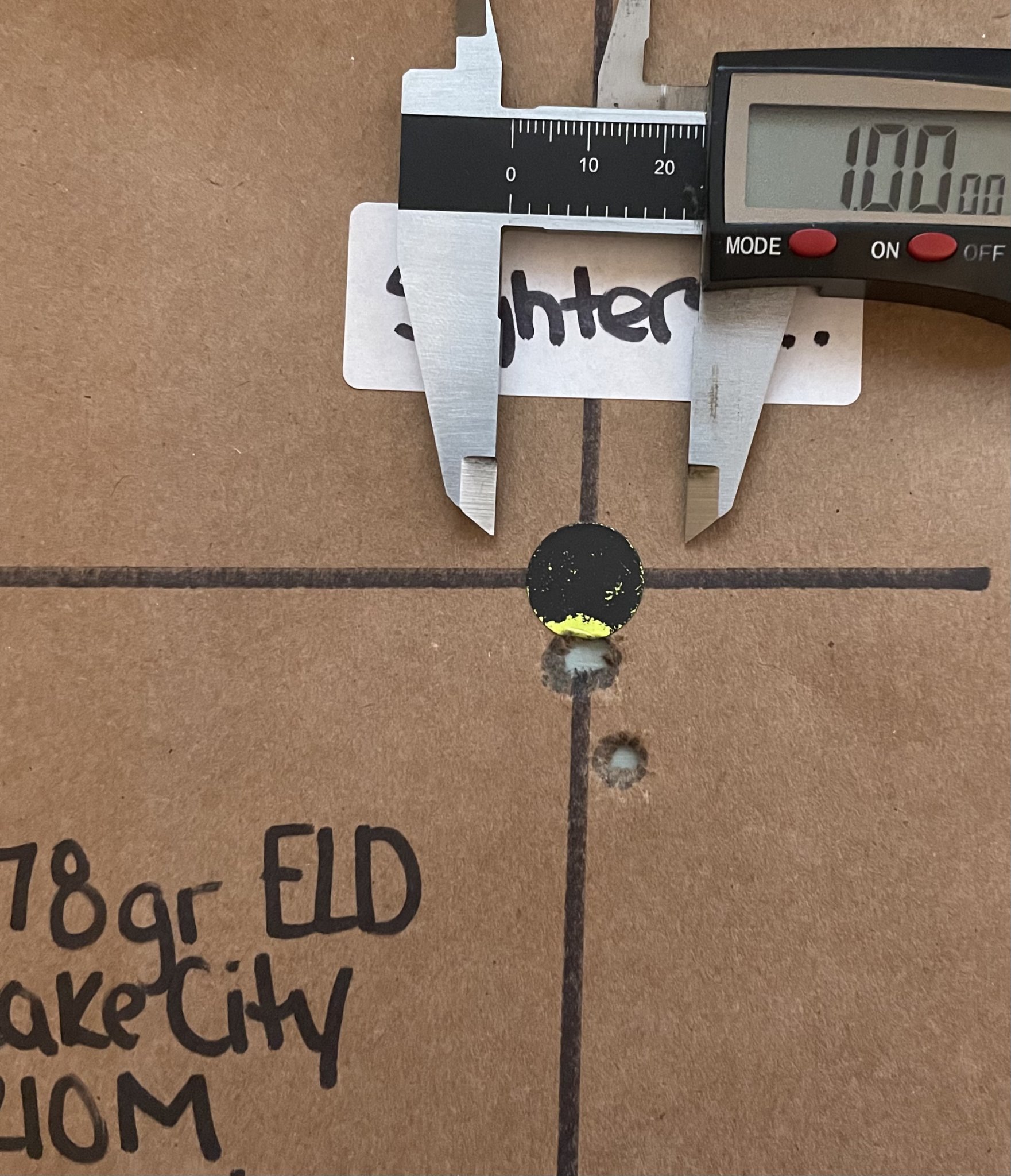

I just tried out a full load work up for my 20-inch 308 with Shooters World Precision. I loaded a 178gr ELD-M, 210M primers, and Lake City Brass and worked up to 43gr. Accuracy was excellent.
The best shooting charge weight was 42.3 grains, which yielded 2,520 fps with a SD of 7 at 36 degrees. It's a little slow, however the groups are by far the best my rifle has ever shot and it'll barely make it to 1,100 yards so going to call it good and just start loading and shooting.
That's awesome performance there!! Were you seeing any pressure signs at all with that load?
Absolutely no signs of pressure even on the higher charges. I’m guessing the next accuracy node would be just over 43 grains so I’m not going to push it. Here are the 2 groups I shot for record. The second would’ve been the best group I’ve even shot, but of course I couldn’t hold it for all 5 😂
HA HA HA ALWAYS a flyer in a 5 shot group!!! Nicely done!!!
