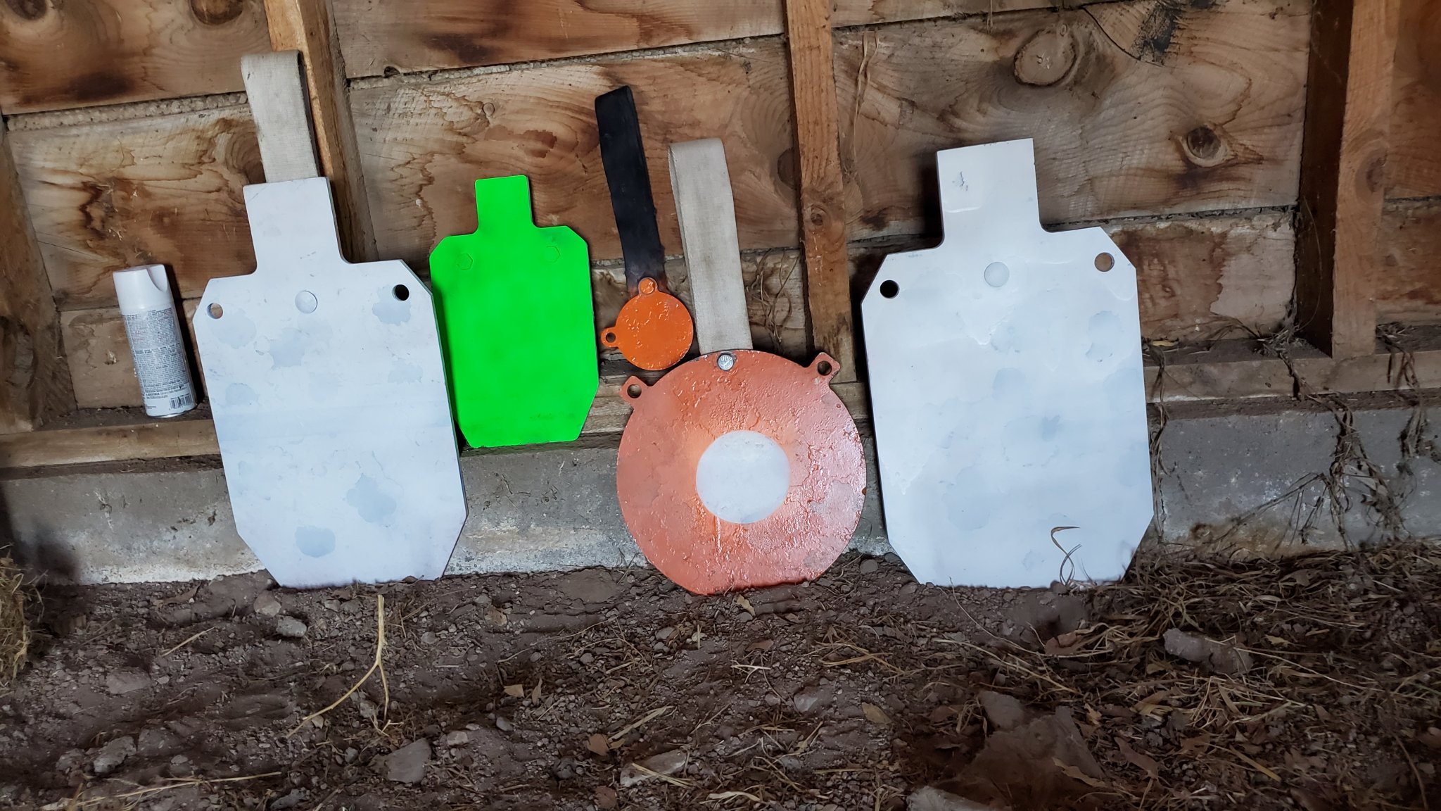

    my 33% IPSC is 7 1/2" wide so at 500 yards your wind call will need to be +/- 2 mph. i really like shooting mine. I had some calm winds winds yesturday morning, held dead center at 400y and impact was right edge. maybe 2-3 mph but not a whole lot of indicators.
    pic because we all like steel targets! and you can kinda see a good size comparison.
    66%, 33%, 4" round ,12" round & 66%
