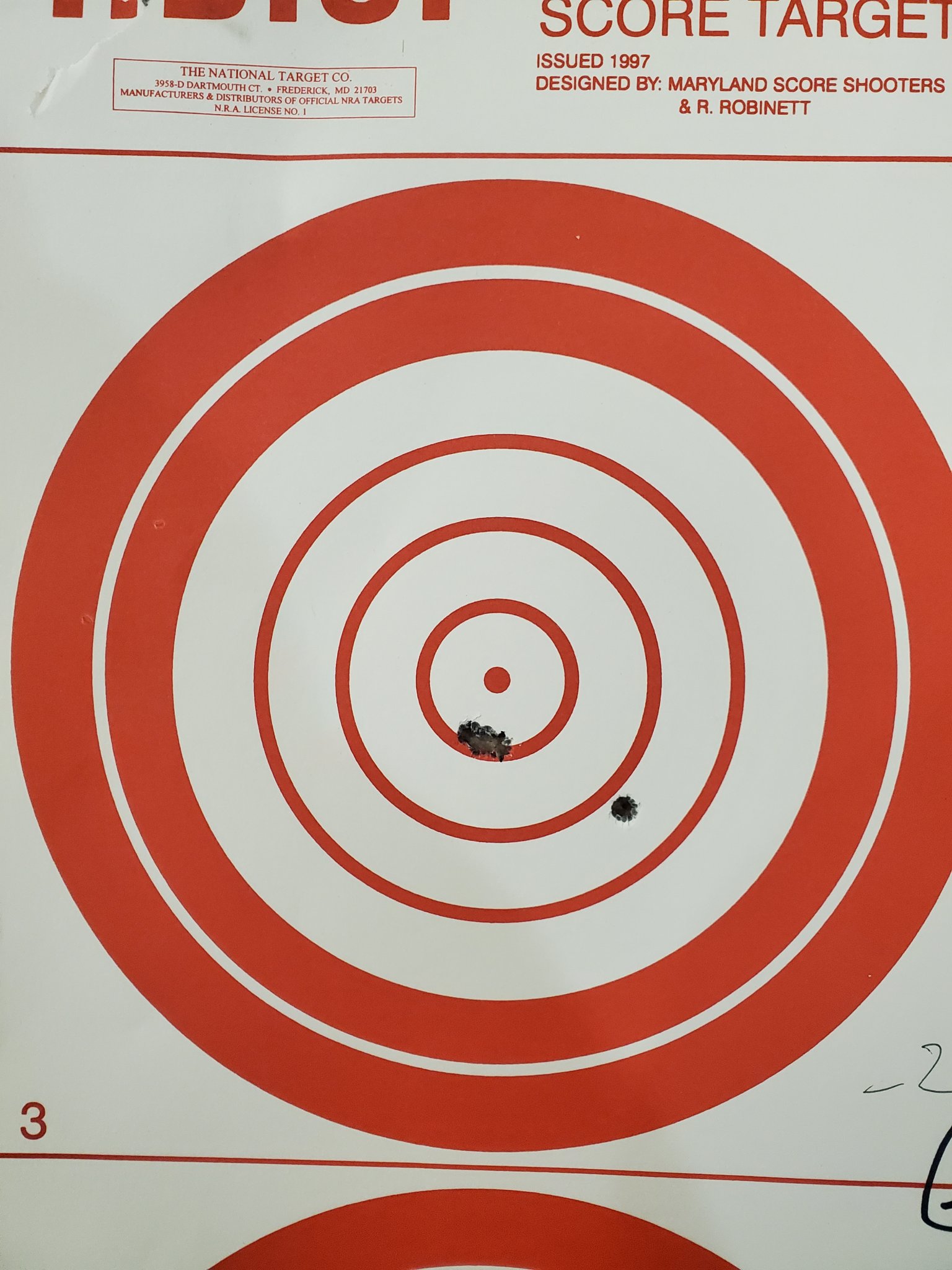

Post some pics of some targets. Maybe your rifle also doesn’t love that load. Was it developed specifically for it or is it just a load for 6.5 Creed that “shoots well in a couple rifles”? 50fps extreme spread is pretty bad…you’re looking for less than 30fps for 10 rounds, less than 20 is preferred. What kind of a 3 or 5 shot group are you shooting at say 500? If you can shoot a sub MOA group pretty consistently at 500 then it’s you having trouble just holding it together at 100.
Will do, heading out next weekend.

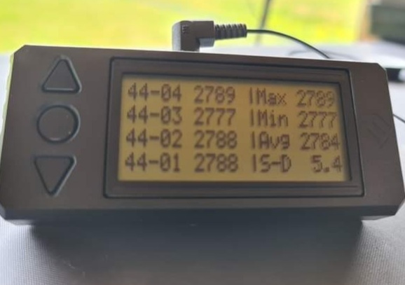

Ammo is, as you say, the ammo guys off the shelf precision 6.5cm load. I may be remembering the figures from the chrono badly but my range owner (who lent me the chrono) was impressed with the SD. I will have a dig and see if I can be more precise.
I'm due another batch before too long and I'll be taking my gun up to talk about developing a more tailored load.

I was a little out - 11fps max difference.
Lol. That’s much better. Only 4 rounds but still looks like quality loading. If your rifle “likes” that load then it should shoot well and hold together as far as you can shoot. However, despite excellent ES/SDs, some loads do not shoot well in some rifles. I’ve had that experience…kind of a bummer when it happens.
