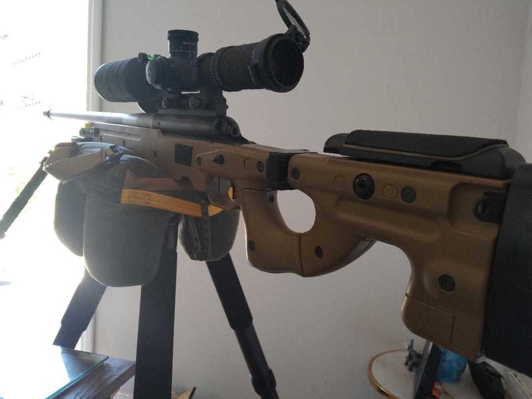

I’ve been experimenting with a game changer on a small Tac-table instead of clamping the rifle directly into the tripod.
It’s a bit faster to get the first shot off and the recoil impulse is smoother and more predictable because you don’t have the resistance of the legs/feet.
On the other hand it is not quite as stable as being locked into the tripod.

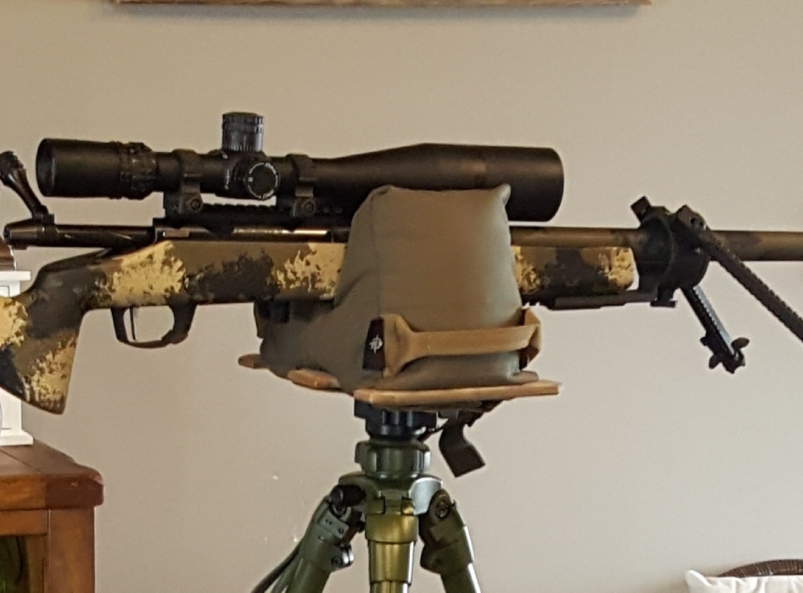

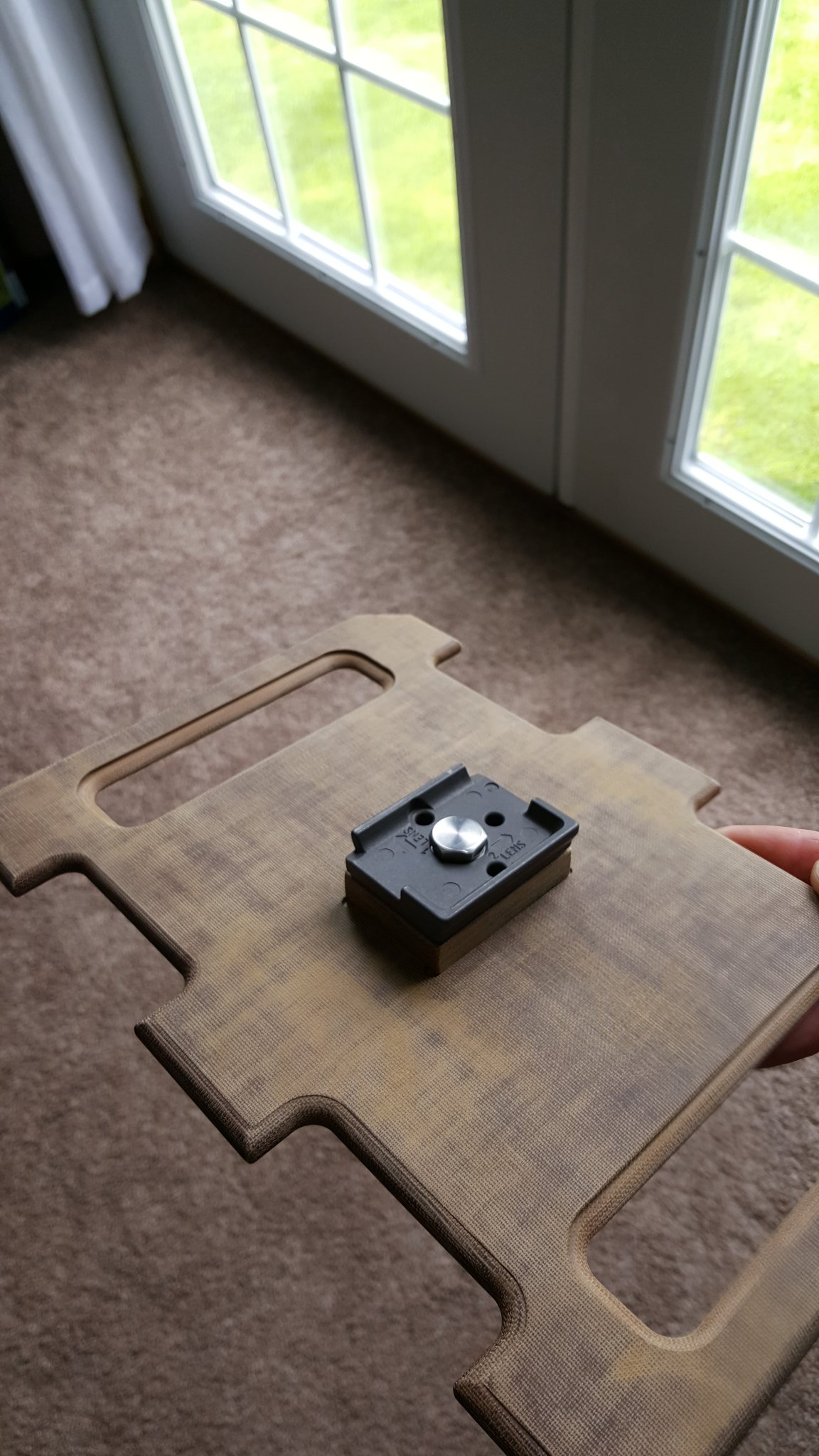

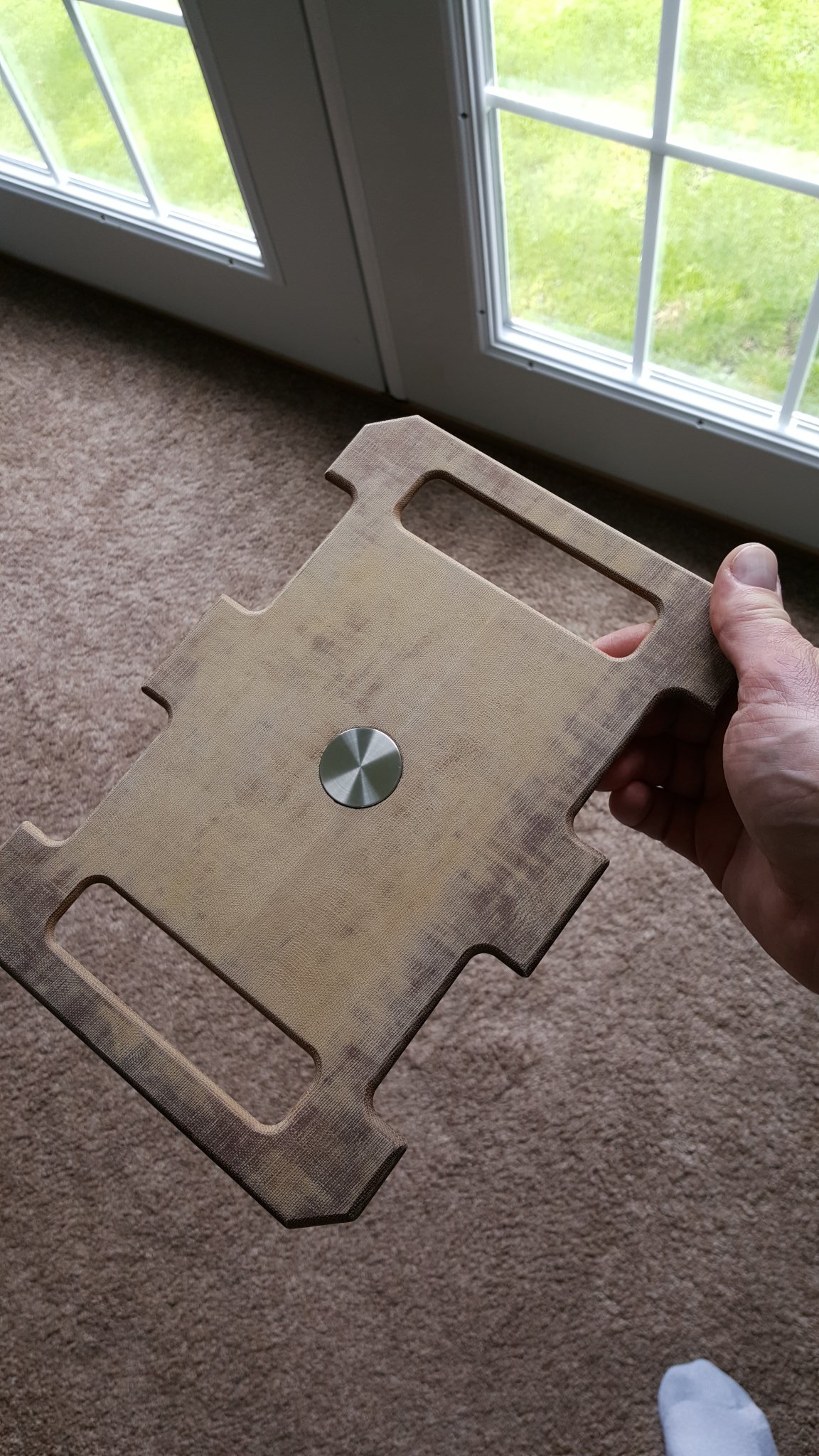

I made this plate for my gamechanger.

The only time I lock my rifle into my tripod is to clean it. Otherwise it's a GC on top of a piece of 3/4" plywood with an ARCA section on one side. Use it more than my bipod. Works extremely well. Looks extremely shitty.

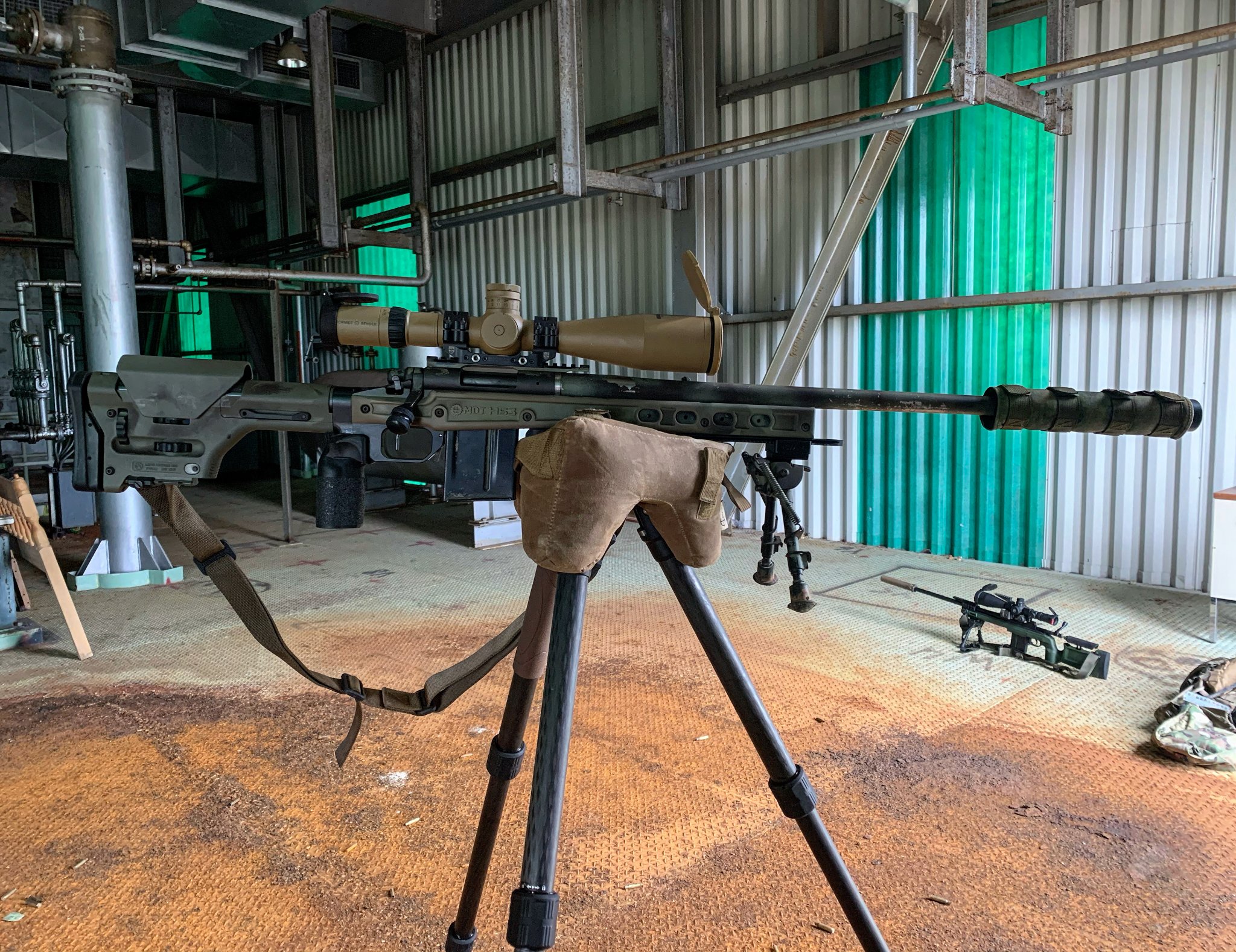

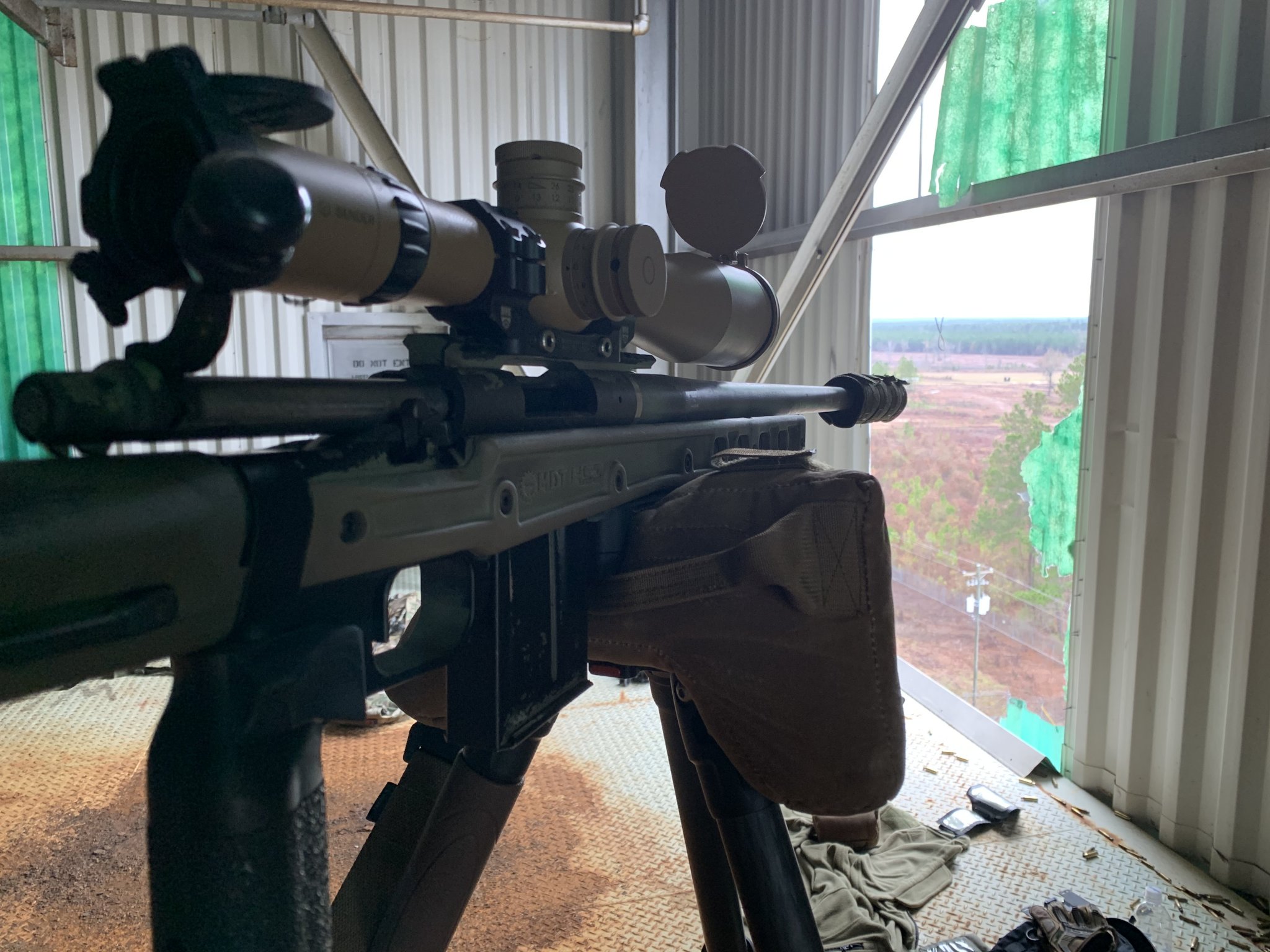

Any of the positional shooting bags used for PRS work if they will go over a cattle gate. In fact, guys in PRS do that exact thing. I think that is all the Scott Satterlee used on his hunt in Africa, I think there were several posts of his on Facebook about it.
That is how I shot my caribou this year, threw my bag over the ball head, and shot it standing. I also run a tripod for kids on the doe hunt. I show them how to kneel and how to get themselves behind the tripod. I show them that I will point the leg towards the deer and they point the rifle that direction. They learn exactly where to put one knee on the ground in reference to the tripod. After only a few minutes, we could go from both standing, to me placing the tripod and them shooting in less than 30 seconds with the .22. It proved itself as a very efficient method. Better than the shooting sticks the guy who has been doing the hunt has for years.
I put the bag over the ball head. All the kids went one shot on their does using the technique. Neither one had really shot a centerfire rifle before. I had them practicing with a .22 LR the day before the hunt, and they were drilling soda cans 100% at 50 yards. That is plenty of accuracy for deer at 100 yards.
Found the post I was referencing. This is exactly how I did it on the doe hunt a couple years ago. Heavy bag or a bag with Git-Lite, they are similar. You can't use the squishy stuff that comes in bean bags very well though.

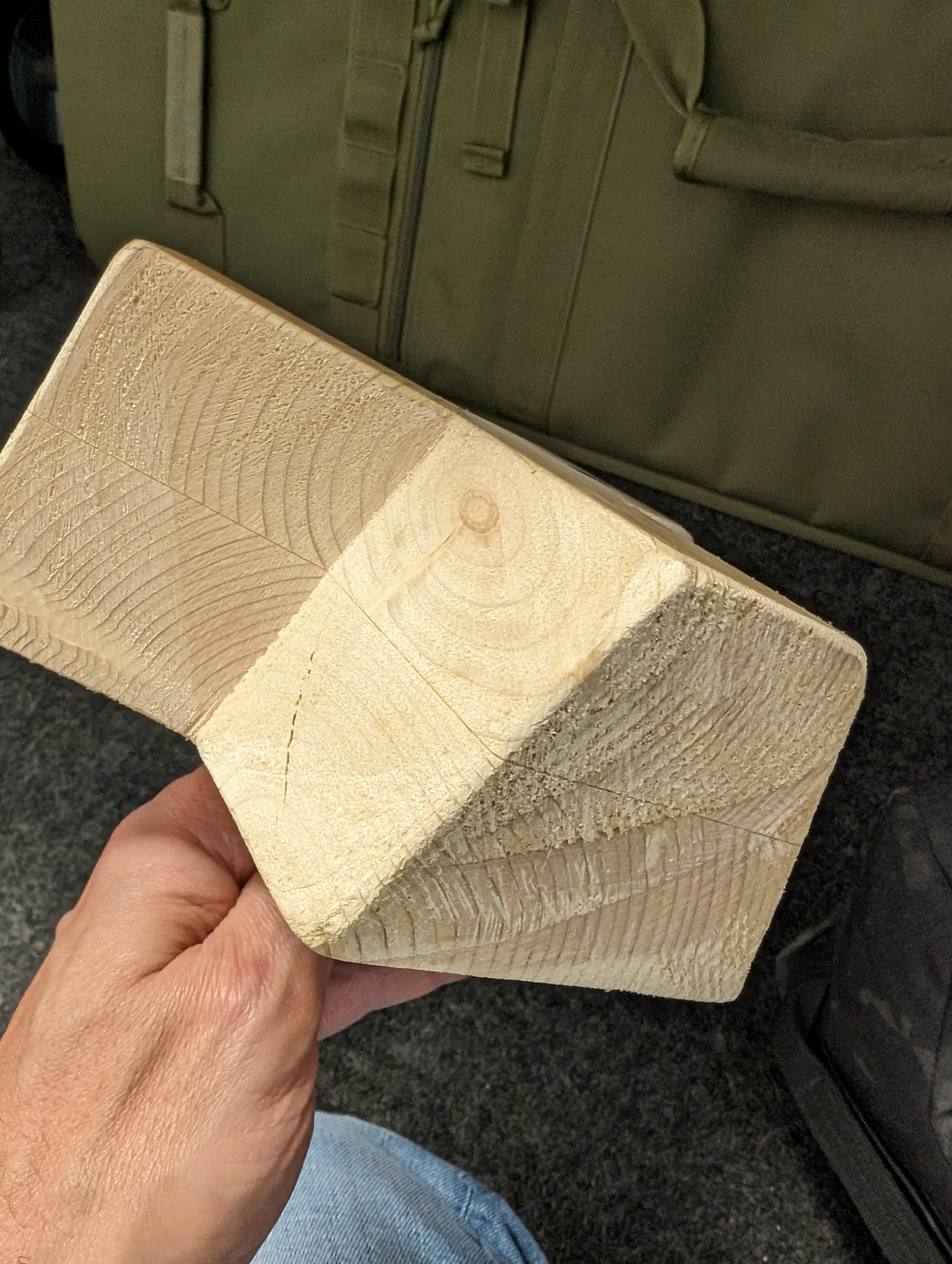

I have a Tricorne and It's not perfect for me. If I put one "leg" toward me, the balance point of the rifle is not on top of the tripod. If I put a "leg" of the Tricorne facing forward, it's better but the rear leg on my weak side gets in the way when I grab the forend.
The best for me is to use a tac table with a game changer on its side. I made a very simple table with a piece of plywood covered with antislip tape.
I also made this for the Tricorne, but the tac table way is much more stable.
