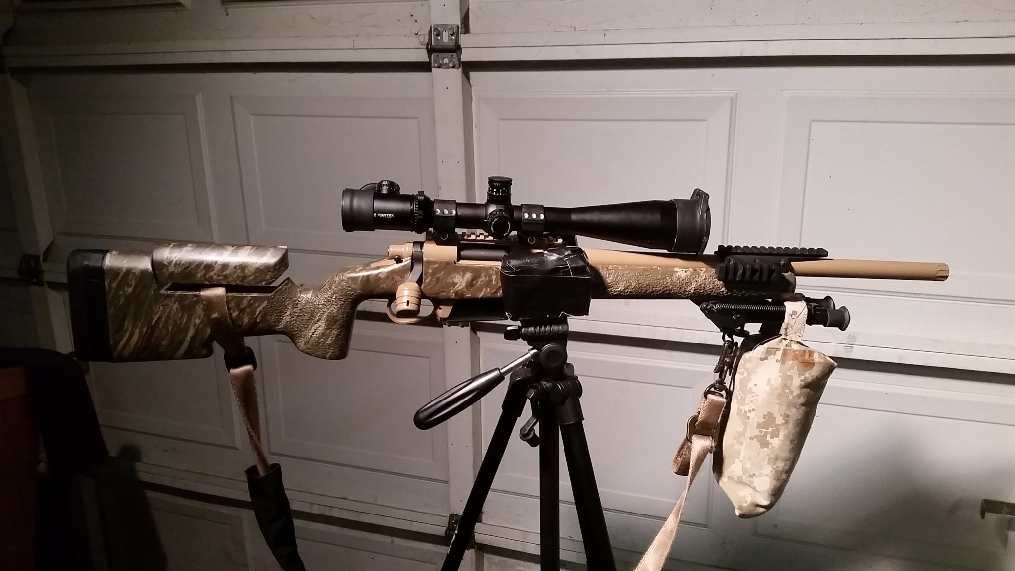

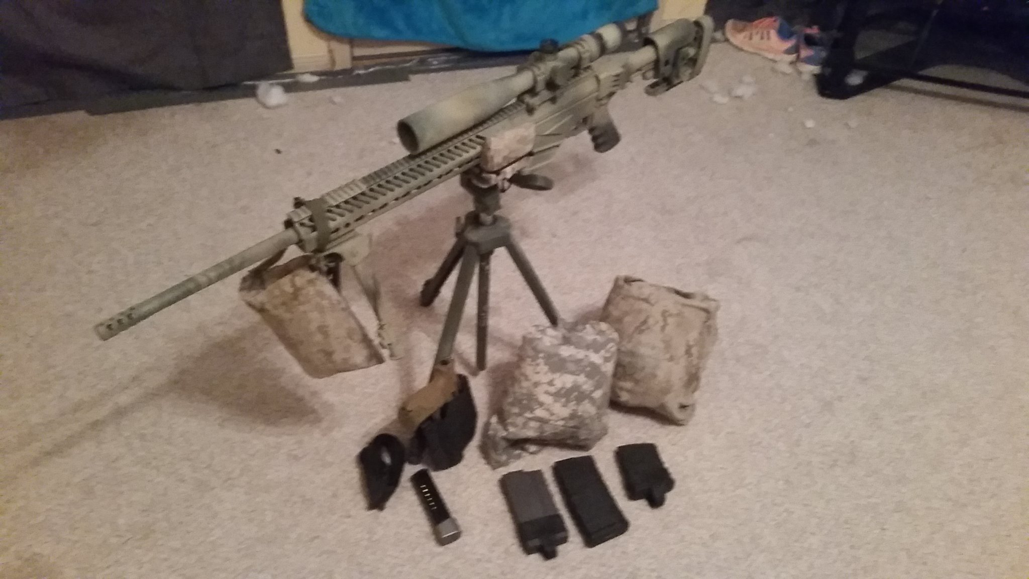

Does it for sure have the threaded bolt section coming up from a shoe or mounting plate? I found that a flush cup mount or piece of rail didn't give me the stability that I wanted and made a saddle type rig for mine. Too broke (college budget) to get a pig saddle for now. My application was specifically hunting. Used it to coyote, deer, and hog hung with success on 3 seperate rifles. 6.5, .308 and .300 winmag. Practice makes perfect, so practice the weird positions, because I have had more shots in the field from one of those than the normal sitting, standing or the like.
Setup in the middle was best for me
Please excuse the dorkyness from the last one, a client of mine asked me what my firearm kit was for extended pig hunt trips in south texas lol
