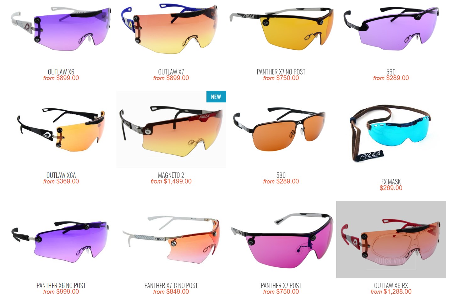

    I gave up looking for shooting glasses that don't impede the sight picture. Have tried a few Oakleys and others with no luck. The only thing I have tried that worked well are made by a company called Pilla. They are big with the shotgun crowd (skeet, clays) but they worked great for me behind a rifle. The problem is the cost. They are horrifically expensive glasses. I haven't bought a pair yet and am not sure whether I will. I can shoot without glasses and focus the scope perfectly.
    Fuck me !!! Pilla realy are $$$$$$$

    I’ve been using the Pilla Outlaw X7 with what looks to be the the Truck Kit of lenses. Primary use has been clay shooting but I also use them for rifles. They have worked well prone behind a scope. For dedicated rifle shooting I would think a high light transmission lens would be good. They have lots of information on filtering for action shooting. Yes they cost a lot but you get what you pay for.
    I do 99% of my shooting with Vermilion and Light Purple. The other 1% is yellow for night/low light shooting.
    The benefit for PRS and other style shooting is you can help make targets pop out against the background terrain. Yellow, white and orange painted targets in a green background almost glow with the right lenses. Your eyes naturally track to them.

    I've been wearing Pilla glasses for about 4 years. Granted I started wearing them for skeet an everything about skeet is more expensive. What I like about them is corrective lenses fit in behind the colored Plano lenses
    I shoot pilla’s, the Matrix are the ones I use for rifle shooting, lightweight and help when it’s real sunny.
    https://pillasport.com/collections/all-performance-glasses/products/matrix
    I used the outlaws when I was trapshooting, purple color lenses, they really helped the orange birds become more visible especially with a green background. Definitely helpful trap shooting, if you get a chance give them a try.
    I have yet to notice any distortion.
    They do a lot of impact testing as well, somewhat helpful if something was to go wrong.
    Would be interested to hear your thoughts and what model of Pilla you are using
    Like I said above, I’ve shot Pillas for a while now. Bought the first set in 2012 and have never looked back. I even use their lifestyle glasses for my regular sunglasses.
    Back when I was shooting sporting clays hard core they were essential equipment. Back then I was shooting 50k targets a year in PNW lighting conditions so the quick change lens system worked well. I never felt under gunned with the three lenses in the Truck Kit.
    They also work just as well behind the rifle which was a bonus. I just can’t understand people who spend $2-3k on a scope and won’t wear eye protection.
