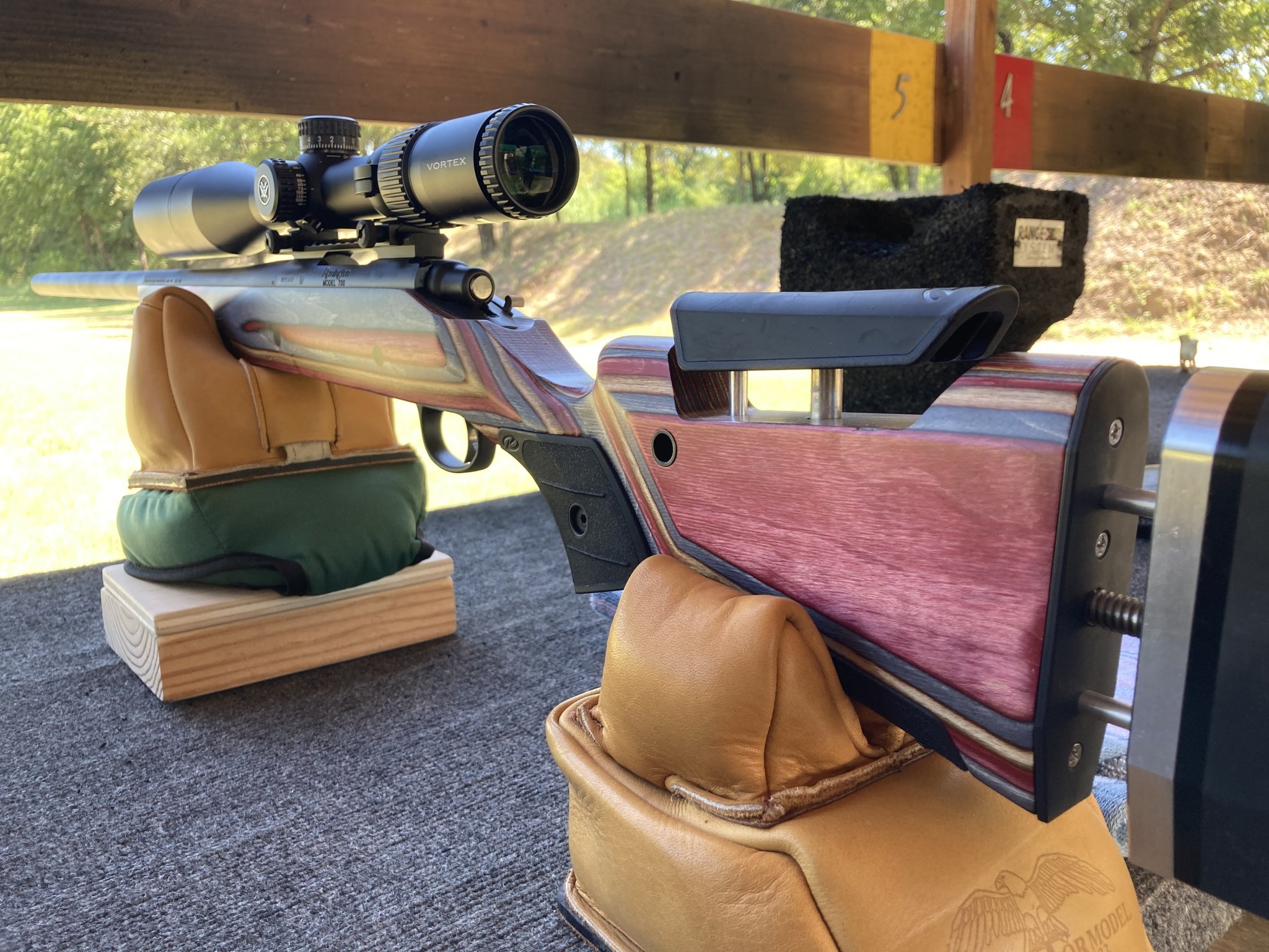

Ok here’s my “rig”. R700 ADL Varmint.308 Trigger Tech Special, Dback Tact. 6-24 Boyd’s stock.Hope nobody died laughing.
