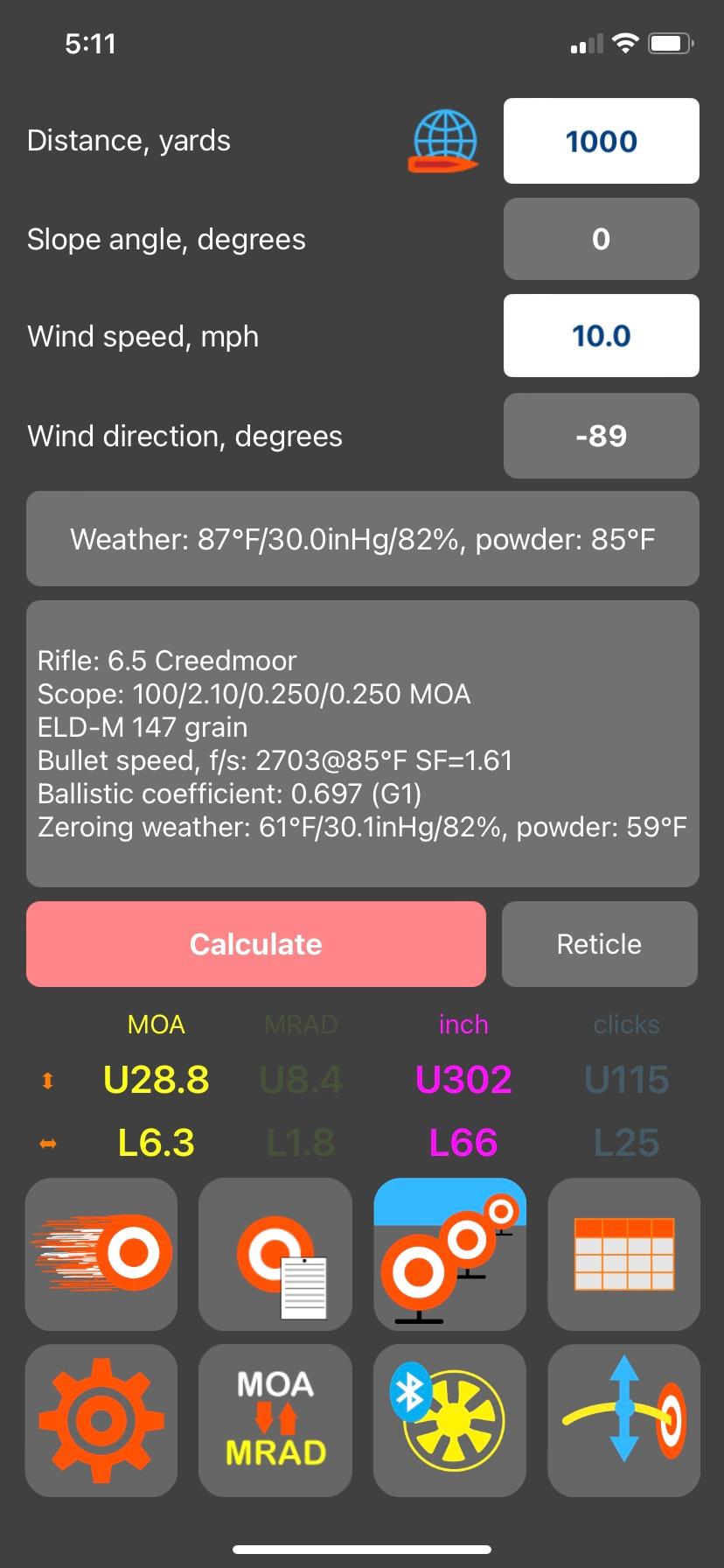

Took the 6.5's to the range today, tried out at 1000 yards, and I have been shooting low today, its off like 2 feet. Weeks prior to this, I have shot at 500 yards and all was spot on, and I think temp was in the 80's, and today temp was in the 60's. I'm using temp stable H831SC and H4350. I think it may have something to do with temps. Not quite sure.
I have input all my rifle and scope data in the Strelok Pro, I'm not so familiar with the zero weather stuff, I just purchased this app several weeks ago. Any help is appreciated.

I’ve never used strelok, but the pic you attached only shows the highest Mach 2.5 BC value being used @ .697…so I’m assuming it doesn’t apply the whole band of BCs
There may be a way to input the variable BCs for the various Mach speeds…there are in other apps, but idk about strelok
Basically BC varies with velocity, you’re currently using the highest BC, but @ 2703 muzzle velocity to 1k yds, that Mach 2.5 number doesn’t apply very long
That’s likely why it was good to 500 yds…your actual BC will likely avg out to somewhere between the Mach 2 and Mach 1.75 number

I don't think the temps are causing bullet drop of 2 MOA but I notice that your temps are in the system backwards. The top temp should be the current weather and the bottom temps "Zeroing Weather" is the weather when you actually zeroed your rifle. Most likely you will need to adjust your BC to match the rifle performance. How did you get your velocity?

I used the P35 Oehler to record velocity several weeks prior. I re-checked my data on the Strelok, you are correct, my weather is off. I remembered the weather was around 80 degrees when I recorded the velocity, and the current weather yesterday was 63 degrees. It should have some correction once I apply the correct weather, it may do need BC adjustment, possibly change from G1 to G7? Should I leave it at G7? For some of my rifles, G1 would be just fine for hunting distances out to 500 yards, would it? Leave G7 for the 1000 yard rifles? I'll redo my tests again soon. Thanks

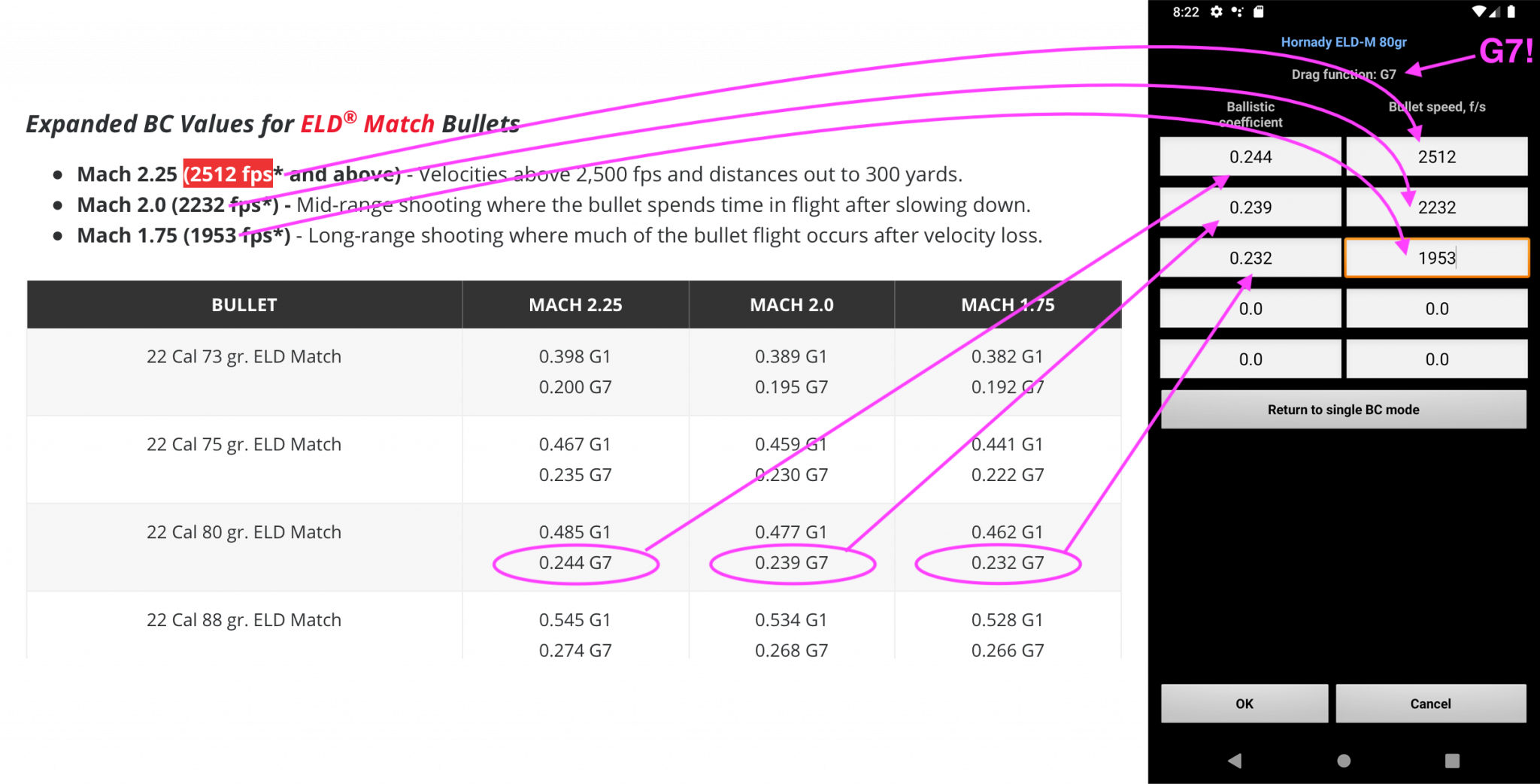

Try to use G7 multi bc values
Hornady is only manufacturer who published G7 multi bc values: http://www.hornady.com/BC
Please look attached picture how to use it
