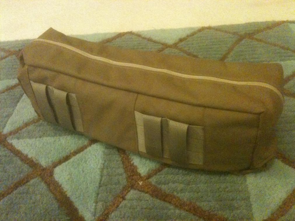

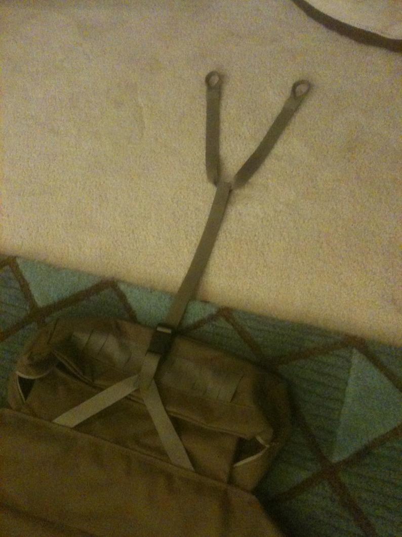

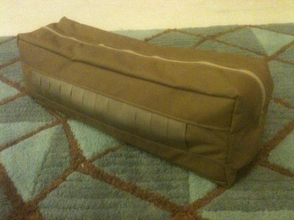

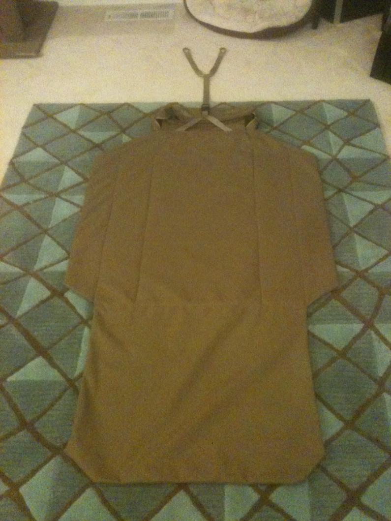

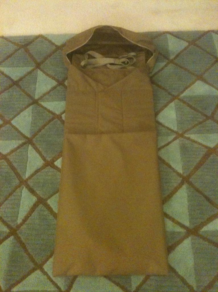

Here's the mat I made. It's attached to the case and rolls up into itself. It's 500D to be a little lighter and has a yoga mat sewn into the upper half for a bit of cushioning. I added a strap for the bipod legs to help in keep it from slipping. I have no idea if that actually works yet, I haven't tested it... I put a whole bunch of webbing on the case for multiple ways to attach to my ruck, depending on where it'll fit.

That was the whole thing that got me thinking about it. The ones we use are big, bulky, and don't get to a manageable size for easy transport. I'd done some tacticool sewing before so figured I'd give it a shot. It turned out better than I'd hoped, no snafu's along the way.

Awesome Bi-pod idea, I was trying to think of something similar for my Eagle mat/case and just used a old bag strap from my shooting bag. But yours is a nicer, cleaner way.
I am going to post up all the dimensions and whatnot. In fact I have them all written down and need to put them on the picture... I've just been slammed lately. I'll get there!

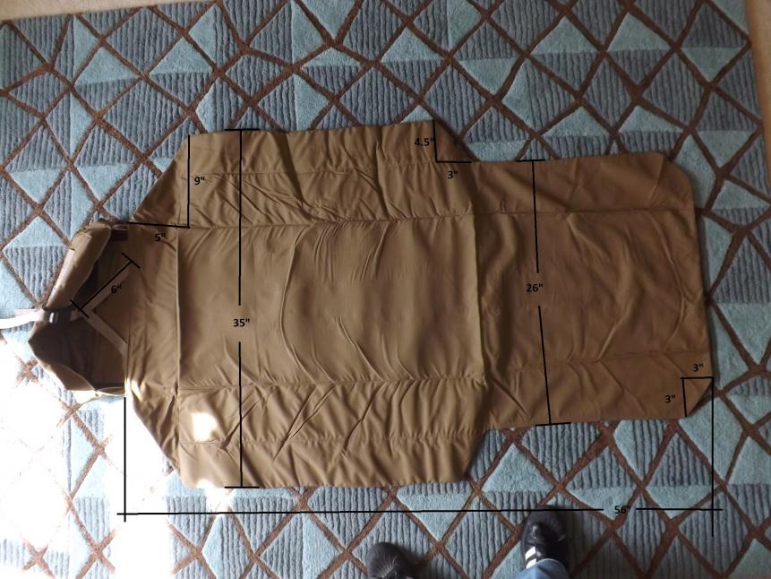

OK, so here's the mat with some measurements thrown on it. Not fantastic since I had to do it in paint... I didn't have a pattern, I just winged it along. After I did the mat I rolled it up to see the size and started piecing the case together. The closed size of the case is 5.25" high, 16" long, and 5" wide. That's from seam to seam. I added in the webbing where I thought it would work best/look coolguy.
There is yoga pad in the top half of the mat, the $10 kind from Target or wherever. If anybody wants to give it a shot and runs into problems I'd be more than happy to answer questions or grab specific measurements.
