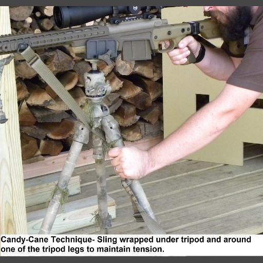

That last part of what @Sixfivesavage wrote is called the "candy cane" and it's what I prefer. You take the sling, attach it to however you mount it on the fore end of your rifle, and wrap the sling's tail around the leg of your tripod a few times (like a candy cane!). Once you've wrapped it around the leg, you wrap your weak hand/off hand around the wrapped sections of sling and you increase or release tension by giving it a little twist. I find if I'm in a position other than standing, the Candy Cane still allows me to increase or decrease tension. The other method, where you clip the sling to your belt, doesn't work well if you're in a position other than standing.
If I can find a pic of "candy caning" the sling, I'll edit my post.
Edit: Here's the Candy Cane

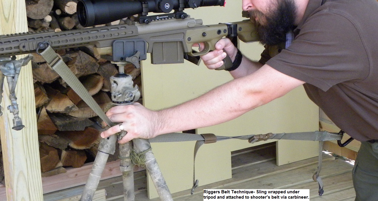

Here's the other technique, with the sling attached to a carabiner on your belt

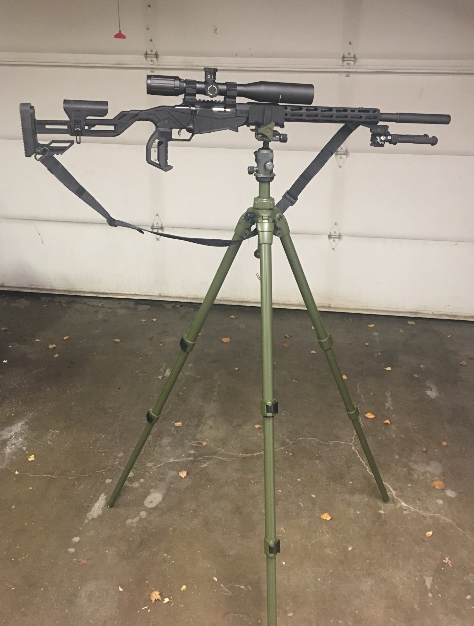

I find a rimfire trainer is great practice off the tripod. I find myself spending more and more time shooting 2-300 yards off the tripod with my RPRR.
