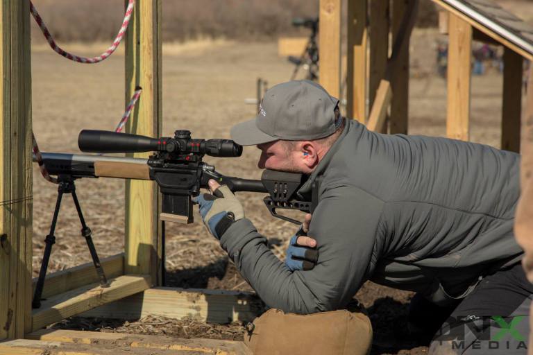

    I did much the same. As others have said a tripod or large pack on the rear really helps. But I think you’ll find more and more saying no tripod or bipod - to keep those super creative from being so. I’ve seen guys shoot under the rope off a bipod. This image is a repost of a great shooter bring really “creative”.
    I try to use a knee and support the elbow if it is a “no bag, no tripod stage”.
    Here is my practice device. I also vary the height - by extending the tripod. The tripod in the picture is just for the practice device. (I made the opening a bit to small so 1/2 the battle is just getting the gun in.)
    Btw if you free-recoil a rope forget having any idea what happened.

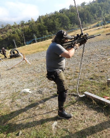

    In the above picture of Jake shooting over the rope, the rules said you couldn't have your bipod touching the ground - which is how he got creative - it was a great way to game that part of the stage. He shill had to shoot like the rest of us on the other parts of that stage - on the ropes above, and bars to the right :). If I had thought of doing it that way, I certainly would have done it as well ;-).
    Reactions: JOrisman
    :) He is so damn good either way
    Me too Fred! That was a great match and glad I was squadded with you!

    Going to take a wild guess and say the rope is attached via one point in away that it hangs vertically to the ground. Gym rope style perhaps?
    Cheers
    Pete
    Perspective is everything. I hadn't thought of that.
    I've shot off a swinging cattle gate before.
    I shot it like shit, but I pushed the rifle into the ring on the gate to try and stabilize, but it didn't work well.
    This may work on a hanging rope also.
    The rope can't be linked to an object on one end and free on the other end. That would mean one end of it is laying on the ground.
    You need to explain this setup in a way that makes sense.
    Just open my avatar and see me trying to survive that stage shooting a 19 pounds desert tech SRS 6.5 cm...
    it is my nightmare since then

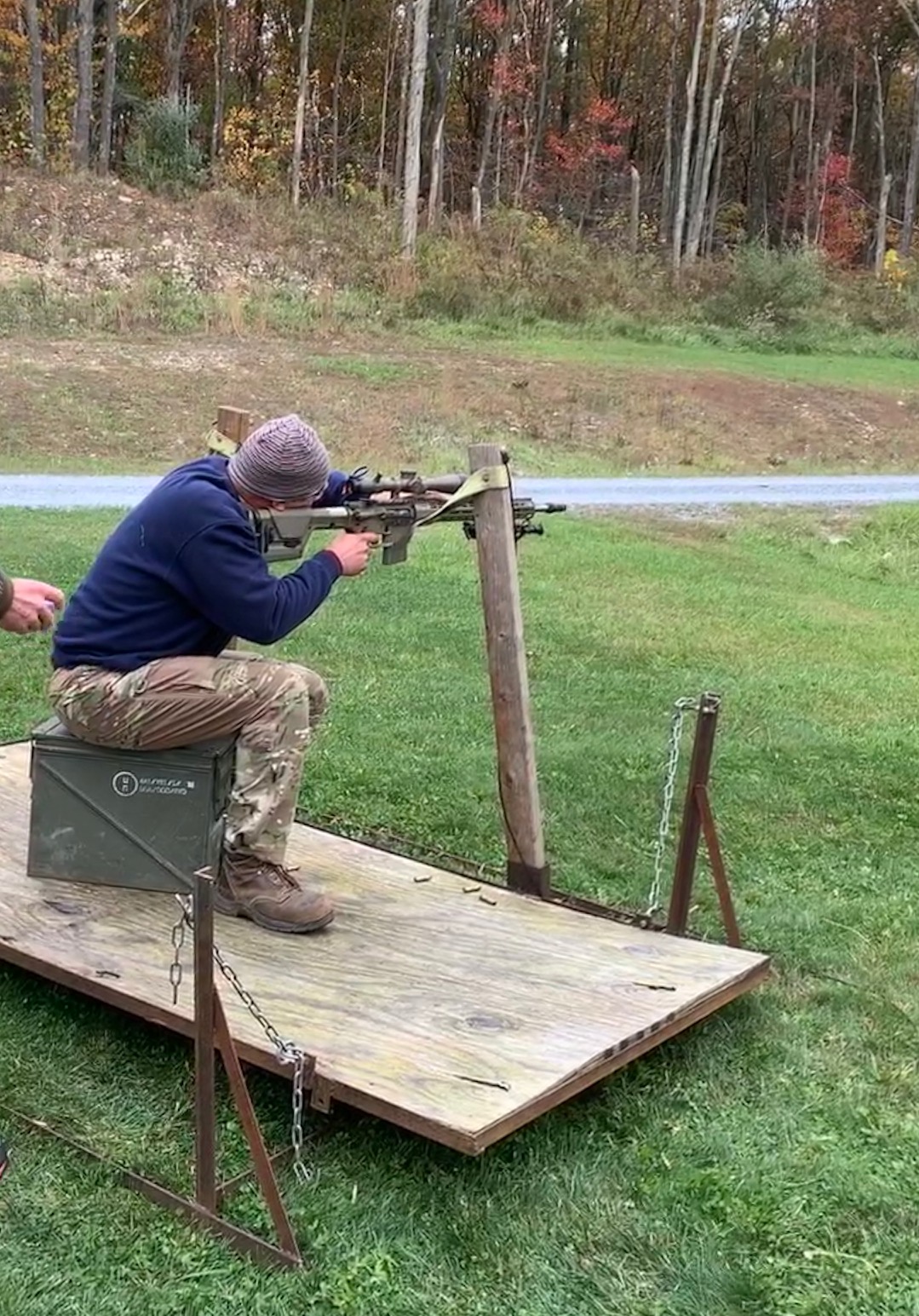

    This match was fun.
    The rope stage.
    No gamer shit (bags or tripods). Sit on Ammo can & shoot off rope sitting on swinging platform. Targets near and far with berms 100 - 300 yds behind targets (couldn't see shit if/when you missed). If I remember right targets were about 275 & 450.
    My takeaway was mag down to about 6-7x & I'd have had an easier time with 55 gr .223 vs. 175 308
    Not me shooting, he had .223 as did most.

    Hi,
    So, question....what was in the COF manual in regards to what could and could not be done with the loose end of that rope?
    Did it require the loose end to remain on the ground?
    Did it leave it open to the shooter to determine what they wanted to do with it?
    Sincerely,
    Theis
    the cof was open, tripod allowed

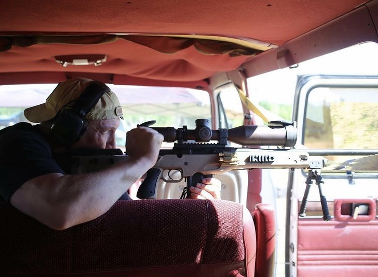

    They key is......like with any positions, you want to have as much contact with the ground as you can. If you can use a tripod, then o like to rest the front of the rifle near the end of the hand guard on the rope and then the tripod under your but stock.
    this first pic was a few years ago before all the railchanger shit came out. Shot it out of a van. Rested front of rifle on the strap and used the seat rest and a pump pillow for rear support. Was very stable.

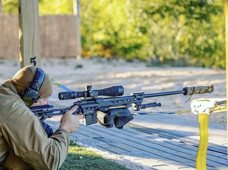

    this picture was this last fall (2020). The strap was just high enough that you couldn’t really get prone, even for a tall guy like me (6’4”) so I used the railchanger with the schmedium bag on the strap and my pack as rear support. As someone mentioned above, the heavier sand filled weighted bags work well from the gravity pulling down the strap and taking tension out.
