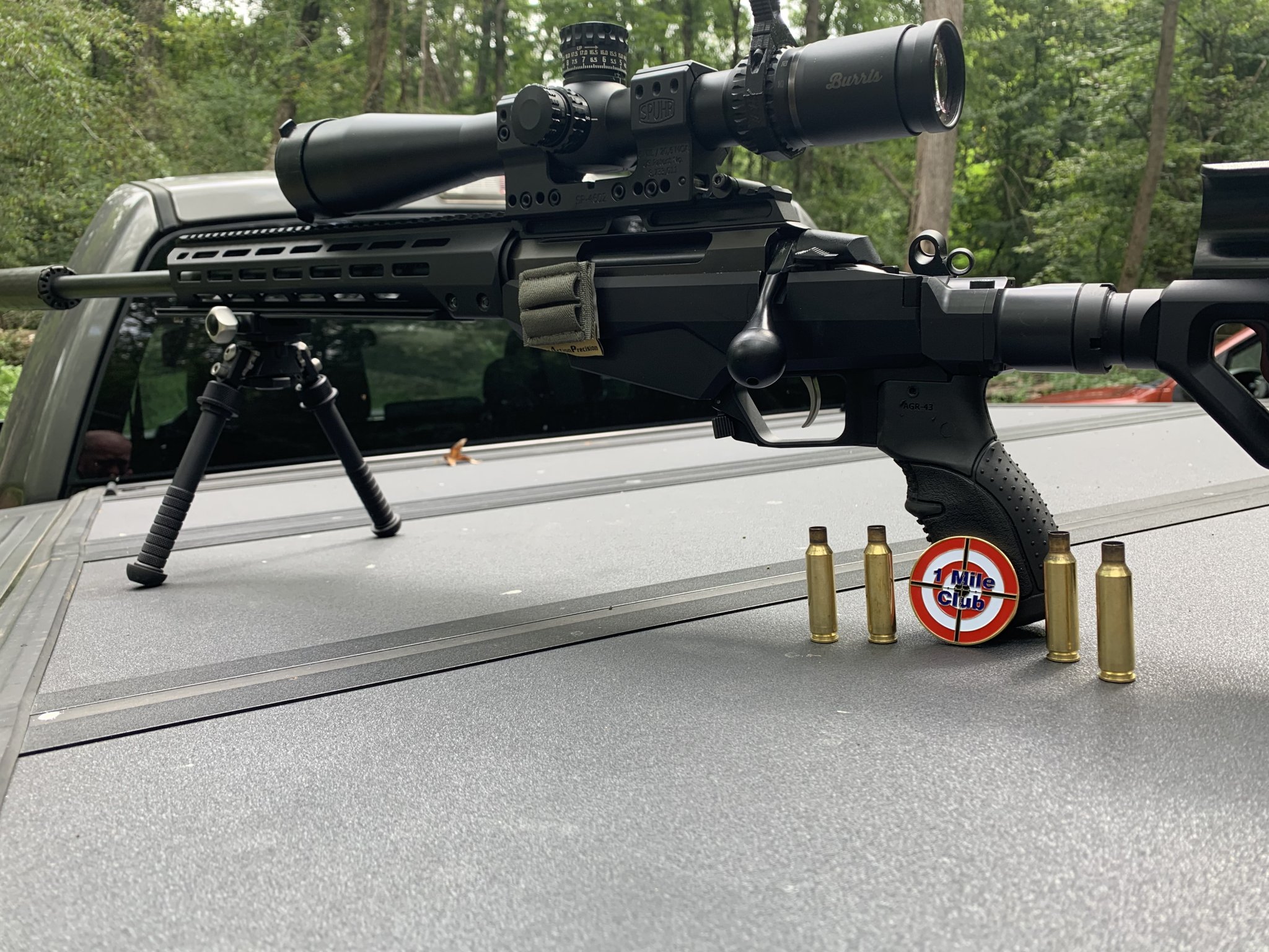

    I'm no Carlos Hathcock, but I've done this twice with 6.5CM. Most recently August 25, 2019. Clinton House Plantation in Clinton, SC. I don't have my notes in front of me for weather, but I don't recall it being particularly warm.
    + ~26Mils
    140gr ELD-M
    41.5 RL-17
    Tikka T3x Tac A1. The only mod is a Sawtooth ARCA rail bolted on for the bipod. Burris XTR-II 5-25. I ran out of elevation and had to hold ~10 of the 26mil I needed. Wind was funky that day, the range goes through a what is basically a power line cut, then across a 2-3 acre lake then the last couple hundred yards are a meadow. Ended up holding pretty much dead on for windage.
    4/10 hits on a 2'x3' (Edit: I'm pretty sure those are the dimensions, I could be wrong) steel confirmed with Magneto flasher. This was part of a "Mile Day" that Clinton House puts on every so often. Mike Sexton was on the spotting scope and managing the shooters that day.
    rough figures:
    $1700 Tikka
    $300 Spuhr
    $850 Burris
    $200 Atlas
    $100 rail
    $3,350 plus ammo and a bag. Oh, and the Omega.
