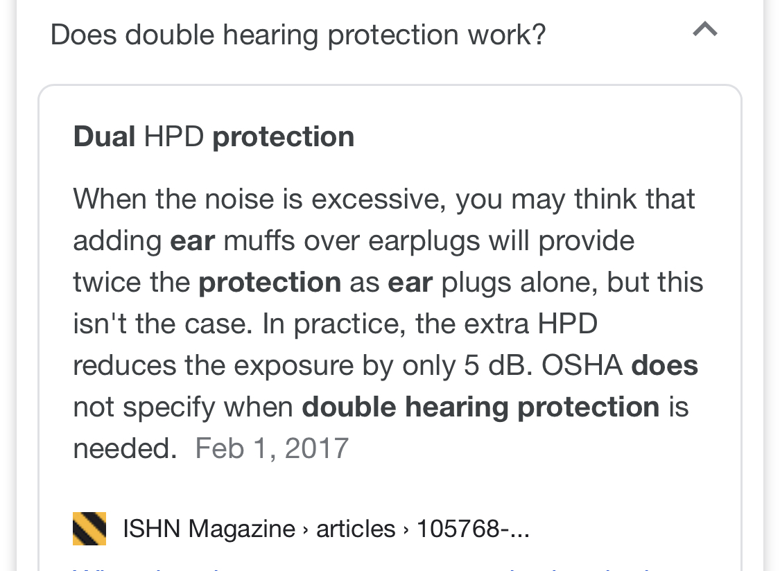

No it won’t actually the dB reading is the sounds vibration level. They do not have a stacking effect, I’ve had many safety meetings and classes on this very subject. I just threw out some numbers but the difference between dB 35 and 40 would be 5 bd. But they both combined still only offer the lower dB protection factor of 35 bd.
I would also like to see some data to support this assertion. All of my past experience and reading on this while working on safety standards for companies say contrary to this. I especially cannot buy that doubling up actually reduces effectiveness. Without supporting research and data for this opinion I can only conclude that it’s BS.
Okay, so a quick search brings up where you got the 5db, but you are interpreting it incorrectly.
As you can see by simply reading the above, doubling up reduces the exposure by 5db, not the effectiveness of the protection as you are stating. So in your hypothetical example, if you combined protection of 35db reduction and 40db reduction, you would essentially get 45db reduction, just like the article that @LostInJersey posted above indicates.
Your 5db reduction was correct, your math however, not so much.
The additional 5db reduction is not as little as it may first seem, since decibels are not linear and are logarithmic. See this chart below:
