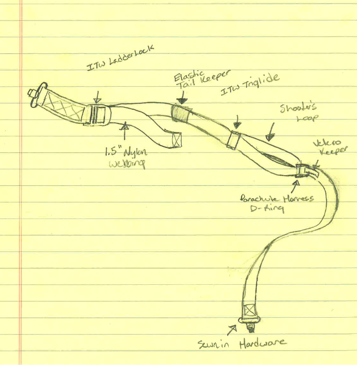

This is what I'd like to make, a blend of features from other slings I've used like the Armageddon Gear, TIS, and TAB Gear Slings.
Made from the same nylon material but with a little more length on the front end than an AG PRS sling but without the quick release buckle and an elastic keeper to help keep the tail in check like on the loophole slings. The loop wouldn't be free running, it'd be run through a triglide like on the TIS and TAB Gear slings so the loop will hold if you need to move around some. Instead of a simple loop to connect the backend there's a parachute d-ring so you can clip the sling to your belt if you want to use it with a tripod, that's why the front end has some extra length to it and there's a velcro keeper like on a rigger's belt to keep it from banging around. The back end is slick so that it rides over the back and around the neck clean if you want to use it in a hasty fashion.

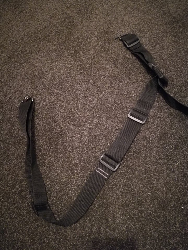

I've never actually bought a sling, I've ended up making my own.
I've tried a few different styles and layouts and have ended up with one much like the Armageddon PRS sling, minus the arm cuff.
I don't like using arm cuffs, it's to easy to get muddled and get caught in it or have it way too tight and have difficulty releasing tension, I've also found that having tension right around your back is more stable than the arm cuff.
My slings don't have a bungee section but I think this is a must have, it means you can get a nicely tensioned position without the risk of ending up too short and having movement hindered.
I also think that slings need to be 1.5" wide as I find it less likely to twist as well as digs in around your back/arm pit less.
It does pose a slight issue in that most sling swivels are 1" but I've got mine working with no issues.
Reactions: Ravenworks
Here's the sling I use;
The triglide above the two silver stitch lines should really be a D-ring but it works as it is.
The other 3 triglides allow all sections of the sling can be individually adjusted.
I like having the buckle as the tensioning method, it's the easiest section to access if you do find yourself needing to 'escape' from the sling.
I see using the shooter's loop as a deliberate thing to use when you have the time to get into it and get adjusted but that being said, with practice they can be quick to get in and out of. I don't understand what there is to get muddled and caught up in because this isn't something I've experienced myself. I generally know what adjustment feels right for sitting and kneeling and get right into those positions.
If time is a factor then across the back can be very stable and effective but for me not quite as stable as using a loop. I do agree that the bungee section of slings like the Rifles Only and AG slings give it a lot of flexibility in the adjustments, especially if you have to make a quick snap shot and only have time to bring the gun up. I've done this at carbine matches shooting a plate rack offhand, I'll tension the sling up to give me some stability. Also agree on the 1.5" webbing as being a requirement for precision rifles, I've used thinner slings and it's a night and day difference when it comes to function and comfort.

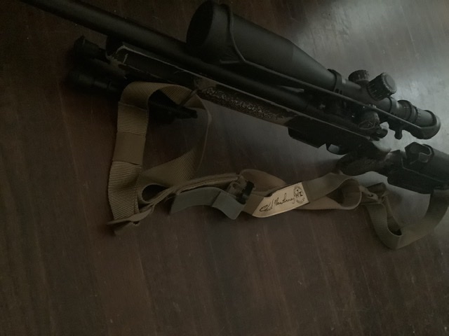

I had one like this made and liked it so much I had him make me another one except with padding.
The way he did the padding was he used paracord and weaved it.
I absolutely love the 2nd one best if you're looking at a long day in the feild humping
He can make anything you want made and he's a veteran to boot.

Yeah sewed it myself.
Have industrial machines at work, this was supposed to be a prototype hence it's a little roughly finished but I've been using it for 2-3 years now and it's holding up great
I know what you mean about the buckle laying on your hand, that's why I allowed the front sections to be fully adjustable length, also I like being able to change between sling swivels and qd mounts.
I initially made my own design just so I could determine what features and layouts I liked as there were so many different options.
I'd enquired with Armageddon about making modifications to their existing designs and they were happy to do anything I wanted, but I ended up just using my prototype one.
I imagine most companies could do a custom build as it's not difficult to sew up.
