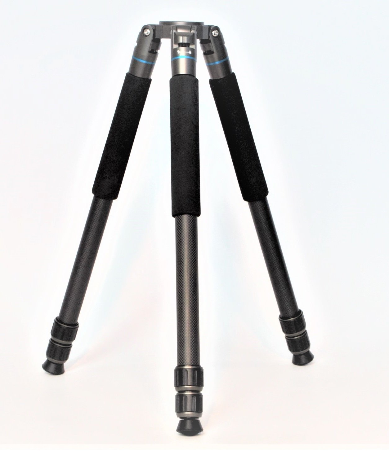

    Colorado Tripod company has been working on a designated shooting tripod and ball head for a little while now. Should be coming out soon. $1k for the combo.
    I want a tripod but I’m doing my best to not give money to China, so I’ll save up for a nice American made product.

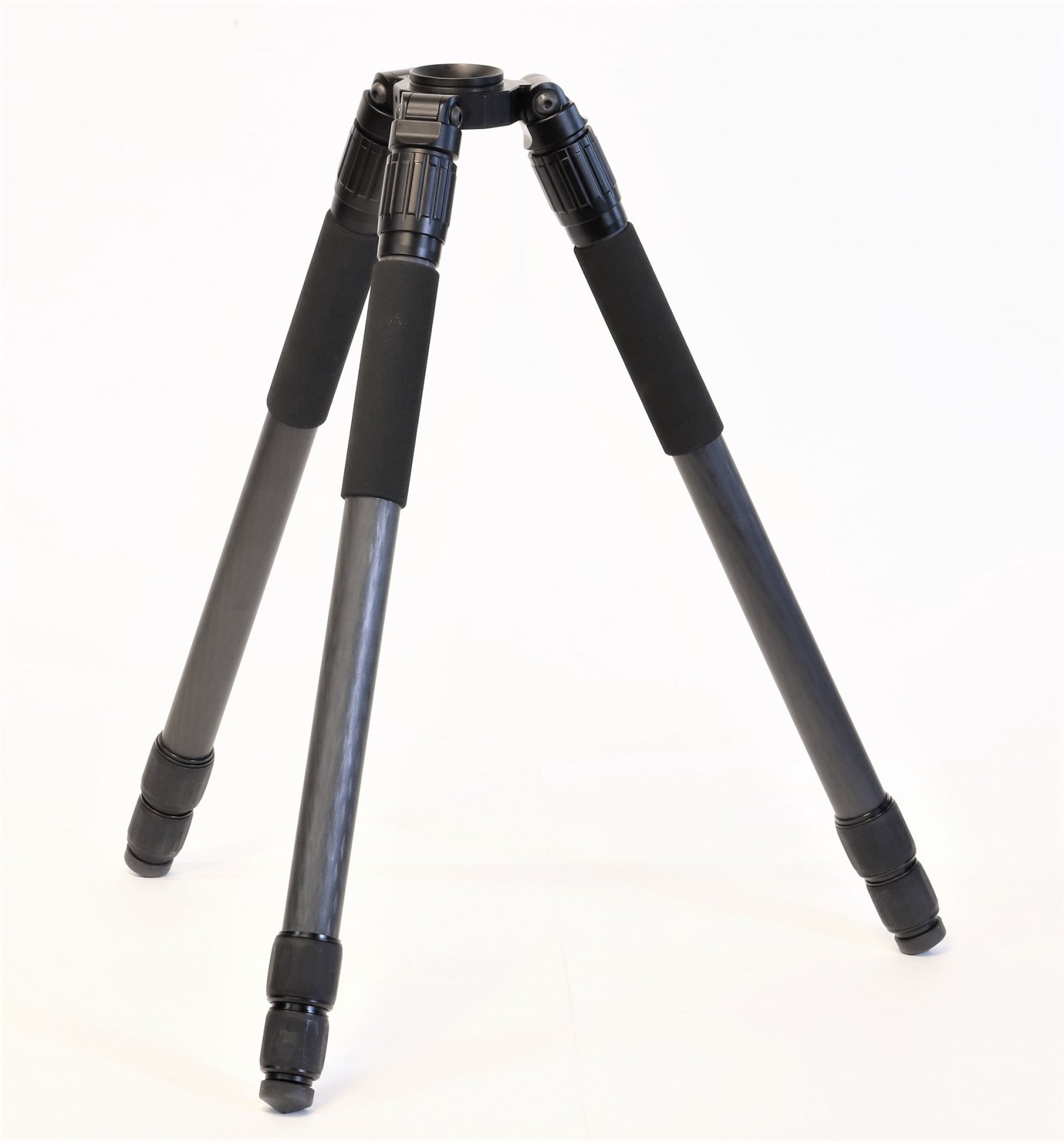

    Here is the Field Optics Research 75mm bowl tripod, 95lb., 32mm 8 layer CF legs, 54" but 65 with extensions. $339 (good bit 14
    less through Doug). I think it was around $400 for this, a handle and a pic mount (they sell the same bundle for $519). All sorts of accessories including spikes and spreaders for the feet. It is made in USA too.
    I ask again, why should I pay more for the RRS if this one is hitting all the numbers for less? I ask this not to bait you into an argument, I really wanna know. Or is the difference between RRS and FOR more along the lines of Korth and Smith/Wesson? Nicer but not necessarily better?
    I looked at that Innorel 90. I think I'd rather invest in something Doug backs, that thing may be nice for a China pod but it eerily reminds me of the $20 walmart one I got to support a cheap chronograph. It was looking at that one that prompted me to reach out to Doug.
    Now I don't doubt there are better mounts and I'd like to discuss those but for now that cheap pic mount will accommodate pretty much everything but that DTA HTI, and maybe even that too although I doubt it'd be ideal.

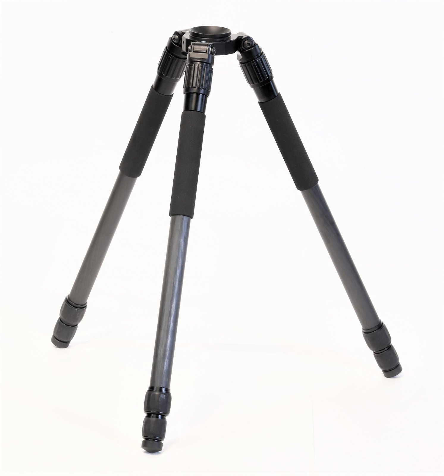

    1/4 the price? I just bought a 34L for $1200 including taxes and shipping, the Anvil30 directly attaches and was many have stated not close to comparable, weight, quality, made in the usa. You got your Chinese knockoff with plates and adapters for$300?
    I purchased a BH-55 head ( DO NOT SKIMP ON THE HEAD) and a Hog Saddle tripod ONLY because i couldn't swing a RRS. Its an alright tripod but, its a pain in the ass to adjust the legs, dont like the rubber under the head and a couple other little things. But for 160 i knew what it was and for the dollars good deal. But it is not comparable to RRS. If you can afford the RRS set up, purchase and dont look back.

    Well, if it comes down to the Innorel or the RRS then I guess I'm gonna go with the Field Optics Research stuff. I trust Doug and the specs on that look on par with these others. The fact they focus on shooting helps.
    So I just called FOR and they're not far from RRS in fact. Four miles? He had nothing bad to say about RRS but obviously has his own business and feels his are priced better (that's hard to argue against). The one I'm interested in IS made in China, but it was prototyped here and subbed out there because of cost of carbon fiber. I guess they could make it here but it wouldn't be cost efficient vs. those other ones? That's just my guess.
    They do make their own here, two of 'em, started two years ago and they're monsters, the big one supports 145lbs. and both of 'em have locking leg hubs so probably the most stable, period, end of story on that respect. But they all seem suitable with respect to strength and stability, on paper, and I guess once you go over a certain point it's all overbuilt and only extra weight is gonna make a difference.
    I guess I'm shocked that these aren't talked about more on here given what I've learned so far, yet the Innorel is? I wouldn't know about 'em either were it not for Doug.
    Made in US, $7xx
    Made in US, $9xx:
    Made in China, $3xx, also the lightest option with greatest strength for having to carry into the sticks, and weight has already become a problem with gear:
    Now it's obvious the ones made in US are better but he said there's video of USMC firing a Barret from it and the front legs lift up a bit but the shooter wasn't managing recoil properly and it wasn't anchored or holding weight underneath. So it'll manage the BMG. It's not like that's what I'm getting it for, I just wanna be able to do that once in a while when I do get that thing out. I think for mainly 7.62 and semis that this will do me good. He said the bowl is smooth and can be made smoother with the addition of some graphite. Didn't try to sell me off on stuff, bullshit me or dog the competition and I appreciate that.
    Those two made in US versions are super nice and seeing 'em side by side it shows... I wish I could swing it but I'm not so sure I could get my money's worth out of $7xx worth of tripod. And I can always sell it or the Sirui off and use it for the spotter setup.
    Thanks everyone for the advice and information, it did help me come to a decision.

    Different apple the 34 matches up specs wise way better than the 44 which is a foot taller, and higher load capacity and no need for an adapter to mount a anvil 30 to the top.
    This is your apple https://soar.reallyrightstuff.com/TVC-34L-Mk2-TFC-34L-Mk2-Tripods_SOAR
    Reactions: Jefe's Dope
    Thanks!
    I bought the Field Optics Research Tripod because I didn't want to wait forever on the Innorel to come from China. I shot off the Field Optics Tripod yesterday and was very pleased with it
    Thanks, how'd it do? Stability? Did it jump or lift up? What'd you shoot from it? I guess I'll take as much detail as you mind giving. Any bitches or little issues you'd rather been another way? Regrets?
    I have a Tikka T3X Tac A1 in 6.5 Creedmoor...with scope and other equipment I had on it it's about 16 pounds. Started out around 350 yards and had a good (roughly MOA to sub MOA 5 shot group...with cheap Sellier and Bellot ammo. I was shooting at a buddies farm off of uneven ground. When my fundamentals were right the tripod was pretty stable and I was able to see rounds hit the target through the scope. A few times I was right with gripping the tripod and I had a little bit of jump...nothing major. I was very pleased with it. In all fairness I've never shot off of a RRS tripod that is so popular around here...but for my purposes (fun at the farm, range, and hunting) the Field Optics is great.
    Also I only shot standing with the tripod, I didnt get an opportunity to shoot sitting or prone...hoping to do so soon. I am by no means a competition shooter so I was very pleased with no regrets for the money. I just can't justify $1k like some others can for a RRS.
    This is your apple https:///TVC-34L-Mk2-TFC-34L-Mk2-Tripods_SOAR
    I was comparing weight, tube diameter, sections, and apex type. I think the 2lbs., 90 vs. 88 is closer than the 80 for the 34. IMO, in use, my comparison is closer spec wise. The overall weight of the tripod makes a HUGE difference in stability. Overall weight is nearly identical for the 44 and Innorel.
    I still think the 34L is a better compare at the same deployed height would be stronger at less weight, right?
