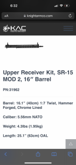

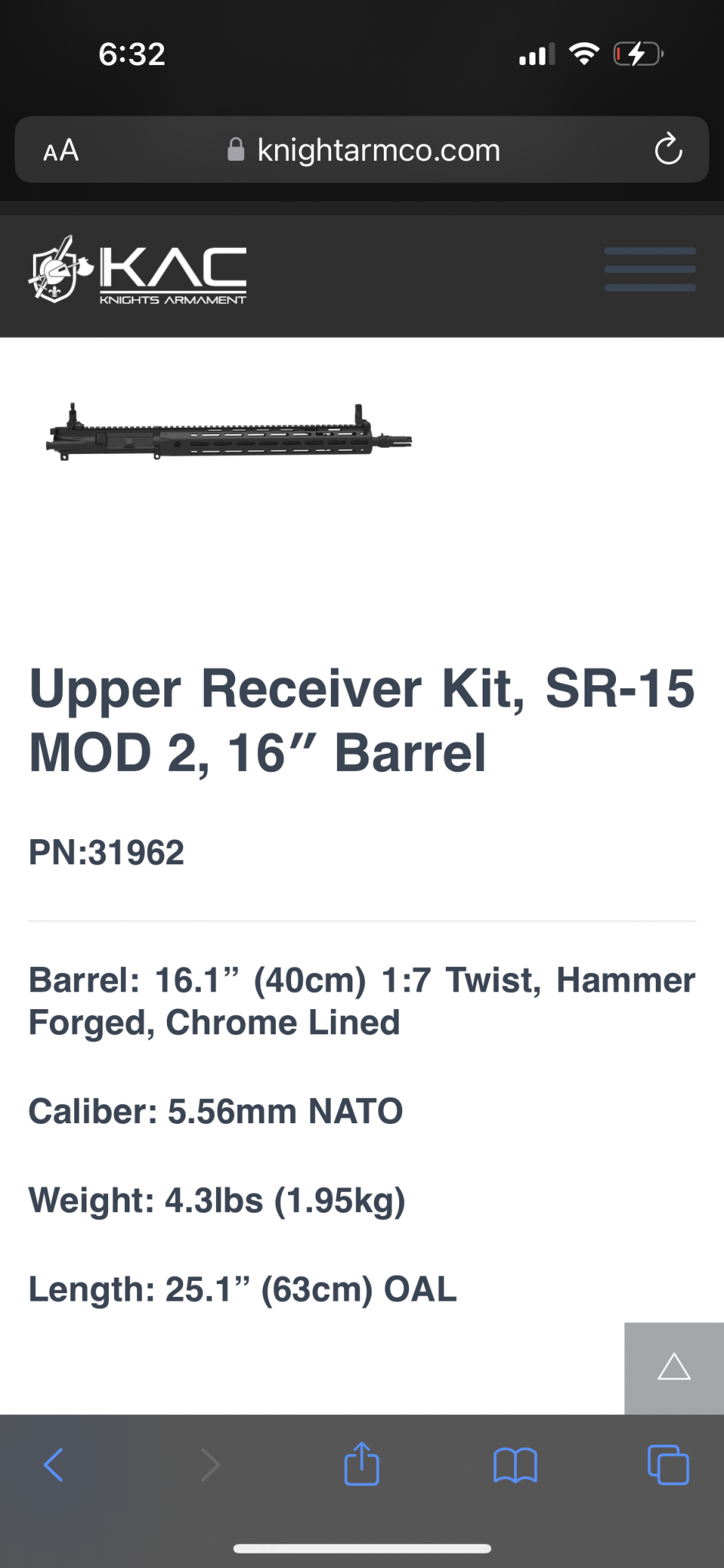

Its a cut rifled barrel. Its an accurate rifle that works better than hammer forged, but the only thing hammer forged can do better is this test- hip fired full auto till the gun blows up.
Negative. The only cut rifle barrels they sell are on the LPR and precision SR-25's. Cold Hammer Forged.
